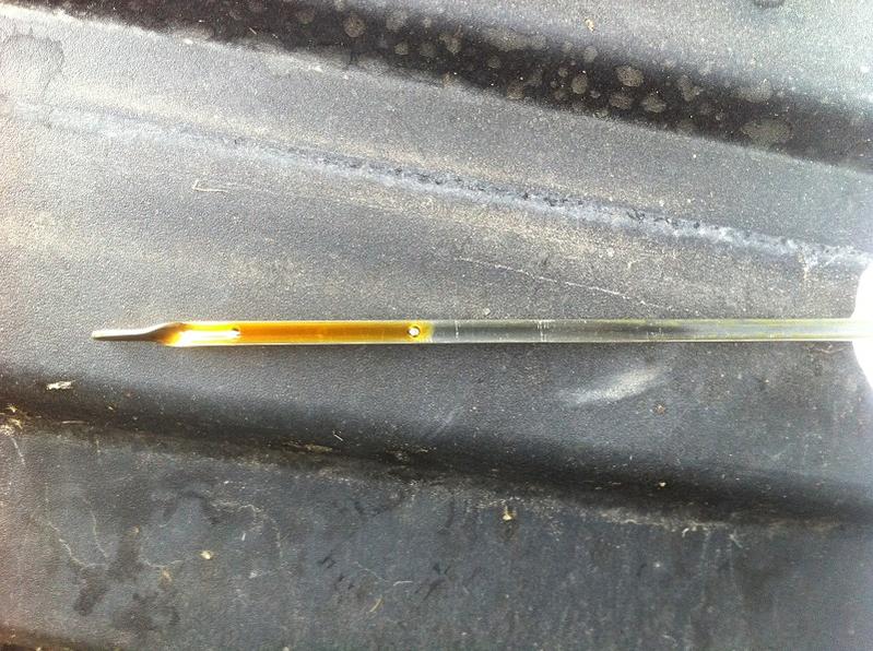

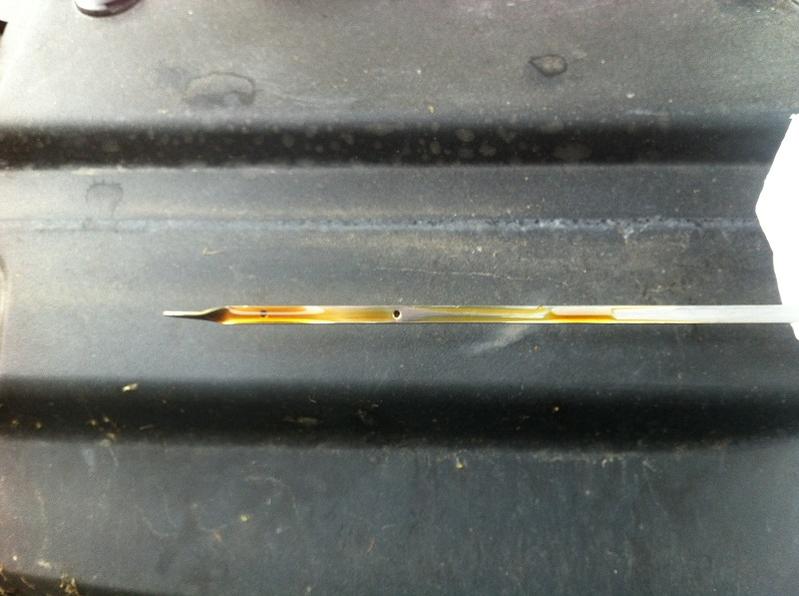

Q2: When I pull the oil dipstick to check the level, I can't see the borderline at all. The oil is all over the place, maybe up to +1" above the "max" mark hole and the dipstick does not look soaked in the oil. Some areas will be covered, others won't... :-/ Do you have the same issue?

When you pull the dipstick out it's curved. On the convex side the oil is often smeared in a way that makes it look too full, but the concave side usually shows a good, clean mark. Are you trying to read only one side?

The second question is a little easier. When you check the oil of a vehicle (this is general rule of thumb, some cars are in fact different) Run the vehicle for a couple seconds, turn it off. Pull the dipstick out, wipe it down, wait about 10~20seconds (to let oil splash settle a little,) then put the dipstick all the way in and pull it out. What you are looking for is the longest continious band of oil sheen on the dipstick. i.e. no spotty coverage, but completely covered. This will give you the general location of the oil level. You want it somewhere between middle and Max.

Thanks for the tip, I will try this method too. Looking at the pictures taken today (posted below), it looks like the rule works =) However, I remember that I had spotty areas even below the "max" mark. But I don't remember if the engine was warm.

Regarding the oil reading - check my pictures below!
JB - thanks a lot for the tip! Here are some pictures of today's oil check!
Dipstick - side A:
Dipstick - side B:
Your tip worked like a charm!
Also, I can see what BlackWorksInc meant by "longest continuous oil band". In the first pic it stops right at max mark!

The oil left clinging to the insides of the engine would probably amount to something like 2-3 tablespoons if you theoretically could collect it, so its negligible. You don't have to warm up the engine completely, the reason I said to run the engine for a few seconds is to actually fill up all the oil galleys and such as the oil level is more accurate that way (at least this is how I was taught and my mother's father was taught and most any other mechanic I know...) I don't know how much different the oil is when all the galleys are filled up vs. not primed, so I can't really answer that. Also just waiting something like 10-20 seconds is enough to get most of the splash to drip down and not cause so much spottiness on the dipstick.
You're spot on, in Picture A you can see where the oil has splashed/scraped a bit on the dipstick making it inaccurate/spotty, but flip it to side B and you can see it matches up pretty well with the Max line. :)
