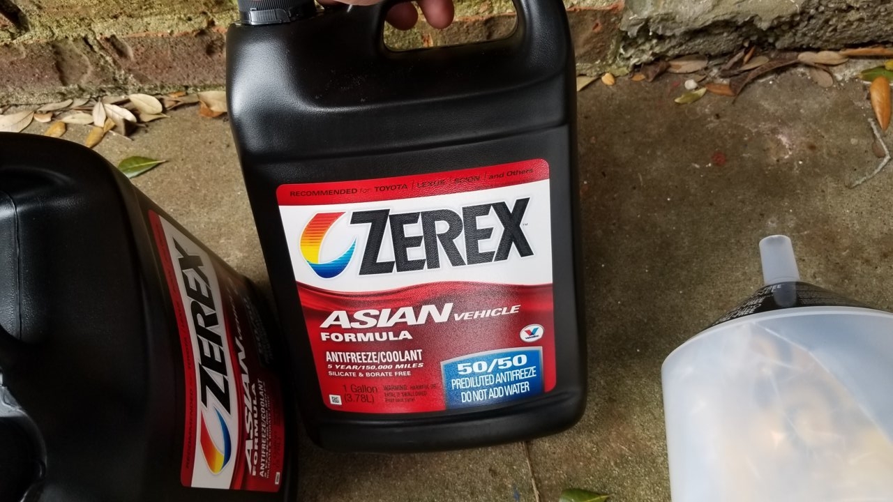

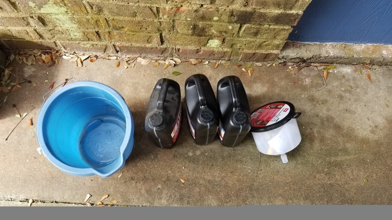

Picked up 3 gallons of anti-freeze, a radiator funnel perfect for the task, a bucket, and a few gallons of DISTILLED water.
Some people only do Toyota Red, I really don't care as long as it is Red.

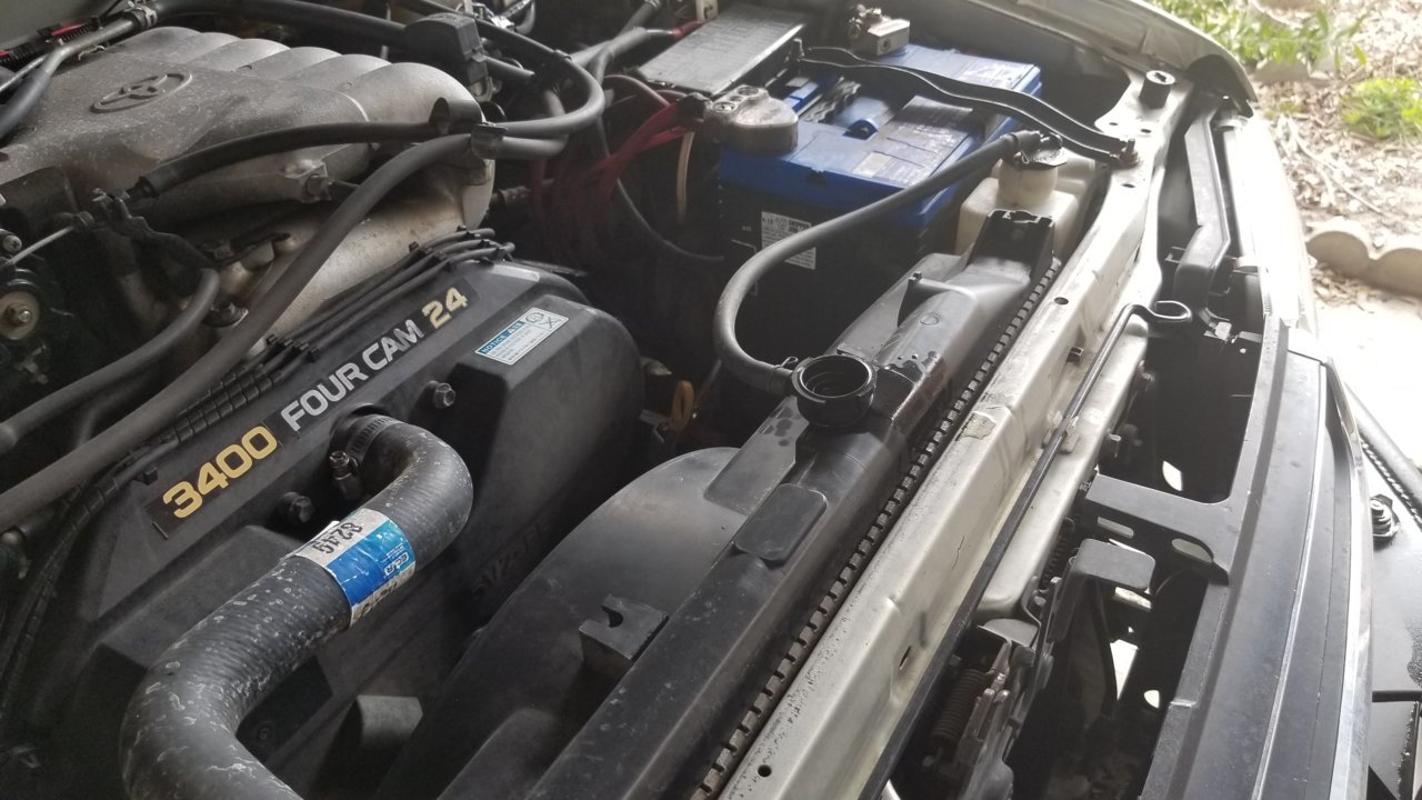

Pop the radiator cap off:

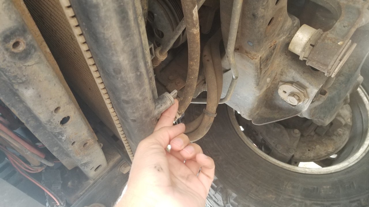

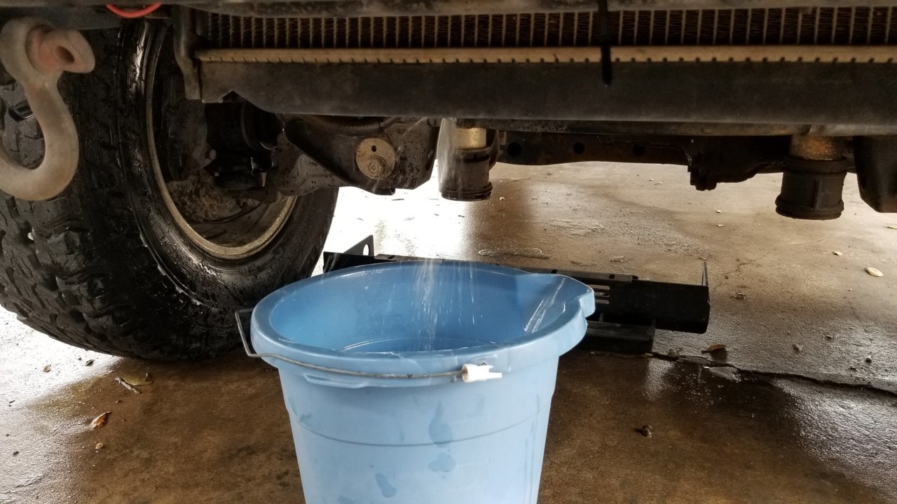

Remove any skid plates in the way and locate the drain plug at the bottom of the radiator. Keep in mind that the drain plug will back out all the way if turned out enough.

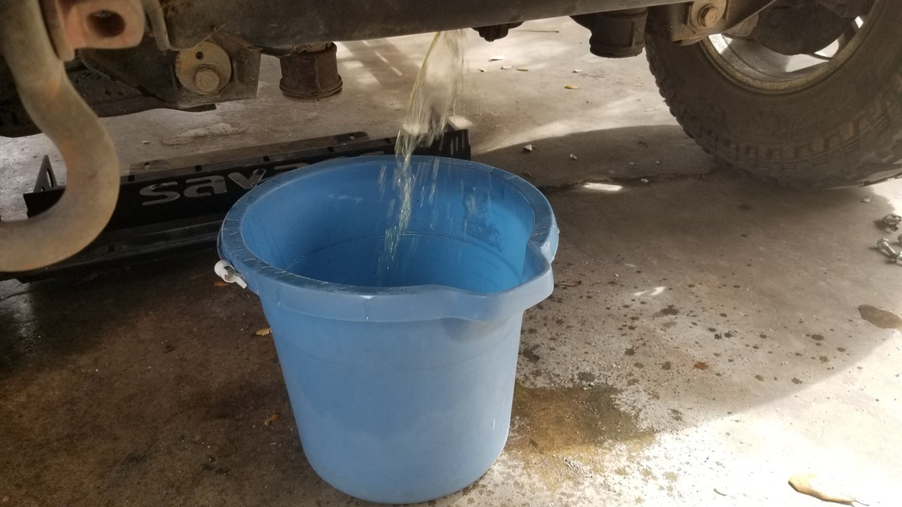

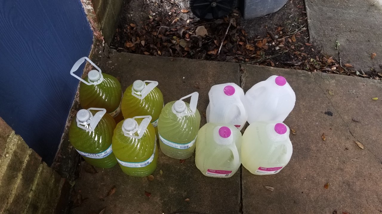

Drain the coolant. Yes, it was green. That's the reason I decided to convert to red.
If you have any pets, make sure that they stay away from the vehicle. The radiator fluid smells/tastes sweet to them and if they drink it, they die.
If any of it spills, immediately rinse it away.

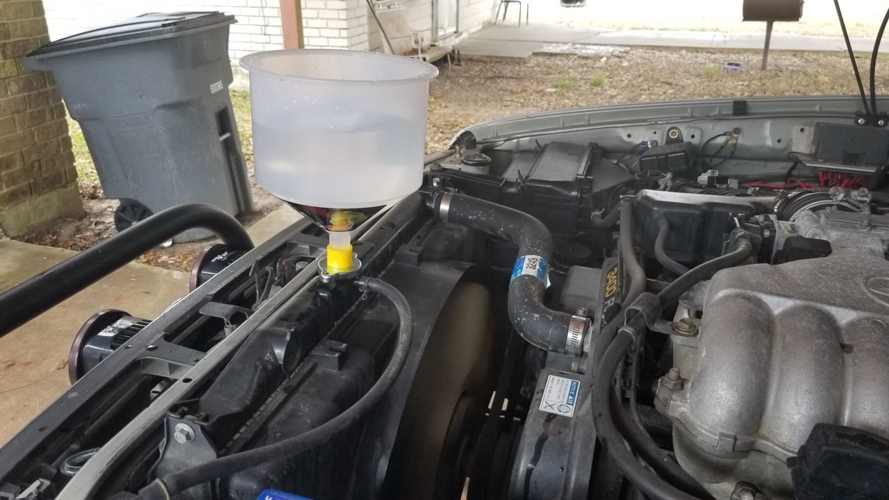

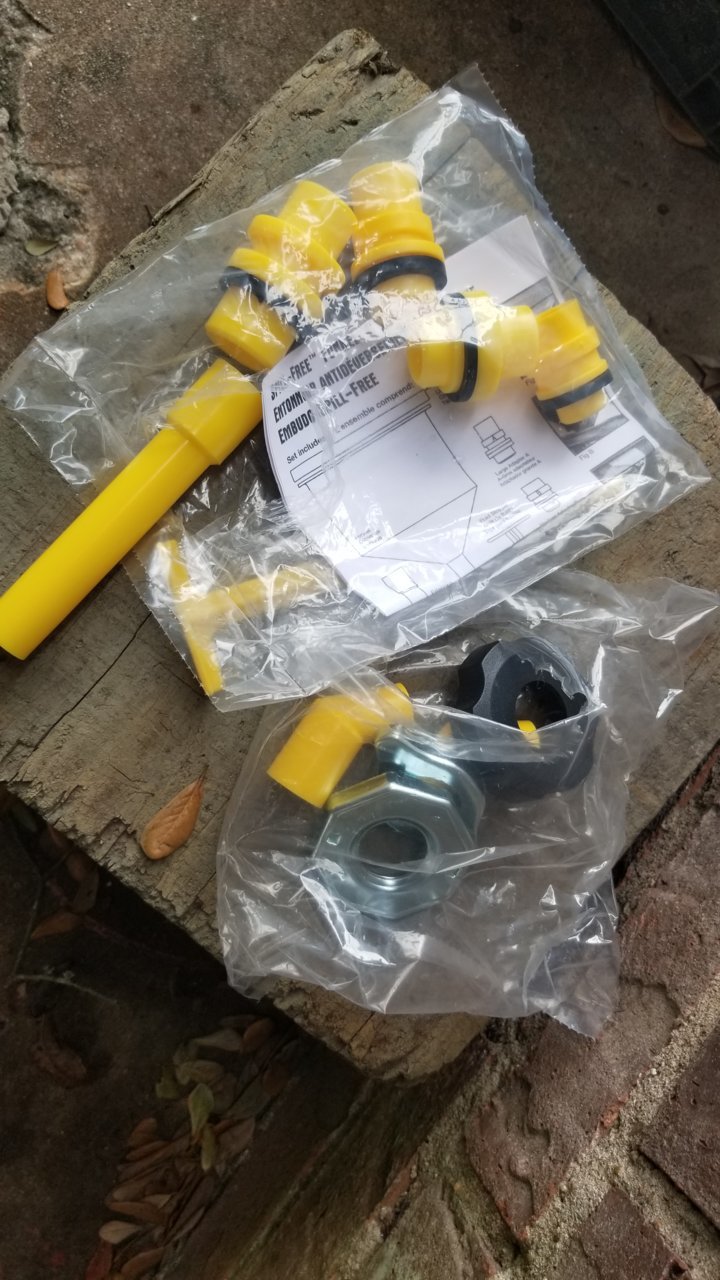

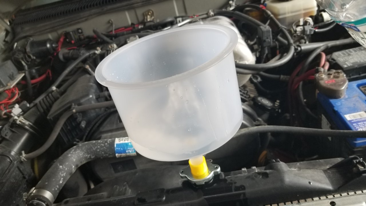

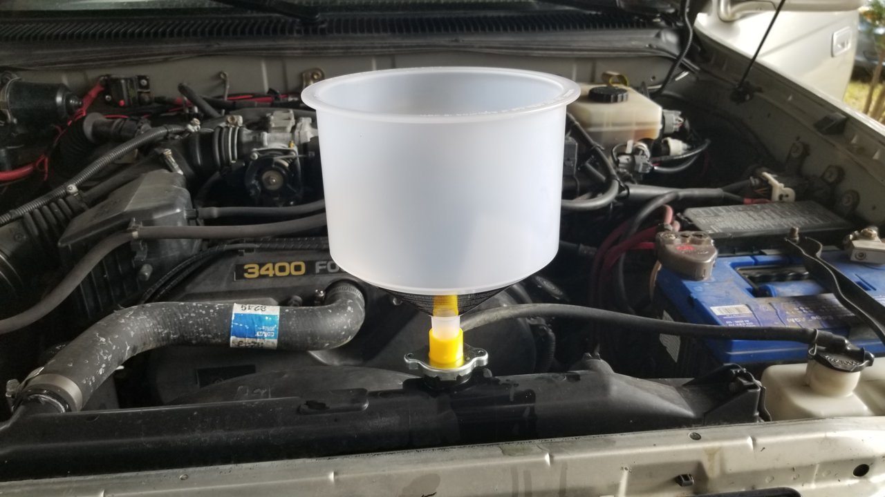

Remember the specialty funnel?
This comes with various adapters for the radiator cap, locate the one that fits and put the funnel together. This is pretty much straight-forward:
Once the radiator has been drained, close the drain plug. Clean up any mess and scare off any wandering pets.

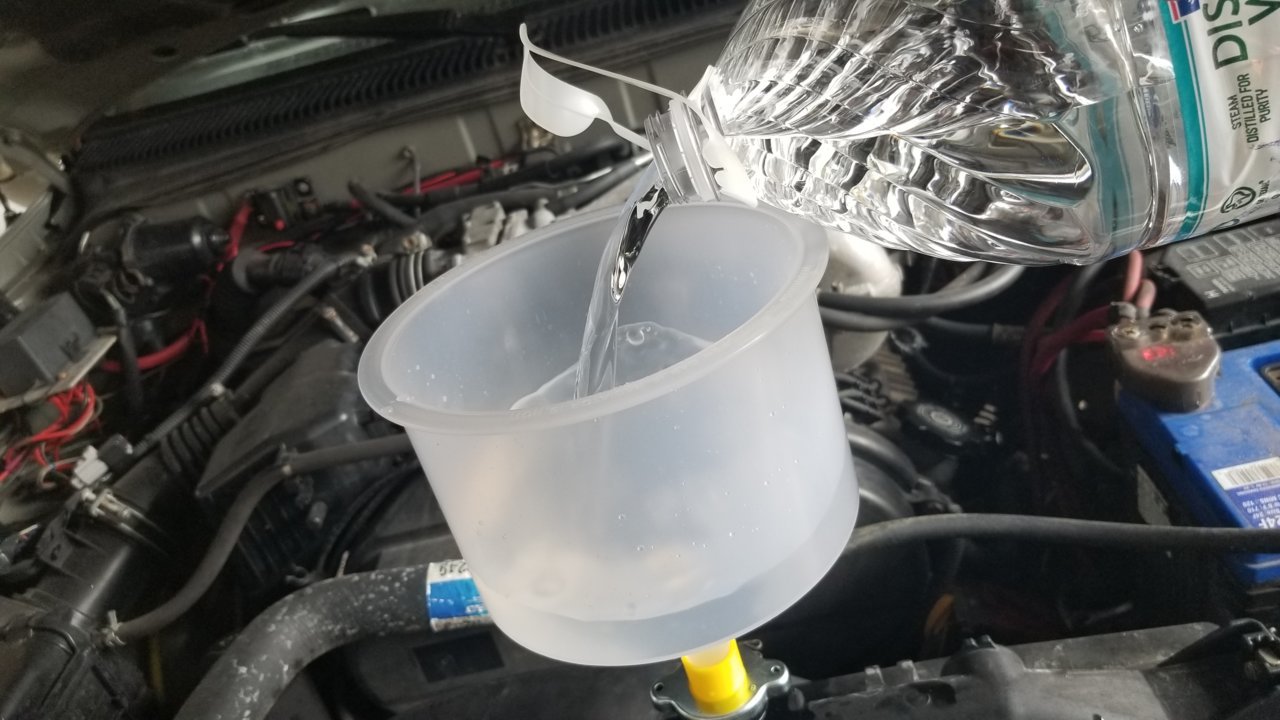

Fill up the radiator with distilled water:
You'll see some gurgling action as the water funnels into the radiator:

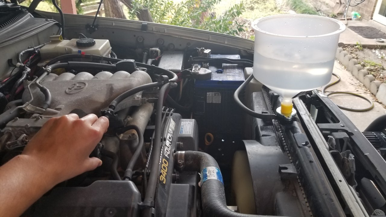

Once the radiator is "full", add more water until the funnel is about 3/4 full and turn on the vehicle:

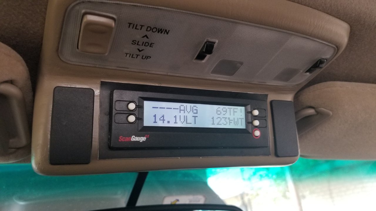

Ensure the AC/heater is off and watch the temperature climb, on the gauge pictured - 123*
As the water pump cycles, you will see bubbles rising thru the water in the funnel and the water level start to drop. This is good. All air bubbles must be out. It might help a little to give the engine a bit gas..
Keep an eye on the water level, if it gets down too low, add more.

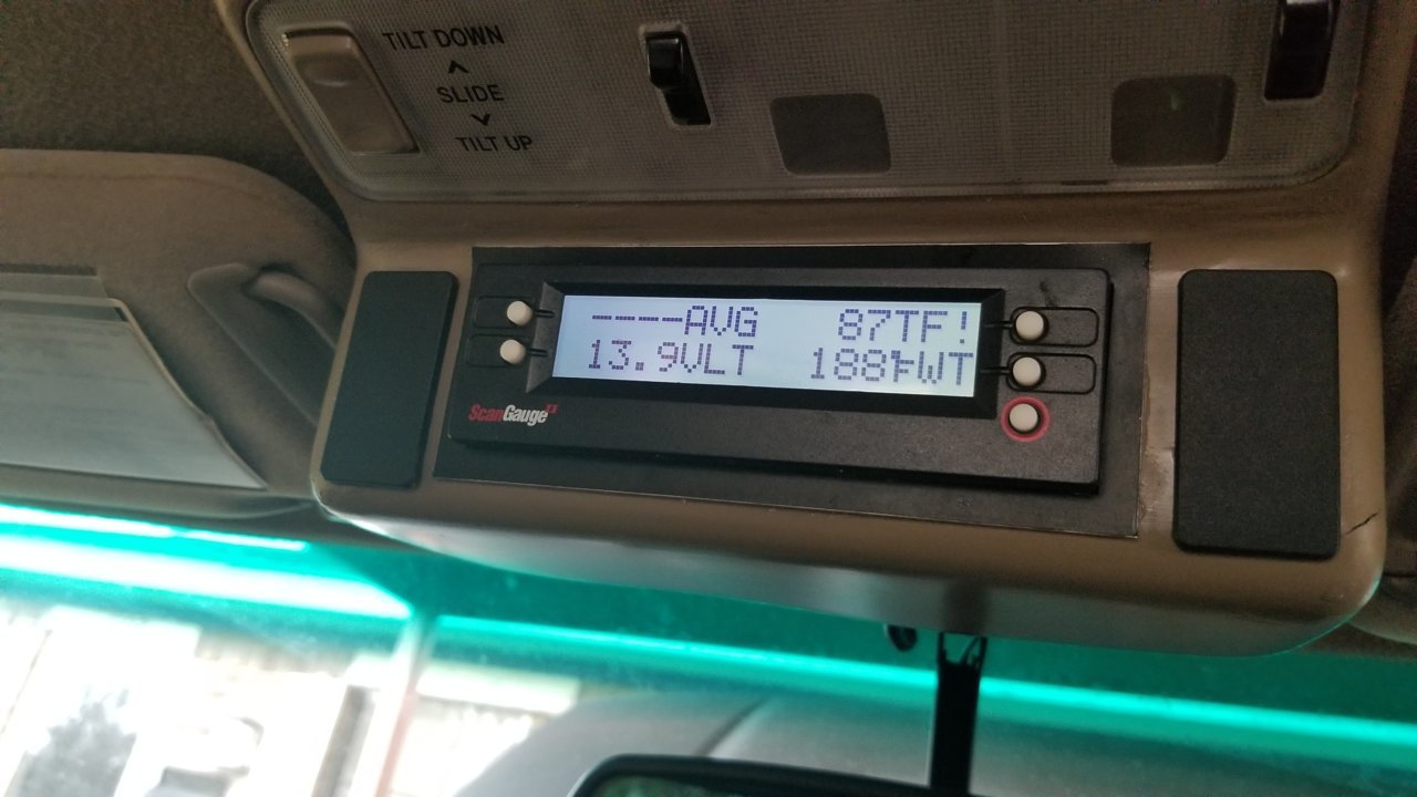

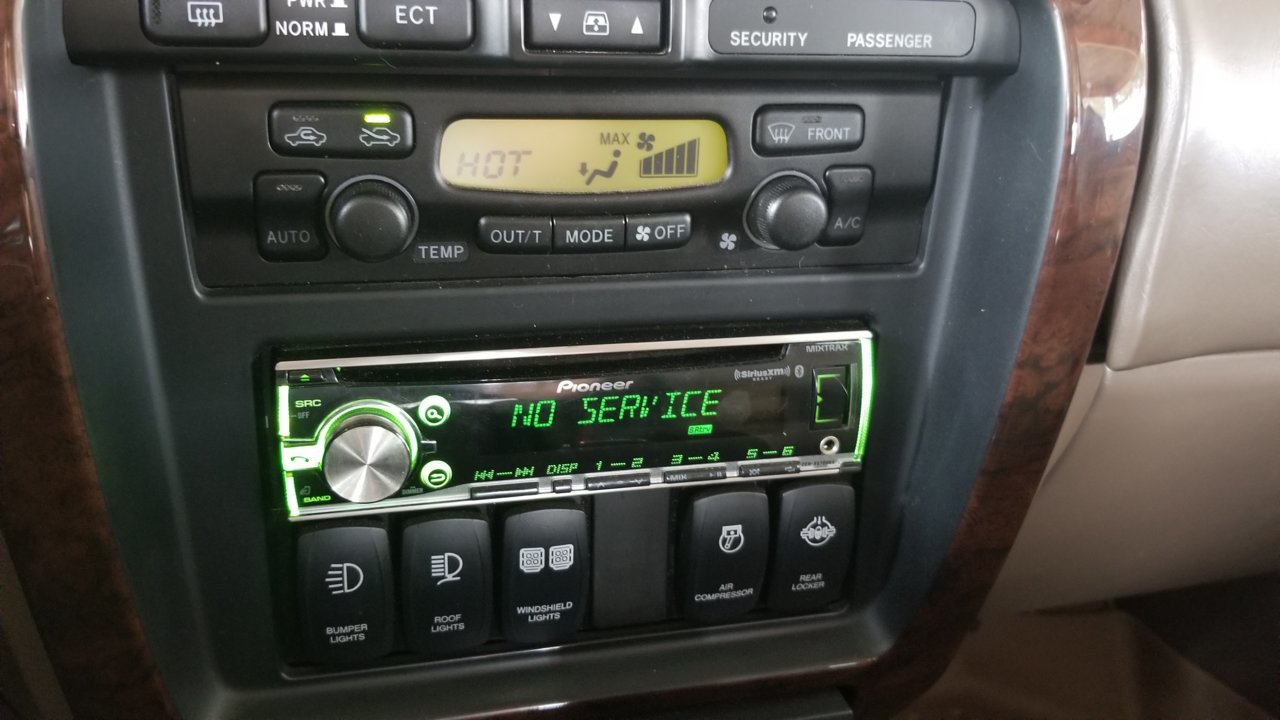

Once the engine starts warming up to about 190*ish..
Crank the heater to max, this ensures that the distilled water flushes thru the system.

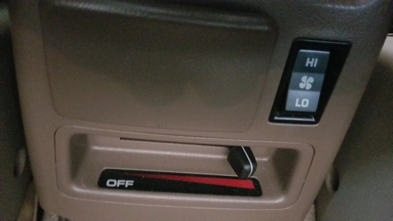

If you have a rear heater, crank this up to max as well.
Leave the engine running with heater full blast for a good 15 - 20 minutes, sometimes longer. It all depends if you no longer see air bubbles come up at the funnel.

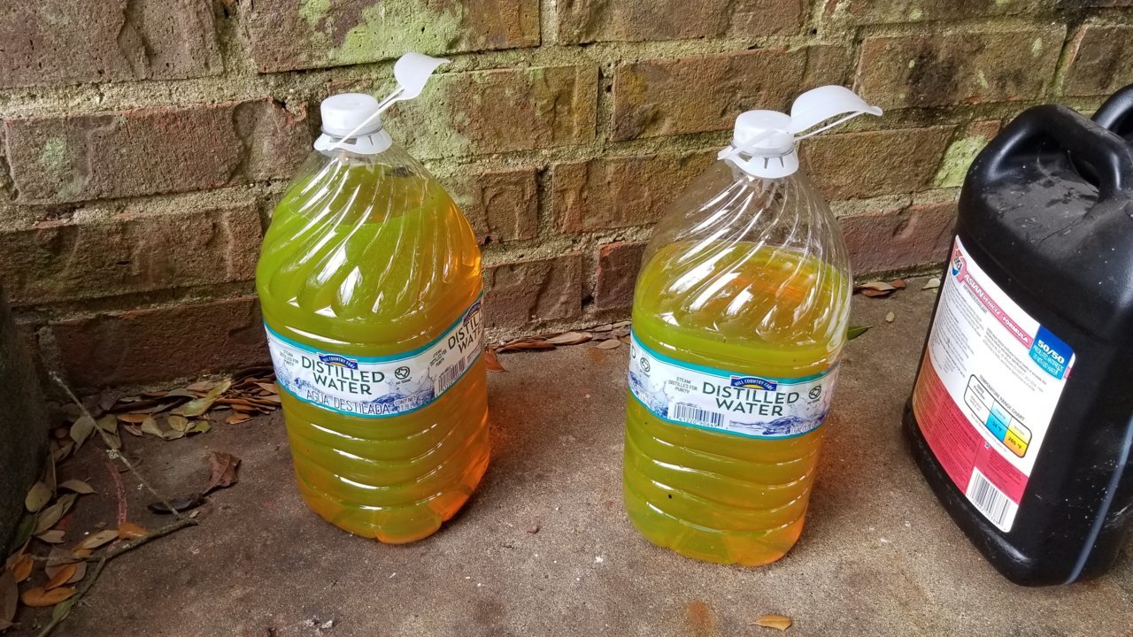

Depending on how clean you want your coolant system, you may want to repeat this cycle 2 or 3 times. Since I wanted to make sure I removed as much green coolant as possible, I did 4 cycles.
You will notice the water/coolant come out cleaner and cleaner after each cycle. It will be your call to determine when you are "satisfied"

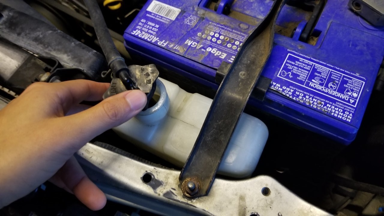

Don't forget to drain your reservoir!

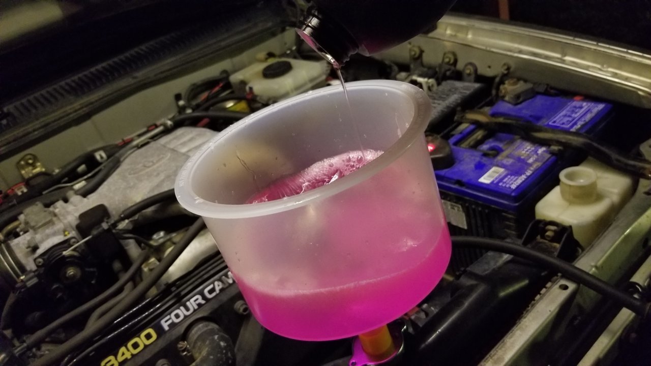

Once you are satisfied with the flushing of the radiator, do the final cycle:
1. Add red coolant until the radiator is full.
2. Once full, fill the funnel until it is about 1/2 full.
3. Start the truck and burp it to remove all the air bubbles as instructed above.
Once all the air bubbles are out, fill the reservoir to the cold/max level and you are good to go.

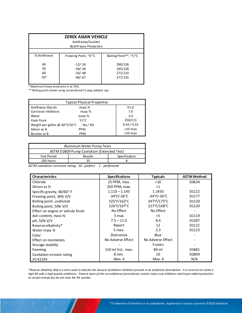

I've been reading several forums regarding the 50/50 mix being the number to obtain. I'm planning to use Zerex 50/50 mix. They don't have a 100% concentrate to add for the remaining water left behind after a flush.
Please let me know what you think about the following information and verify my math.
Total coolant amount = 9.5 quarts.
Water flushed out = 8 quarts.
Water remaining = 1.5.
Add 8 quarts of 50/50 coolant = 4 qt. concentrate/4 qt. water.
4 qt. coolant divided by 9.5 qt. = 42% coolant.
5.5 qt. water divided by 9.5 qt. = 58% coolant.
Now, I understand that this isn't a 50/50 mix, but as per Valvoline coolant chart, this is a acceptable percentage.
Do you agree?
Thank you.

Hey Luis, you'll be fine. As long as you don't live or visit an area with sub-zero temperatures, you'll be golden. The next time you renew your coolant, a full flush isn't necessary. Just do a drain and refill of the radiator. Full flushes are for people who have either let their coolant get in really bad shape or you are switching from one brand of coolant to another and you need to fully flush out the other brand first.
