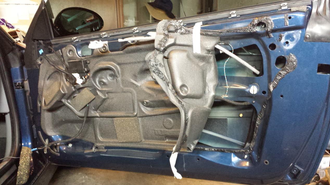

Haven't changed out the handles on a Toyota T4R before but on my 2003 BMW E46 M3. I had both my door lock actuators fail. In the process of installing the new actuators I fiddled around with the external handles and eventually took the whole assemblies off to clean the area(years of dirt and excess wax residue that get in there). Quite easy for a BMW, so I am positive it would be a lot more simple for a Toyota.
What I recall:
Remove door panel. It's a bunch of screws and tabs you will need to pop out. Remove airbag unit(not sure if you need to do for a Toyota, wasn't necessary for the M3 but I wanted more room). Remove foam door liner. Slide retention clips that hold the handle, then the assembly should slide out. Install new handle. It's pretty straight forward. Once you have the door panel off just start taking off the screws/bolts that will give you access to the handle and work from there. Way easier than doing the actual door lock actuator because you run the risk of dropping your window and shattering it if you're not careful! But it shouldn't take an hour per door for this job.

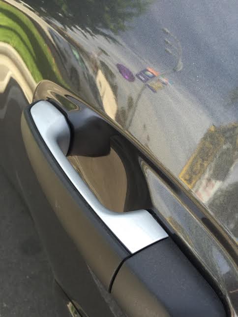

[MENTION=108420]EasyAndy[/MENTION] Thanks for the reply and link. I've already dipped all the chrome on my like the guy in the link. My issue are the door handles.
Since you have physically touch the handles daily the inside where your hands slides in and out when opening pealed off. You simply can't give the dip enough time to dry properly since you have no choice in touching the handles.
So my goal is only have the door handles match the paint on the car. See pic attached of my current state of door handle. Total bummer! Now I have three colors going on. Magnetic grey, black and light grey.

oooh nice, you found a solution to one problem I had with my truck: the chrome door handles. This seems like the best one so far for our touch sensitive handles.

might want to pick up a single handle and do a quick DIY paint job with a few layers of color and a few clears. Then swap over the electronics/sensors (if possible) to see if it still works on the truck after multiple layers of paint are added.
I'd hate to see you have 4 handles painted professionally only to find out it somehow interferes with the sensors.
