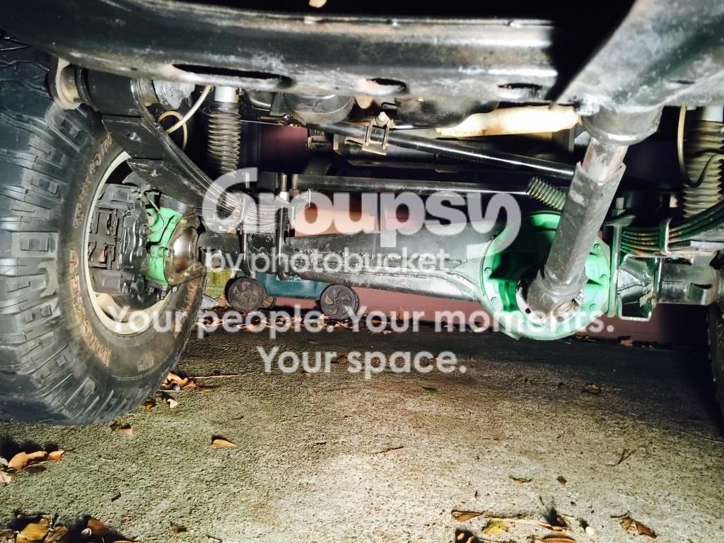

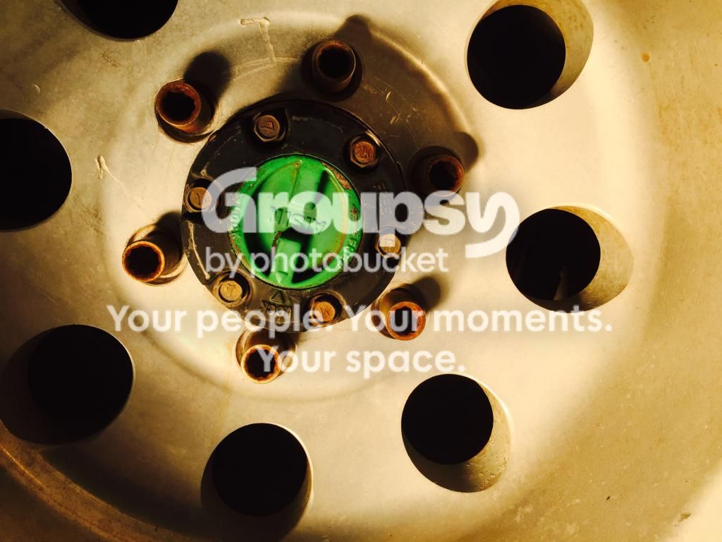

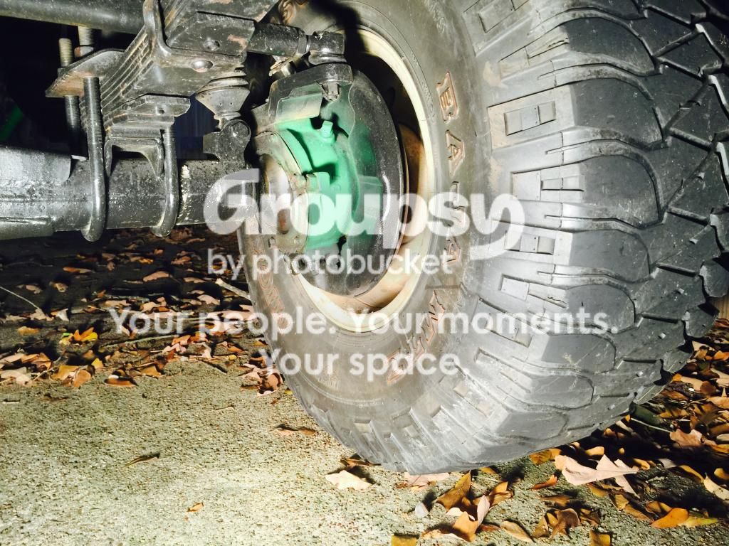

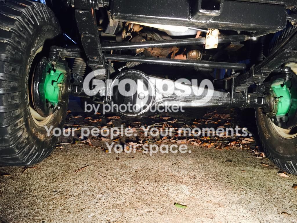

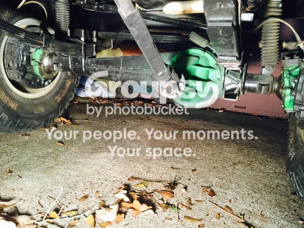

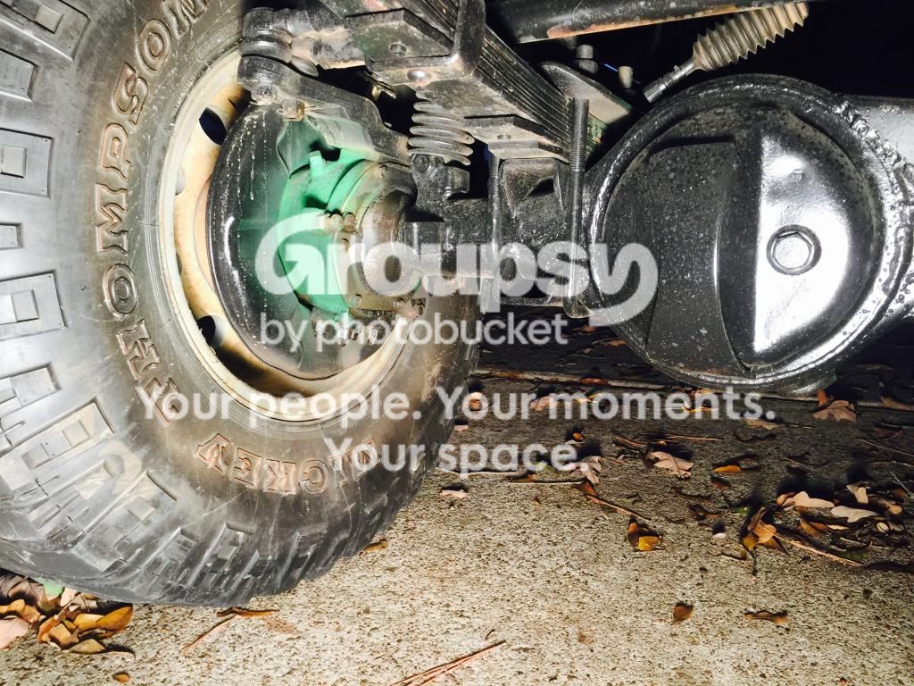

Here are some pics of what I am dealing with. I'm also going to reach at to the original owner and see if it's a welded axle.
sound like its got some type of locker...
based on that front driveline, I would guess its welded.
you definitely don't want to drive around with the hubs locked, regardless of Tcase position. at least not on dry ground.
Thats something I was curious about, would it turn better or at all in mud or sand.
Ok, I just heard back from the original owner. He said it has a full spool in the differential and that if i want to drive around in 4wd, i can leave one hub unlocked.
With a spool in the front diff, it'll turn worse on slippery surfaces like sand or mud. It'll be easier to turn the wheel, but the truck will "push" and not want to turn. What do you have for a locker in the rear? If it's open, I'd swap the thirds and put the spool in back.
