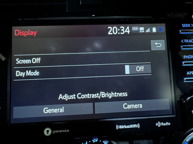

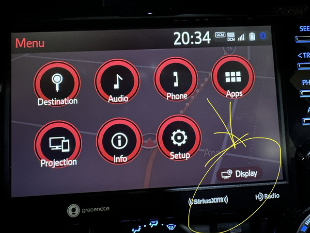

The brightness can be further adjusted through the onscreen menu separate from the instrument cluster brightness dial. It wasn’t where I expected though.
On my 2021, Press physical Menu button, tap Display in lower right corner and you’ll have the display controls. Images below.
