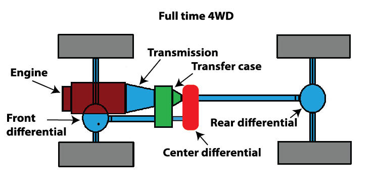

so what do I have to do to change gearing? so is that in the transmission I need gears? who makes options for that? I know im impressed with ARB stuff so the locking differentials, twin compressor, and diff breathers will come from.
you may not any upgrades
so what do I have to do to change gearing? so is that in the transmission I need gears? ...
No. Changing the gearing typically refers to changing the differential gear ratios. Your 4runner probably has 3.727 gears. This means that the drive shafts going into the differential will need to do 3.727 revolutions to make the axles (and wheels) complete one revolution. There are two parts to the differential gears, the ring gear and the pinion gear. These need to be replaced as a set. Therefore, to change diff gears you will have to remove both front and rear differentials and then replace the ring and pinion gears in each. You're probably looking at about $500+ for parts and then maybe $1000 in labor. Not cheap, and not something you could do at home without proper tools and experience.
