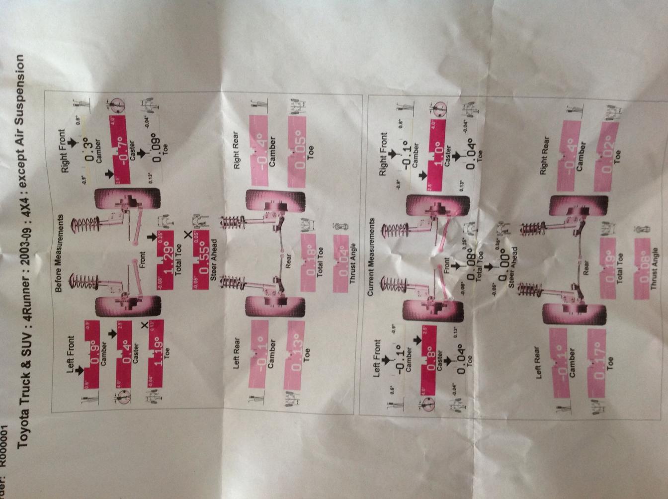

Can someone take a look at these and tell me what you think? Truck pulls to the left.
Beginning specs were out of whack because I replaced the lca and cam bolts.

I'd take it back and question those “current” caster readings,has an ok split but seem way to low for me.

I just want to make sure there no tire wear etc before I buy the tires. If I must live with the pull that's fine. But chewing up $1500 worth of tires isn't.
Lifted with stock UCAs, the caster will be low but I would think you could get a little more out of it. If you don't want or can't go with aftermarket UCAs, you could get the shop to try and raise the left caster and/or lower left camber + raise right side camber just a hair. However, with caster that low, it is going to be a little all over the road.

Increasing castor (LBJ forward) will cause the vehicle to track straighter, and hold a line better. I would highly recommend the UCA's. My 4runner has 2.5 degrees castor and I don't like it. I need the feeling of stability that comes with increased castor. I would think with your readings that the truck would lack stability.
If you take it back to the shop tell them to max castor out first by turning both of the forward cams in and rearward cams out (LBJs forward). Then adjust camber from there, then toe.
