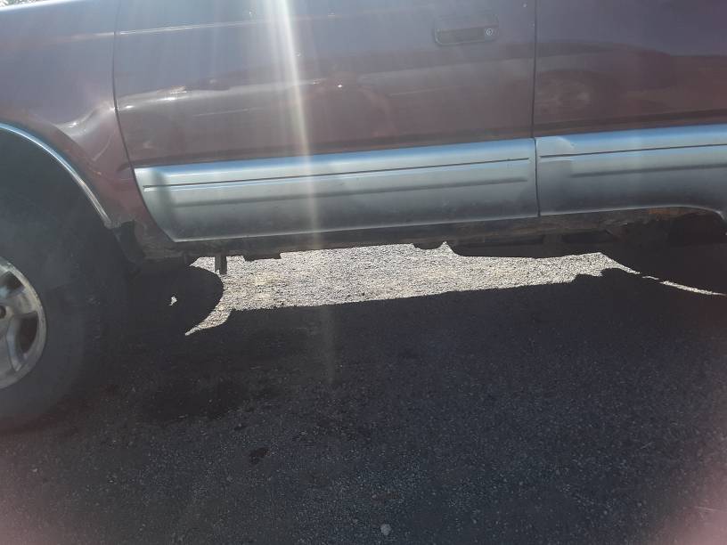

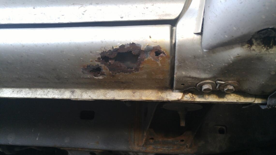

So I noticed what I thought was only surface rust on my front passenger rocker panel. Went to scrape it off.... :ohwell:

Very common. You see bubbles on rockers they are rusted through. A little bondo and touch up paint and it be as good as new. However, to slow it down you need to coat the inside of those rockers with fluid film or something like it to keep it from spreading. The rockers and rear wheel wheels and front corners are very prone to rot..:(

From what I understand, the front sunroof drains go into the cowl and the cowl drains into the rockers. That's why that spot always rusts out. If you want a permanent repair you need to cut out all the rust and weld in new metal.

Not sure about front sunroof drains, I know the back passenger side comes out in the rear inner rocker and the drivers rear side drains into rear vent.

I wondered why water would be in the rockers. My plan at this point is to patch the areas as they go bad. Once it gets beyond patching, I will look at cutting the rockers off and replacing with new steel that could also be used as sliders.
