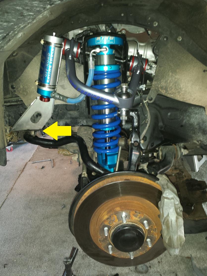

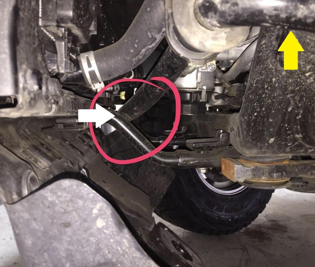

Different brand and I don't think the ICON stage one comes with reservoirs or the brackets, but it's the same result with the spacer blocks. This pic shows where the anti-sway bar (sitting in it's bushing and bracket) needs to be dropped on both sides. Then the end of your ASB will rotate up (2nd pic yellow arrow) to mate with the links, which will rotate the lower portion back and down (2nd pic white arrow) towards the rear of the vehicle giving you the needed clearance......Clarence. Sorry couldn't help the Clarence thing.
The other solution on other kits may be radiator support spacers that drop the brackets instead of the ASB. That might be an easier solution. But, that may interfere with your skid plate fitting flush again. And, there may be folks out there with a better solutions out there than these two.
