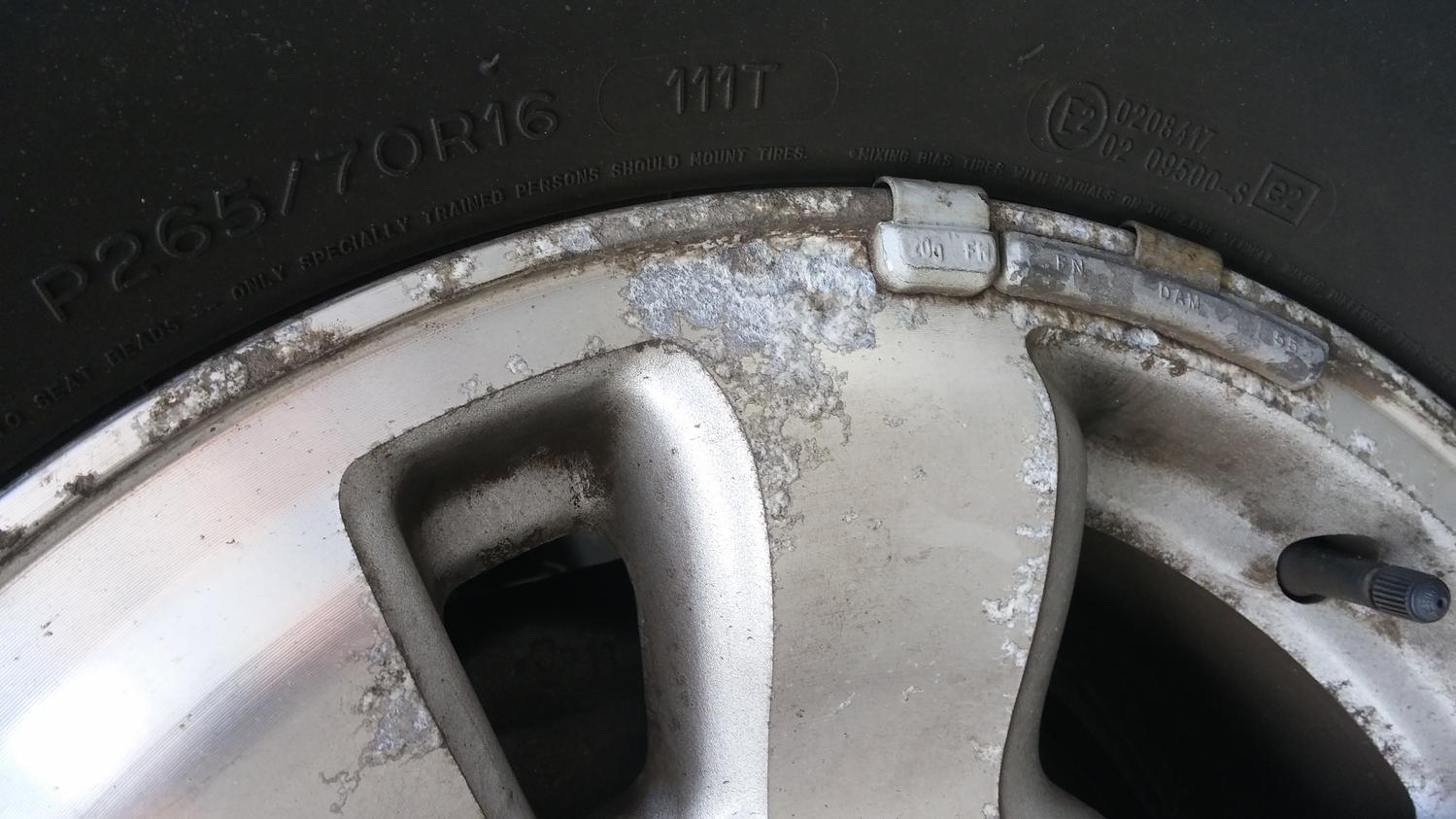

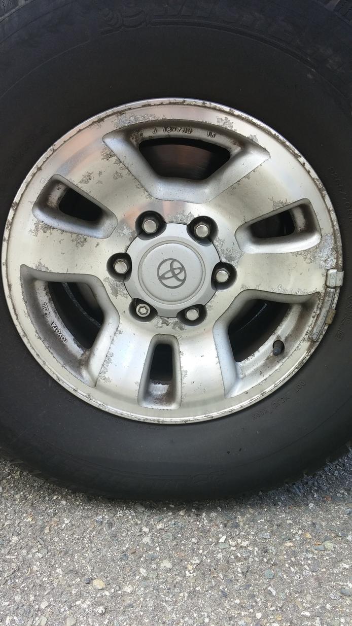

I have a 1998 4Runner Limited with some nasty stuff - almost like an oxidation barnacles (see pictures attached).
I have tried rim cleaner and scrubbing the rims with no improvement. Anyone have any ideas on what can take this stuff off?

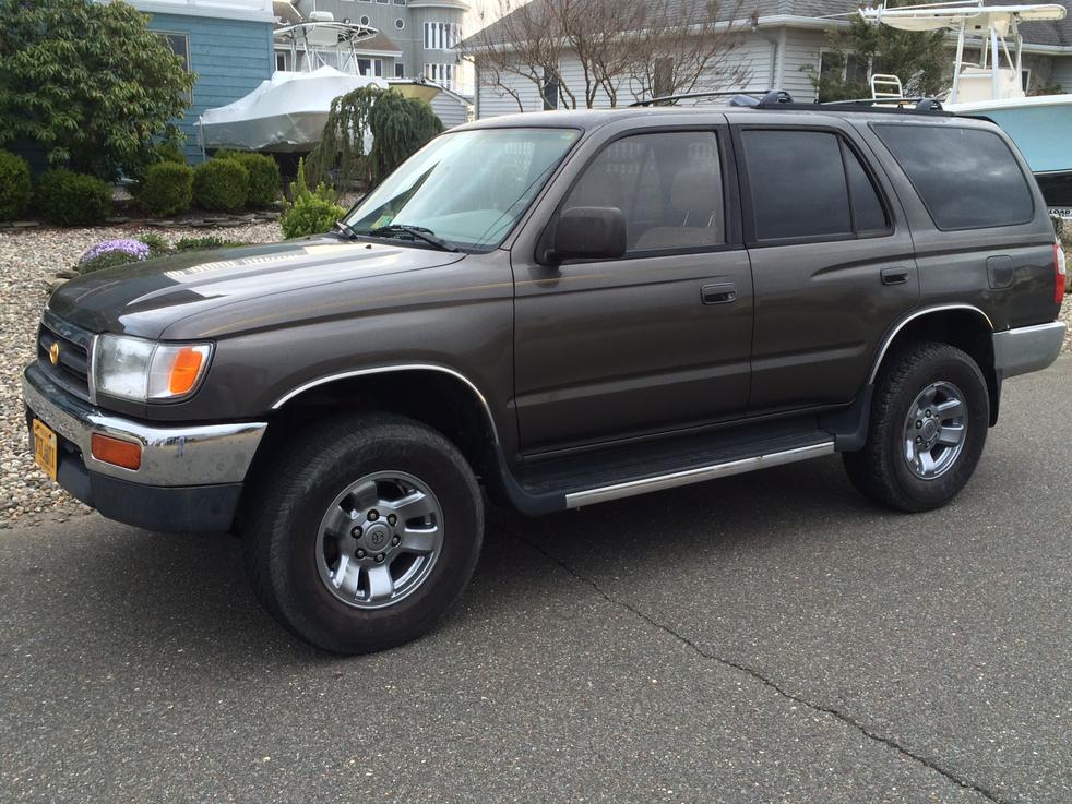

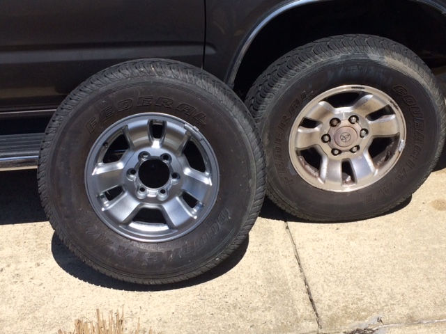

I had a similar issue on a 98. I used a paint stripper to remove the clear coat & lightly wire wheeled the rough spots.
Here is a before & after picture.
Go ahead & paint them. they are 17 years old.
