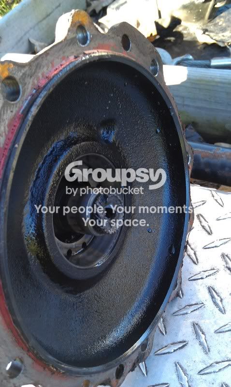

Well Back in the end of October I went on a wheeling trip that turned into a nightmare. As I was attempting to climb over a rock, my wheels locked up and something snapped... I was certain it was just a cv, until I got a closer look. Upon further inspection I had snapped something in the front diff.

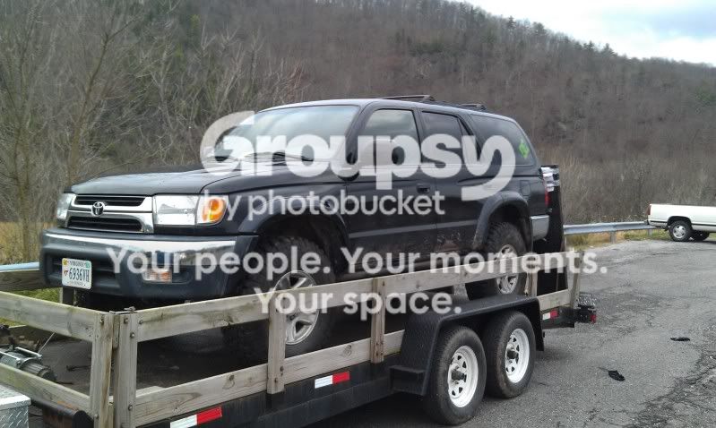

It took me a few weeks to get my first front differential because I was so busy with school, but my truck was still road-worthy in 2wd. After paying for it, it arrived fairly quickly and I swapped it in at a friends house in the driveway. We discovered that I had snapped one of the intermediate shafts. Why couldn't something easier to change have just broken? Well we installed the used diff and then I discovered that my truck was not willing to shift out of 4wd. I tried every trick in the book, and even check out some sensors that have been known to cause issues. Christmas break was coming up so I wanted to fix it before making the 180 mile trip home. Well the day I was supposed to go home, my truck decided it didnt want to drive (transfer case issue) It would only whine at me and act like it wanted to move. After having my mother take me home, I drove back up to school and had my grandpa tow me home on his car trailer. He has an old GMC Sierra with about 341,000 miles on it. Surprisingly we made it back after a long trip, and somehow managed to loose a wheel on the trailer within the last 20 miles.

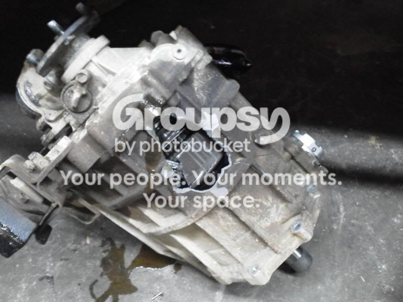

After a little investigating, somehow the t-case finally blew up. I guess it is better to know it was actually a problem than to just have a suspicion. I ordered a used t-case and had it put in. A few days later I got my car back, but the first differential had some bearing/gear noise... Oh the problems just keep on coming.
