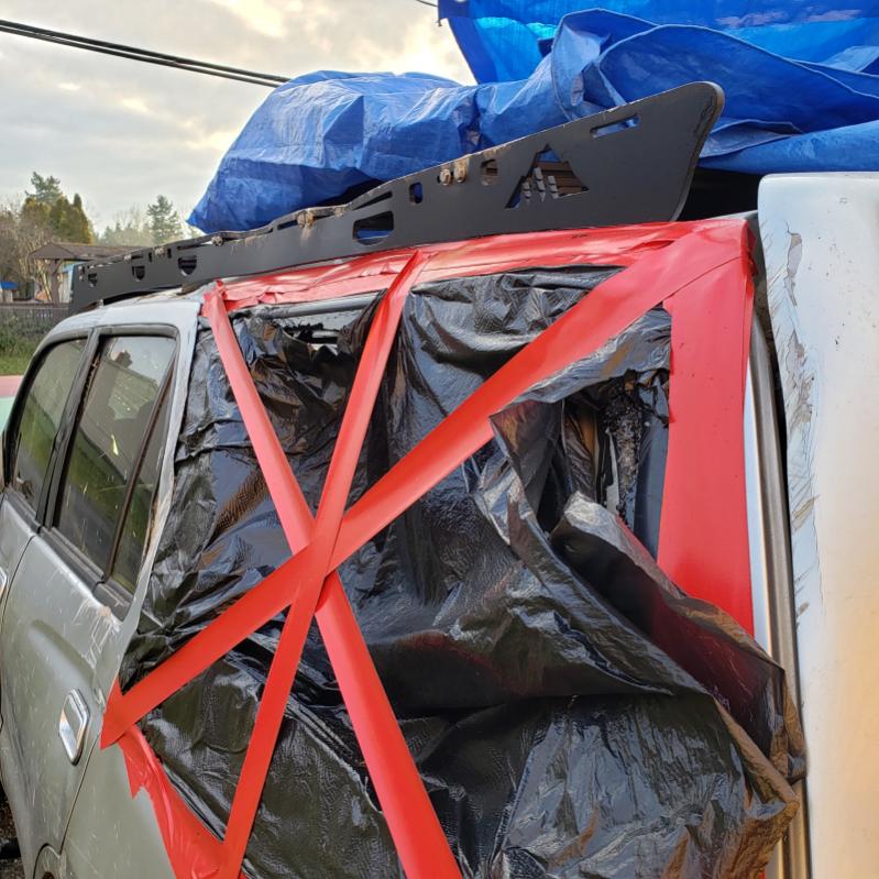

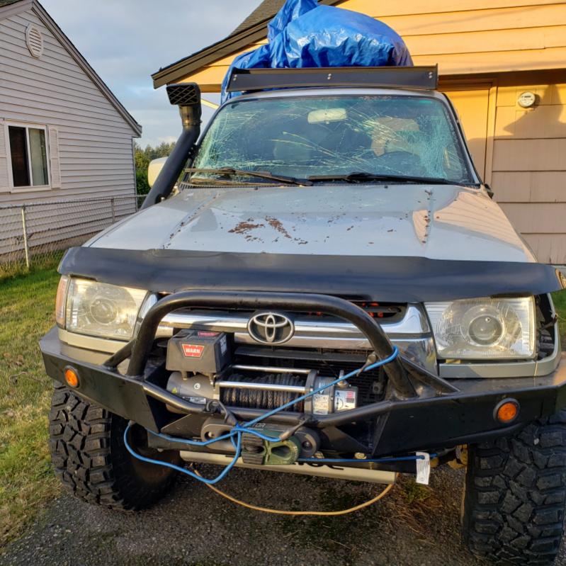

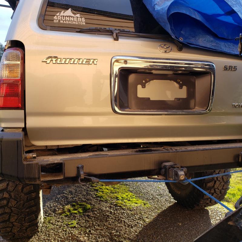

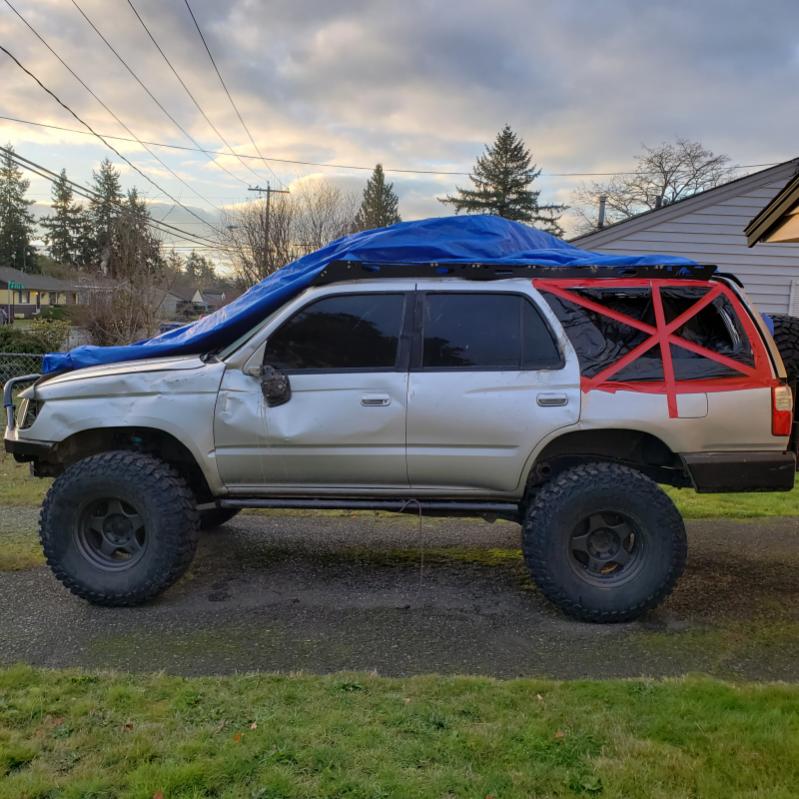

So I managed to put my rig on its side last week. The body is toast. It rolled over and took a hard landing on the driver's side. The body ate most if the damage. It broke the front windshield and rear driver's cargo window. Took big damage to A, B , C, & D pillars. The driver's side fender, hood, both doors, rear quarter, roof, and hatch are also toast.

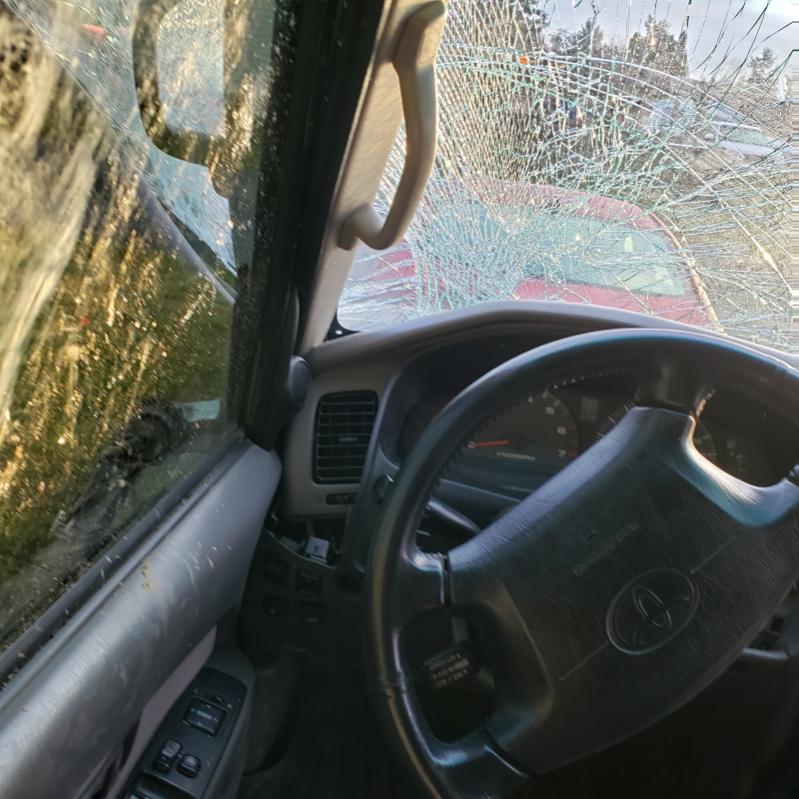

Additionally, the dash buckled as we lost about 4 to 6 inches internally.
But... Pretty much every mod / bolt on part are fine. The known exception is my new Sherpa Equipment Co. rack is toast.
People that have seen it and pictures have said that the frame shouldn't be bent.
I am currently waiting to hear back from insurance. I provided them this build page as well as a detailed itemized list of things added to vehicle, prices of those additions, as well as dates those were added.
I am trying to come up with options for moving forward.
The most likely plan is to simply get another 3rd gen 4Runner. This way most of the mods can be reused.
I might be tempted if I found a triple locked LC 80, but this is less likely. I don't really see myself getting a new vehicle, because new vehicle payments...
It would seem to me the most straightforward approach is to find a like year, ideally 1999 to 2002, 4Runner to park next to, and begin trading parts.
A few people have suggested that I find a body to put on top of my frame. I haven't come across a lot of people that have done this obviously, as it seems somewhat extreme, but it sounds like one of those things that are crazy enough that it might just work sort of solutions. Has anyone ever done this? LOL...
Differences between 1999-2000, & 2001-2002.
Given my choice, I suppose I would like to have a 2000 4Runner. If for nothing else, at least I wouldn't have to potentially deal with issues associated with the ABS brake master cylinder unit. They are ridiculously expensive for the 2001 and 2002s.
I suppose another potential issue is that I have gears and a locker in my 2002. If I found a 99 or 2000 that had a rear e locker, I might just need to swap over the entire rear axle and sell the rear e locker to maintain the 4.88 gears. other than that, at this point I don't see any other potential conflicts.
I know a few of you had this unpleasant experience and have gone one way or another with your next build.
I would be interested in hearing your perspective and sharing your input not only just for me but for anybody else potentially facing these types of issues.

Again, sorry for your loss, beautiful rig. If your frame is OK and you just swapped out the body could you use a 2wd car ? That would open up a lot more potential donor vehicles.
Years ago on a theft recovery my insurance would only cover the cost of the factory items, not the upgrades unless I had insured it for stated value and payed the additional premiums. Makes sense, why would they pay ~$12K for a vehicle that blue books at $4k ?
Id go for a swap out or even a body swap. many people have done body swaps..including well documented by thedurk.
maybe you can find a 2wd cheap...to me that would be the cheapest to find
That is significant pillar damage. Even me, who rebuilds frames probably would use that as a parts donor. Simply because you probably can't never get that all straight again. I glad it did its job and you were not hurt.
Or body swap. :) using your body as the donor.;)

if you look at my sketchy build thread... did the body/frame swap. lots of work but not hard if you do some planning.
maybe the most important thing about what your trying to do. I'm looking nation wide right now and have been for about 4 months for a body donor for my 97. want to find a decent body from a 97/98 base/SR5 (not limited) with mechanical issues and it's proving to be a very difficult task. trucks in this category or price range are going to copart or salvage. they beat the living crap out of them and usually somebody has already ravaged it. or you get the craigs list $3000 I know what I have BS.
I'm starting to expand my search and now I'm into the $3-4K range of drive-able but something kind of major wrong with them and even maybe a little body damage.
so finding just a decent body donor in the options/color/condition you want is maybe not as easy as it seems?
something like this is really really dam close and I almost jumped on a air plane to go get it.

To me the body swap idea sound logistically a bit difficult, but perhaps doable. But in the end, I'd still end up with a Salvage title.
I am perhaps leaning towards lucking out and finding a replacement to transfer parts to. Sucks because all the thinks that need to be done. Cut off, reweld sliders, another tub job, cam tab gussets, front bumper cut / weld job... Blah, blah, blah... I guess it's more of a linear grind.
But potentially, I could end up with a slightly lower milage vehicle to start over with. This would at least be a clean title i suppose. That's not super important because, even with my old rig, i considered myself an "end-user".
Yeah, who cares about the title if you're end user. Body swap would be easiest in my opinion. Mileage is moot really as well since you've replaced so much.

With all those frame mods. It's going to be a toss up. Either way I personally think your better off not to try to fix that smashed pillar body.
I could see you going either way on this one.
The good thing is you can take your time and decide what's best for your situation. :)

If it where my rig I'd just part swap to the new rig. Then sell what you can from the old rig as a part out.

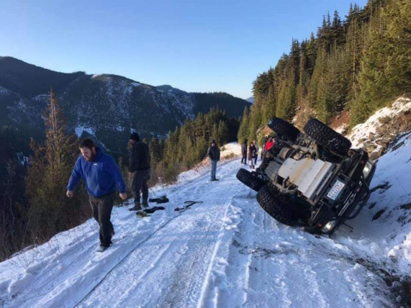

The burning question I have is how did you manage that on that section of trail? Did you lose control, hit the embankment and then flip?

The benefit to doing a body swap is once you remove the body you can clean up the frame and put a nice protective frame coating on it. But either way doing something a second time usually turns out better because you learn from your initial mistakes.

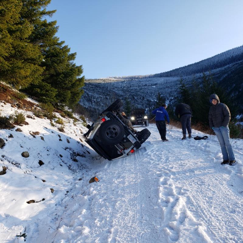

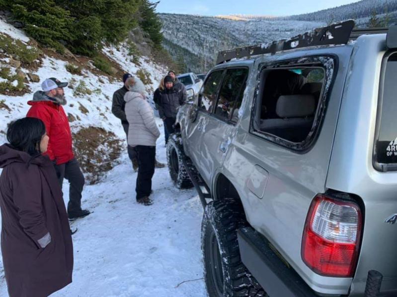

So, I think i get it now. So often we see some pic like this, and say, "how the hell did THAT happen?!?!
I used to think most of those roll overs happened doing something extreme, or someone picked a bad line, had a bad spotter, or maybe, just bad luck.
It was a hill. There was snow. It didn't look in anyway shape or form difficult. The FSR had been well traveled and a lot of that snow was compacted. But... I hadn't had much in the way of rear end breaking loose up till then.
We were done and the group headed down the mountain. I was the last vehicle. I had traveled about a 500 ft down the trail. I don't remember hard braking. But i think I let off the gas. Perhaps I tapped the brakes like when my foot isn't on the accelerator, it is hovering over the brake.
Anyway, the rear broke free and i began turning towards the mountain. There weren't a lot of good corrective actions options at this point. The road is kinda tight and the rear swung around quickly. So, often in these circumstances, the rear changes places with the front and you end up sliding backwards down the mountain. But at a critical moment, I was at a 90° turn facing the mountain. This is when the front wheels went into the ditch. The ditch is mostly large loose rocks. The front tires caught traction, and over I went.
I was so angry with myself and the situation that I never really considered the alternative of going over on the other side. All I could think about was the crash and what it meant.

Maybe you hit a patch of ice. When you hit ice, there's not a whole lot you can do other than go along for the ride.

In theory, especially if insurance shows no love, this might be my best course of action. If a body can be found.
Or body swap. :) using your body as the donor.;) *Hahahaha*
LOL. I would need A LOT of "body work"... Easier to do work on the truck, than MY body.. hahaha
I quickly realized that any hopes of getting off easy with body work were not realistic. So depressing..:fear:

If you're looking for a clean body, the donor vehicle doesn't have to be a 4x4. ;)
Good point man. I am leaning towards parts swap over body swap, but we'll see.

Yeah, it really looks 50/50 at this point. Although, if I could find a nice 3rd gen, then it might be worth swapping parts over swapping body.
I will take some time to think about what I might do a bit differently this go around.
Yeah, I think it was either a patch of ice or compacted snow that was just enough to set things in motion. It was all downhill from there. Yuck, yuck, yuck...:yo:
Here is my take on the whole thing. First, don't get set on any given option until you hear back from the insurance company. You might get more than you thought (like I did) or they might try to rip you off. It just depends on the agent you're dealing with, the company, and you as a customer (time being with the company, and how many items you have bundled).
I would say the preferred method would be to a buy a running driving vehicle and swap your parts over, it's quicker and easier. Next in line would be a body swap, if the insurance company really sticks it to you.
Also, in my case when I got the final offer I was given the option of hiring a third party appraiser to evaluate the value of the vehicle and going to mediation with the insurance company to resolve the difference. While I could have sold my 4Runner (pre-accident) for more than they gave me, I felt their offer was fair and it wasn't enough of a difference to get lawyers involved. They also paid the $1000.00 recovery bill, so I figured that into my decision too.
Edit: One more thing, if it sounds like my insurance case went smooth that's not the case at all! I talked to over a dozen different people and spent hours, and hours on the phone explaining things and arguing my case. It wasn't until I finally talked to a guy (a Jeep guy) that I made some progress, he directed me to a another division and the guy over there raced Subaru rally cars and had friends with Toyota crawlers, that's when things went from hell to knowing that it would work out. Hopefully everything works out in your favor and they are at least fair about what numbers they come up with.

You're just lucky you didn't go over the other side, you would have been f**ked! You could do a body swap, it's not that hard and you might be able to register it as your donor vehicle with a clean title if you know what you're doing. Salvage title doesn't matter if your planning on keeping it though.
