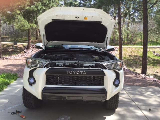

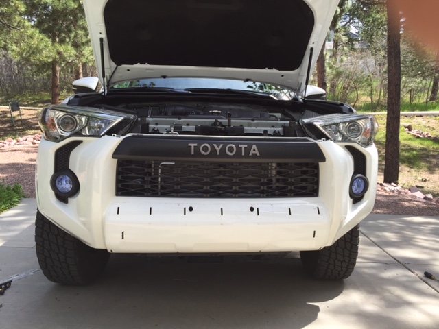

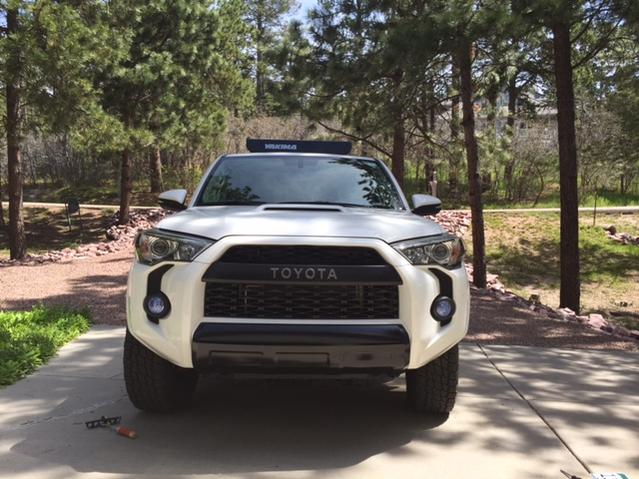

Well, per below I was able to change the front valance WITHOUT removing the front bumper.
My high-level steps:
1. Break down the top portion of the grill to get easier access to the top and middle clips.
2. At the bottom of the bumper, remove the 6 screws holding that portion together so you can get access to the bottom clips.
3. Look at the inserts on your new valance so you can count the number of clips you need to remove and placement.
4. Technique, technique, technique and go slow. Some of the clips come out super easy while others need you to use a flat head screw driver to press down on the lip of the clip so it slides through.
Thanks to those who game me the kick in the pants to do it myself!
Now off to the back valance over the weekend! :)
