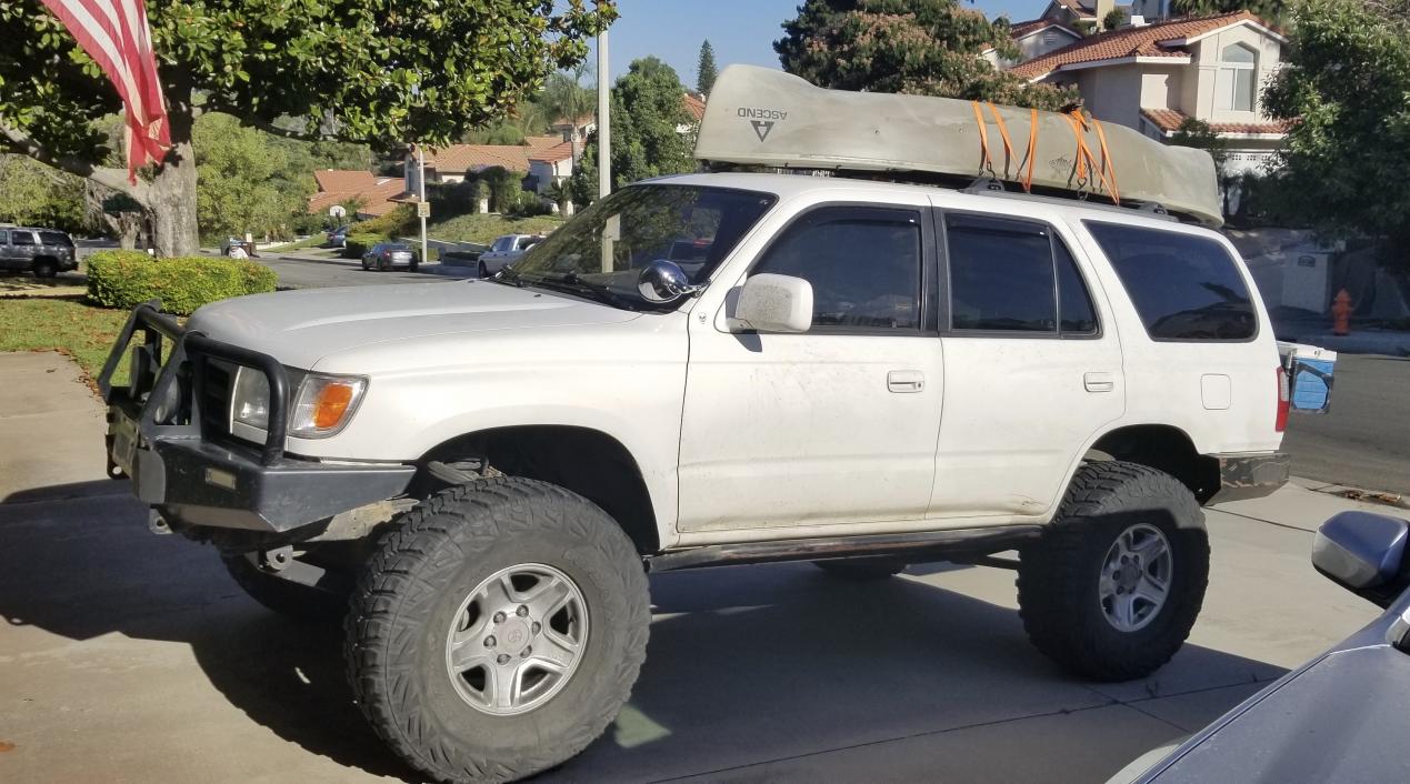

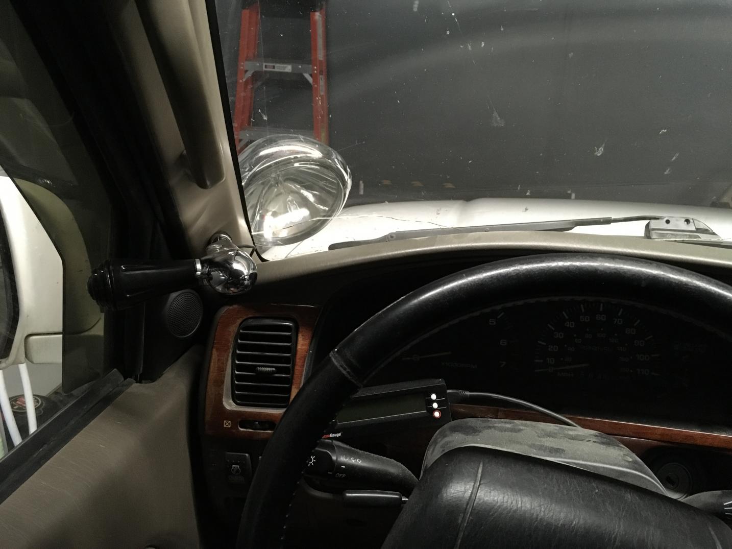

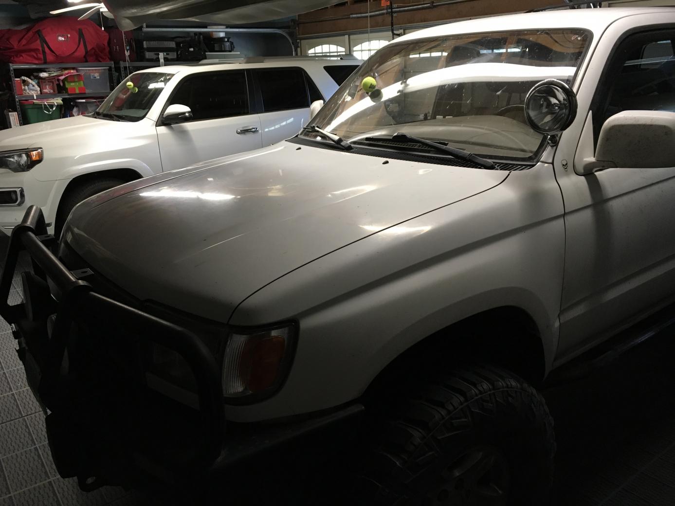

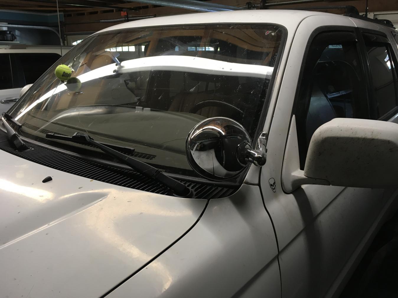

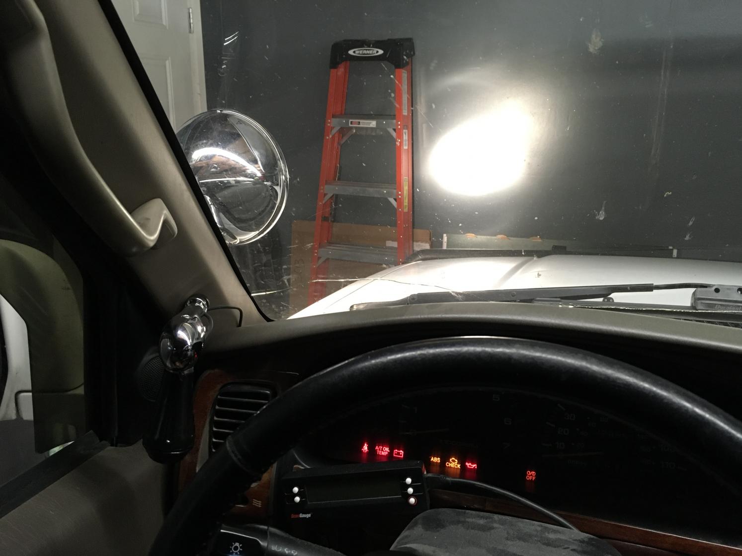

What’s up T4R, been a long long time! I haven’t done anything new on my truck in years (but still use it for camping and overlanding a lot, and the occasional trail run here and there). Anyways, I installed a Unity cop style spotlight on the A-pillar last month and figured I’d show it off on here. It was a pretty easy install, took about 2 hours, and pretty straightforward. Just one hot wire from the light which I tapped into the ACC. fuse in the fuse box under the dash. I gotta say, it’s really nice to have an aim-able spotlight on the truck - especially when I’m looking for a spot to camp after dark!
BTW, the cracks in the windshield have been there for probably 15 years, so it did not happen while I was drilling through the A-pillar.
P.S. That’s my wife’s 2017 Limited 4x4 in the 2nd pic (which is exactly 20 years younger than my truck). Kinda cool that they’re both basically the same color too.
