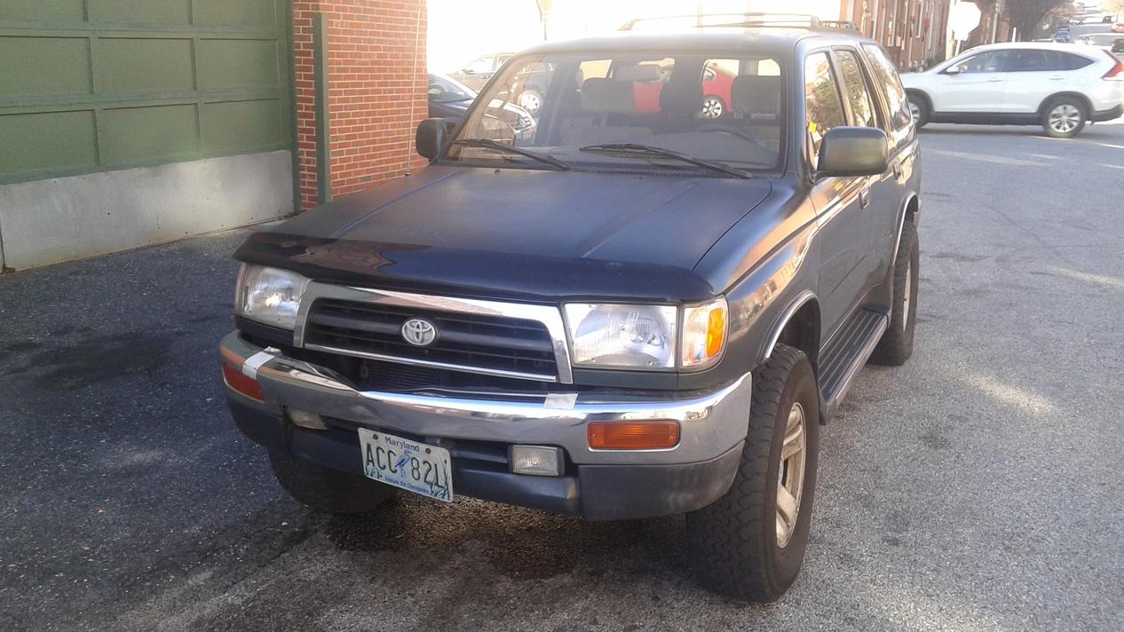

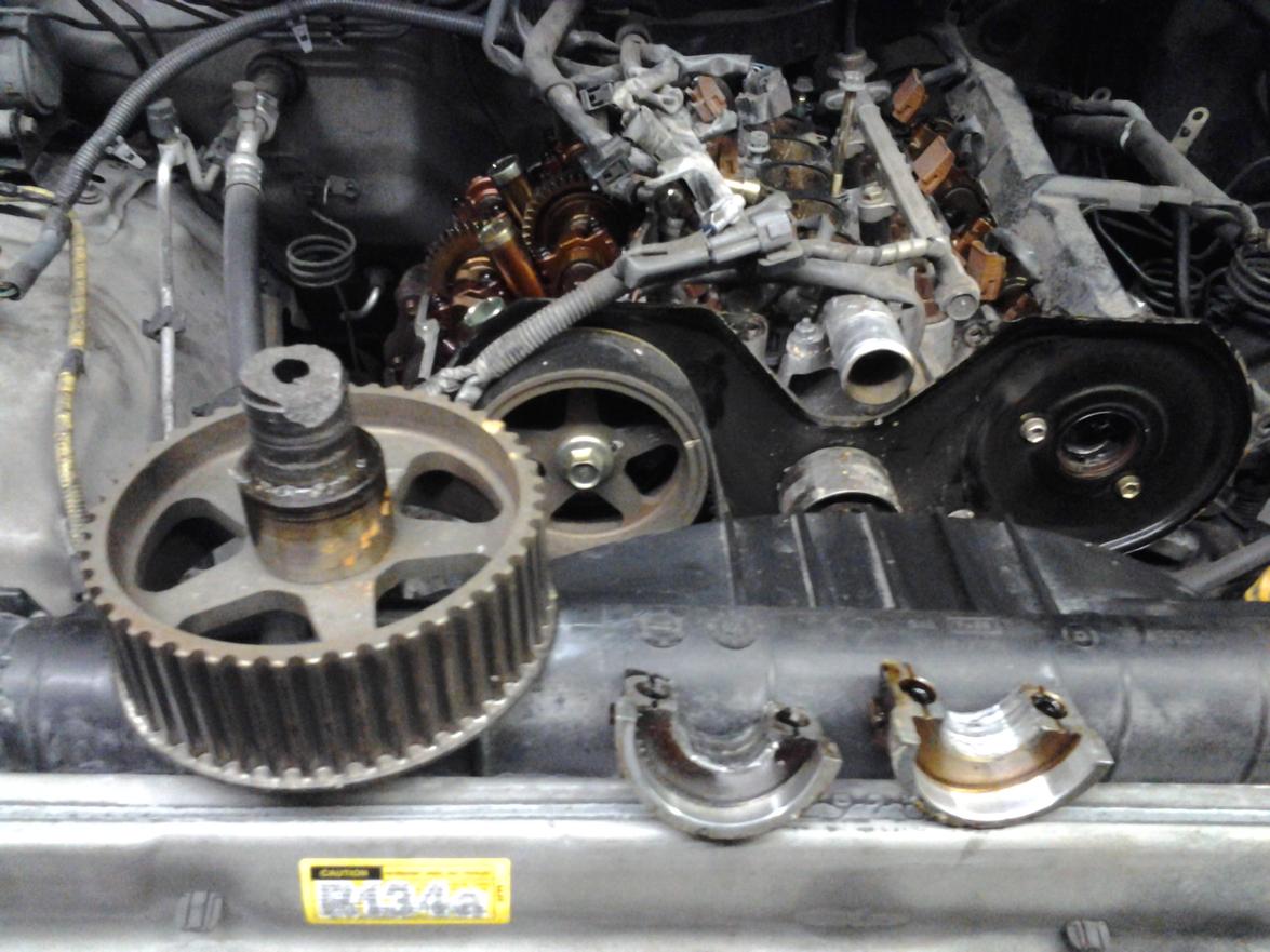

I recently purchased a 1 owner 96 4runner 4x4 with a seized 3.4L for $200. Po neglected a bad oil leak. When he told me that he wasn't interested in repairing it and that the scrap yard would pay him $160 (price of metal is down) i quickly offered $200. So this is my next project. I just found a 109k mile 3.4 out of a recently wrecked 02 4runner 4x4 from the same Arizona salvage yard that i bought my 69k mile 3.4 for my tacoma. I know these engines are basically the same but should i expect any issues considering the 6 year difference? Anybody here done a similar install? Thanks.

You're going to have some issues, but nothing that can't be dealt with in stride.
Basically all you're going to need to do is take the intake off of the 96, and put it on the 02 engine.
Injectors need to be swapped out, throttle body, but that should be it.

I swapped a 2002 JDM 3.4 into my 98 after my original 3.4 experienced a rod failure. As the engine components were totally different I stripped the JDM down to a long block (block,heads,intake) and swapped everything from the old engine. If your replacement came from a 4r, as our esteemed colleegue above has stated, you will need to swap the intake assemblies and the fuel injectors(part changed in 98). I'm pretty sure the exhaust manifolds and crossover pipe is the same. I'd detach the wiring harness and pull it back and tuck it under the wipers, then pull the old engine and compare it to the new, do all the gaskets (VC's, TB/WP, main crank seals, oil pan, etc) before dropping it into the truck. All the engine sensors are the same. So, when you're ready to drop the replacement engine in, it should be fairly straightforward, drop the wiring harness back into place plug everything back in and you're good. I was quite happy to have replacement parts--- alt, coils ps pump, ac and lots of bolts. You'll have more! Good luck, you scored!
Checkout my swap: http://www.toyota-4runner.org/3rd-gen-t4rs/167172-my-engine-swap-progress.html

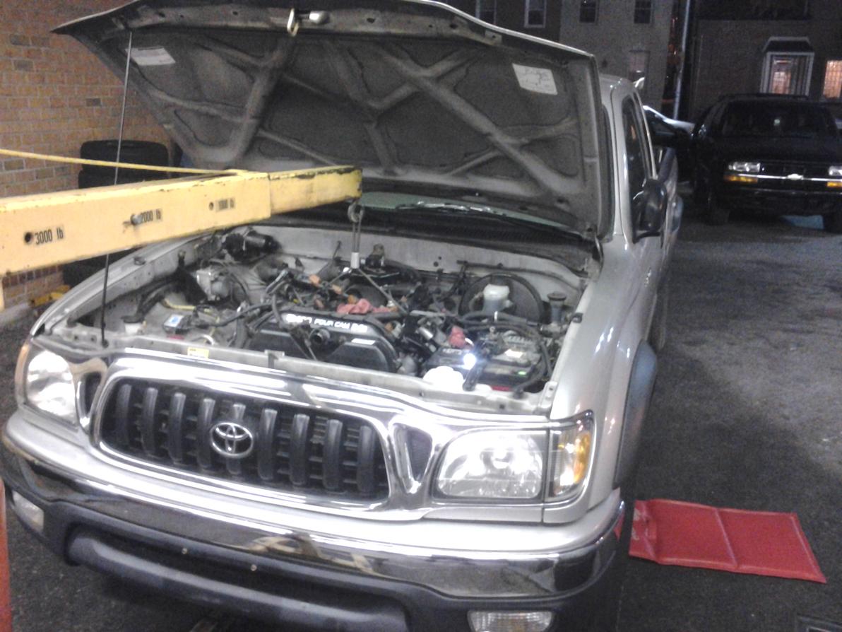

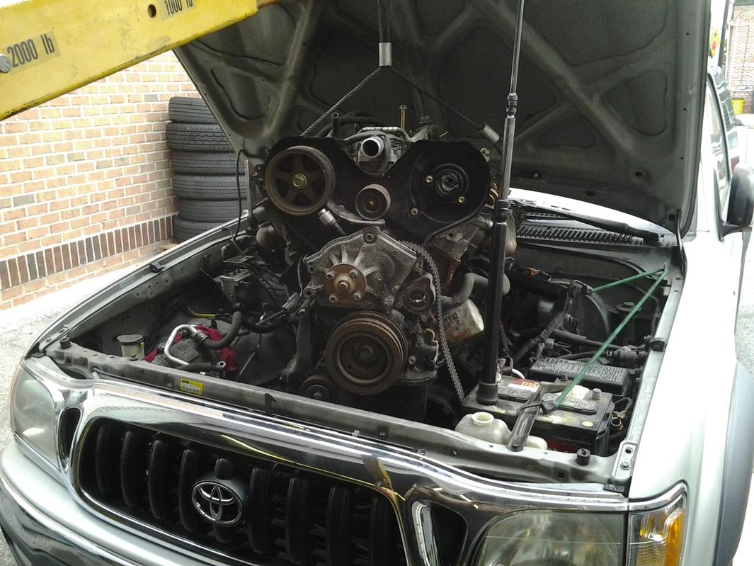

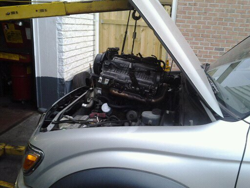

Thanks for the info, i was unaware that the injectors & intake were different. I did a 3.4 swap into my 04 tacoma 4x4 2 years ago, donor engine was a 03 tacoma prerunner. No difference from a 2x4 to a 4x4 so that install was easy. I do plan on replacing all the maintenance items while the replacement motor is on the engine stand, like i did with my tacoma. Po lives in a apartment complex and works in the city so after the motor seized he had no place to keep it. He bought a new Hyundai the day after the runner died. Po works near my work and he knows i'm into 4x4 Toyota's and asked if i wanted to buy it, if not it was going to the scrap yard. I also need a bumper, po & his coworker thought it was a good idea to hook the tow strap to it. Truck is solid and clean, would have been a crime to send it to the scrapper! I had it on my lift at work, undercarriage is nice. If it would've been rusty it would be a parts truck. Po gave me all the original sales paperwork from when he bought it new & maintenance records with it. A big plus with this 1996 is in Md. when a vehicle is 20 years or older it can be tagged historic, no inspection or emissions testing.
I considered a JDM for my 4x4 tacoma project i did 2 years ago but after looking at pics of them i saw that the oil cooler and oil filter were in reversed locations, alternator looked different and i read that the emissions equipment wasn't the same. I read it's no big deal to change out the parts but then i found a 69k mile 3.4 out of a wrecked 03 tacoma so i went that route.
The alternator is the same, just a different pulley. The oil cooler location is another easy swap. The water pump is different but you should replace that regardless. Not sure what you mean about the emissions equipment being different.

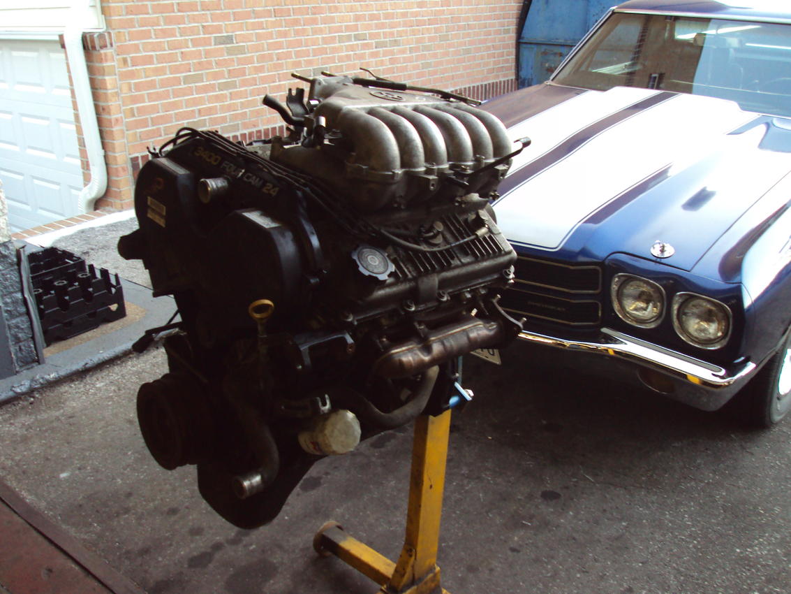

I have this 3.4 that i bought off of craigslist a couple years ago for $200. The seller said it has a bottom end "tick type noise". I bought it because i thought i needed the heads when i originally planned to rebuild my original tacoma engine but then i found that used 69k mile motor out of a wrecked 2003 prerunner from Az. so i went that route. After i complete this 4runner project, I'll have 3 complete 3.4's sitting at work.
Wow, just noticed this post on pg2... a tick type noise... that was my problem with my old engine! It turned out to be rod knock. When I dropped the pan, there were lots of metal chunks in the bottom! Sounds like with a combination of the $200 engine and your old Tacoma engine, you'll have a spare!! It'll be time then, to go looking for another 4runner or Tacoma needing an engine!
