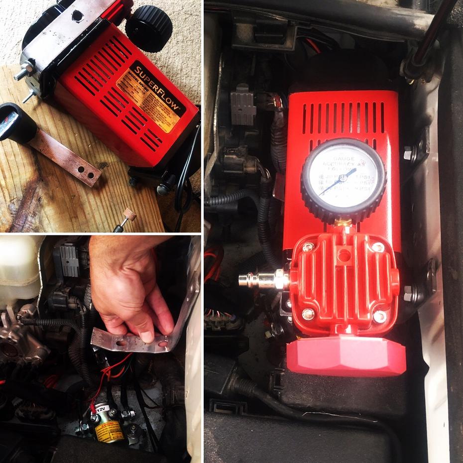

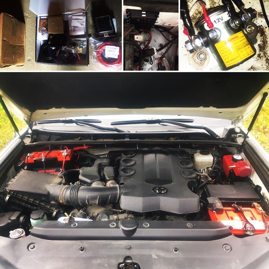

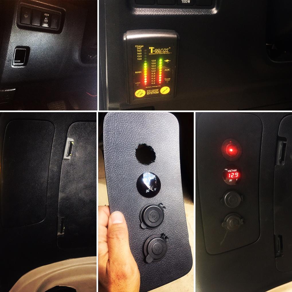

Just wanted to thank the original author of this thread for getting me started to do this mod, which I finished last weekend. Used the mounting info and customized a tray to fit in the same spot. Used a different isolated battery setup so I could also link both batteries together if needed for jump-starting the starter battery from the auxiliary battery.
While I was running wires, I also installed a fuse block, air compressor, and some extra outlets in the rear for charging things. Thanks for getting this project rolling!
