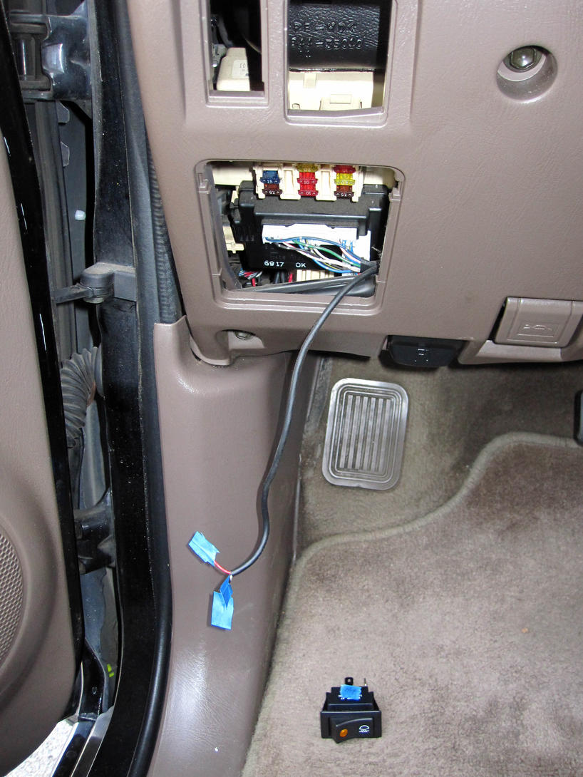

yes it has the black wire that has a little push button on the end with the red/green light. that is what i am trying to ask. is how that hooks up. because i thought they all hooked up to a toggle switch. sorry about the confusion. and thanks for the help. Sick runner.
Thanks! You will want to buy the Toyota OEM switch. I don't have the part number but you can find it pretty easily if you do a search for Toyota switch.
Install the lights, relay and PIAA switch, running the switch cord through the firewall and into the dash where the switch will be. Once you verify the lights work, cut the switch and connect the wire to the back of the Toyota switch using spade crimps.
