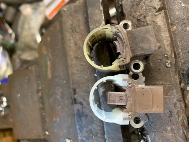

I think you're on the right track by changing out the brushes. Super easy to do. Here's a picture of a set of brushes with 280,000miles next to a new set of brushes. I can hardly believe they were still working fine when I changed them out as a routine maintenance item. I seriously doubt they would have lasted another 30,000miles. So yeah, at 310,000miles you are due.

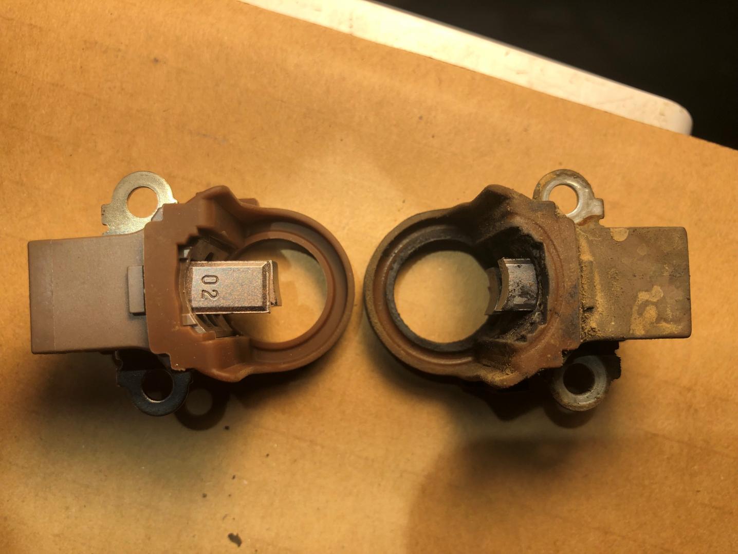

So I replaced the brushes, got the alternator back in, and noticed the light was still on... scratching my head I started checking voltage and noticed it was dropping quickly, worse than it had before. I thought maybe I finally shook something loose 100% and now the alternator was toast. I go to the only parts store near me that had a carquest alternator in stock which is about an hour round trip. I get back, start to take the OEM alternator back out and notice the belt has no tension! I look at my buddy confused because we had both checked the belt for tightness. I am able to get quite a bit more turns on the adjuster before finally reaching tension, and no more battery light! Going on 4 days now without the light coming on.
Than you guys for your help and figured I would post back on here to share my results in hope that it helps someone in the future.
I have attached a photo comparing my 310k mile brushes to a new set.
