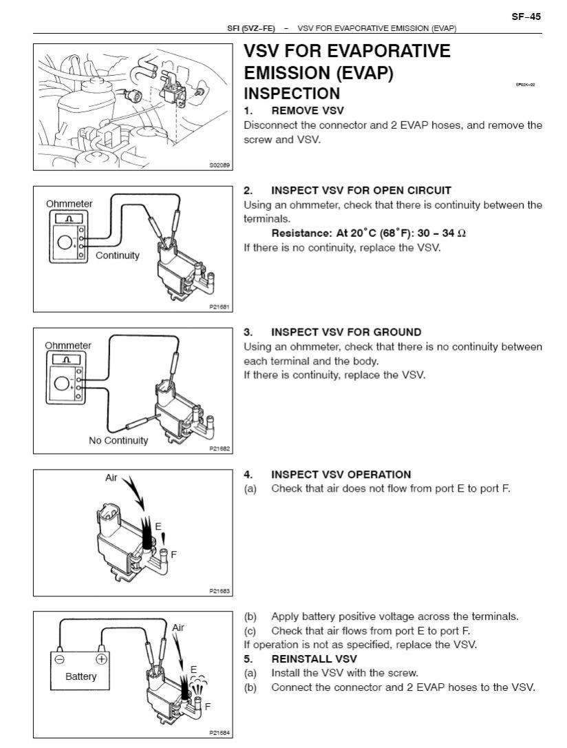

VSV:

I just tested my VSV and I get an ohm reading of ~40.4 after the unit has been sitting in my house for a few days to get to roughly 68F. I'd say that's quite out of spec! I'll be getting a new one of those and reporting back to ya'll to see whats up. I'll probably grab a TPS too.
