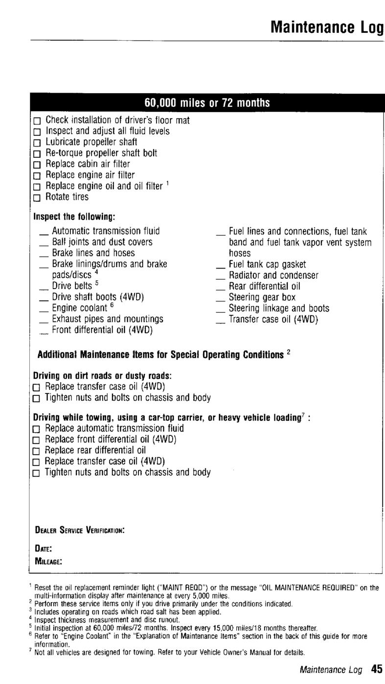

How often do you guys complete the "Additional Maintenance Items" in the service guide?
I am due for a 60k, which includes: lube prop shaft, re-torque prop bolt, two air filters, engine oil and rotate tires.
The additional items are: transfer case oil, trans fluid, and front & rear diff oil.
Should I do any of these items at 60k? I don't tow anything, other than an occasional kayak trailer, which weighs maybe 400# loaded.
I am fairly certain there is a *note in the manual that the additional items are only for certain types of driving conditions which they call out. I don't think occasionally towing a 400# trailer would fall under those conditions so I would recommend you wait to change those.
*Check to verify
:iagree:
From my 2013 Warranty & Maintenance Guide. Check note 2.
