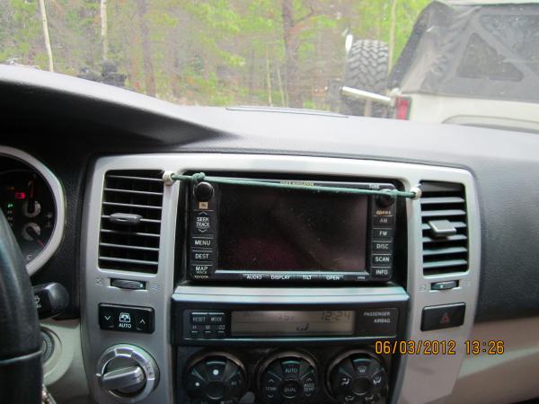

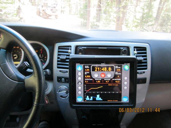

I guess I'll step in and post my sophisticated high-tech iPad mount. Pictures speak louder than words so I'll just add the pics. 1st with iPad, 2nd just the mount.
What app is that? Looks like it has an icon for anything from music to navigation and then displaying some vehicle stats (obd2 info?)...
Thanks guys, sorry for the hijack maddogdunn! I used to be a computer tech and as much as I love technology sometimes the simple solution is best.
The app on the display is GPS HD by MotionX, it's their topo/trail navigation app which I highly recommend. Also excellent is their on pavement app, GPS Drive, which I trust far more than the built-in.
