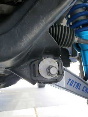

And by "alignment tabs", I assume you mean these reinforced blocks?
Since at this point I plan on doing all of the lift install myself, and not getting a shop involved at all (other than for alignment), I think I will probably skip those for now. If I do something crazy (like 35s, :p), I may consider them at that point.
