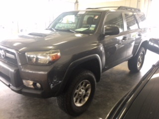

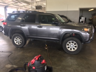

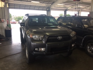

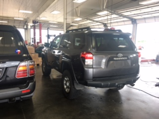

I've been researching 4Runners like crazy for the past month and have decided that the Trail Edition w/ KDSS is what I want, but my budget is $20,000. I found a 2010 outside San Antonio, TX (I'm in Denver, CO) with 128K miles for $21,000. The one owner took great care of it and had a Toytec Ultimate 3" lift upgrade. I'm planning to fly down next weekend and drive it back to Denver.
I want to drive this as my weekend adventure car for the next 10+ years and keep driving my current beater as my city car. I want to mod it enough to get to really obscure campsites in the middle of the Colorado wilderness, and not break down and strand me there :)
Is this a good idea? It was about the cheapest Trail Edition in America (not including states that salt their roads like WI and PA). I love the color. The salesman says the owner took great care of it. Should I go? If I do, what should I look for when I get there?

Did you research book value of like vehicles and check if there is an accident record? That's where I'd start. Then when you get down there give it a good look over. Test drive using all modes and when you get back; put it up on a lift and check for leaks, wear and old damage. Also (since you are in Texas - look to see if it may have been water (storm) damaged. You could also check Entune, but I wouldn't expect that to work - few do!
128k miles with a 3" lift and KDSS
i'd pass, that's really pushing it for what the KDSS likes
I've tried looking up the lifespan of the KDSS and haven't found anything. What kind of lifespan does it have? How much does the 3" lift eat into that lifespan? Thanks!

A lift of up to 3" prematurely "wearing out" a KDSS equipped truck is purely speculation. I have yet to see some one definitively link these two variables together. I would be more concerned with:
#1 - corrosion around the KDSS accumulators (wiring and KDSS ECU) caused by salt or equivilent. Since this truck appears to be from TX, you should be fine there.
#2 - the mileage. KDSS like most suspension parts is an item that will eventually break/wear out. When it does, its an expensive repair. If the actuators begin to leak to the point where the KDSS light comes on (due to loss of hydraulic pressure), they will have to be replace at roughly $1200-$1500 a piece. You will also need to have the KDSS system "recharged" with hydraulic fluid - another costly aspect. Finding a dealer to do this work is also another challenge..

I looked through many posts on here about KDSS lifespan and I haven't found anything yet to suggest it needs work at 100K, 150K, or 200K. It would certainly be expensive, though.
There is another 2010 TE in Utah with about 50K miles for a few thousand more. I already placed a deposit on the one in TX, but it might be worth losing the $500 deposit and $100 plane ticket to TX to save 70K miles.

70K miles huge difference. Don't forget no matter how good taken care of natural wear and tear happens (belts, breaks, exhaust, suspension, etc.). I would def save an additional 70K in miles all being equal with small up charge.
I would definitely go for the one with fewer miles. Not that 120k+ is outrageous, less miles is just usually better. Personally I wouldn't buy anything used with over 100k on it, but thats just me and my budget.
These trucks can last 300k mi easy.... but there will be some maintenance along the way and things like alternator, brakes, CV axles, suspension, LCA bushings, AC compressor, steering rack,u-joints... will all probably need replacing in that time depending on use.
The fact that you said KDSS + 120k + keep for 10 years, is a big red flag for me.
KDSS can probably go for 200k if your lucky, but if you are planning on 10years of ownership and starting with 120k... the chance that the system will go belly up during that time is very high IMHO. If it did not have KDSS I would say it was a good deal.. but with it.... not something I would do unless you have plans to rip it out and go LT, SAS or something.
It's a one off system, so there is no aftermarket support for it. You are looking at 3-6k to have it fixed when something goes wrong and are limited to Toyota dealers and parts. This is not your typical old Toyota truck suspension system that uses very simple and basic components.
