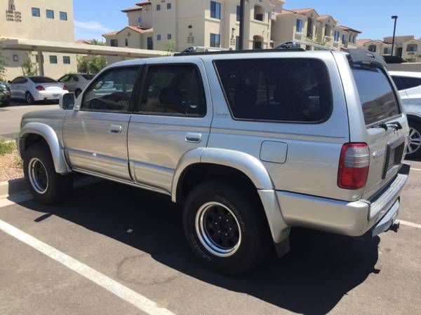

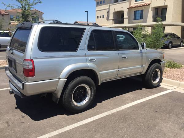

Mild body damage from a fender bender on the passenger side, doesn't affect driving ability at all. Easy fix, just haven't had time.

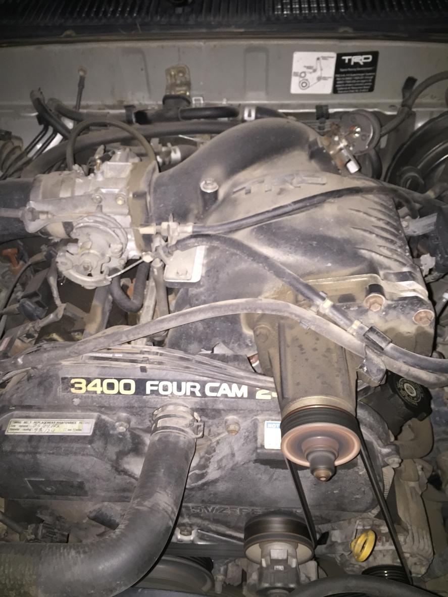

Oil on Supercharger Cone

That front end is a couple hundred bucks plus paint, assuming that everything is straight underneath. Oil on the cone probably means you've got a rebuild in your near future, if you're up for that. It's not very clean in general - without the supercharger I'd call that a $2500-$3000 truck around here, and even with $4000 is a stretch. With those miles and that damage, that truck smells like a project. Which is fine, just be ready and pay accordingly. I'd have a hard look at the timing belt, and take compression numbers.

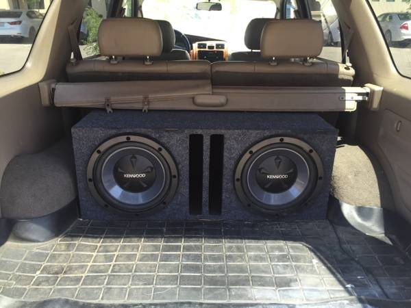

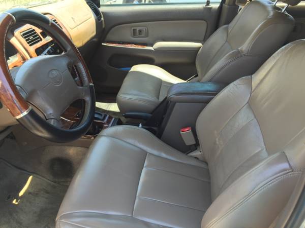

Yikes. Something doesn't seem right. Couple of insights:
  • Don't let the SC cloud your judgment.
  • Would you think about purchasing this without the SC?
  • SC is a good indication of a potentially harder driven vehicle than a stock one.
  • Personally I would NEVER buy a vehicle with an SC. I will install it myself.
  • How is the SC (ECU) tuned or is it tuned? You've been on the site long enough to know you must tune these correctly to prevent engine damage.
  • Interior carpet, drivers side worn, not the mats. (Look at that dark area)
  • After market radio and big woofers in the back = younger owner. (Not always, but those are higher on the priority list than regular maintenance)
  • Front end damage is more extensive than a fender flare. Headlight is off kilter, hood and rt corner panel don't match up correctly, front grill has damage.

that thing is totaled, I offered parts car price, he declined.
so, accident happened at 75mph and he was tailgating a full size 2015 dodge truck in rush hour. the dodge tapped the brakes and he hit hard... the pictures show superficial dmg. the true dmg is the frame, the passenger side is push back and the front frame pushed up, the body is twisted on the frame, and it shows in person, it has a inch lean in the rear, and the springs just dont' sit right...
it's a parts car, it should not be driven on the road. I have a mech that could straighten the frame for $200 (so he says') but I'm possitive that's just the beginning of the issues it has.
it also has a whole front clip job, looks like the work was done along time ago... didn't look at title, I'm sure it said restored.

valve cover looks like its leaking.
