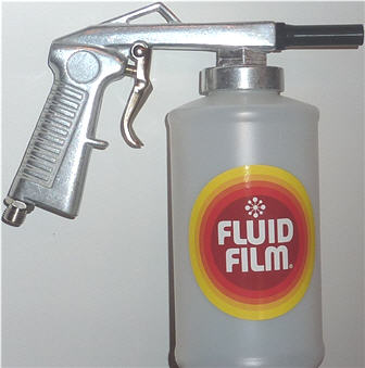

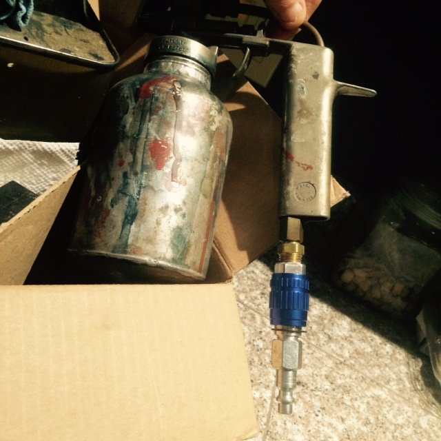

- In my opinion a wax-oil like Fluid Film works best, applied on dry metal
