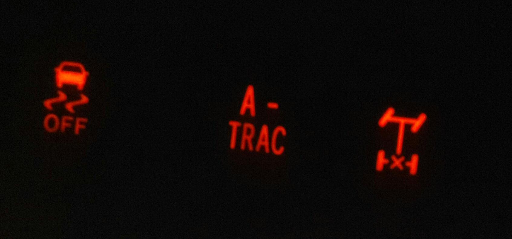

It's standard on the '14 Trail Premium and the button is up near the rear view mirror. I can't speak to the SR5 or non Premium.
Trail only, and looks like the one on the right at night.
