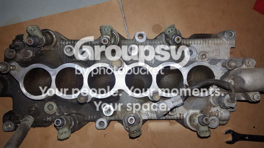

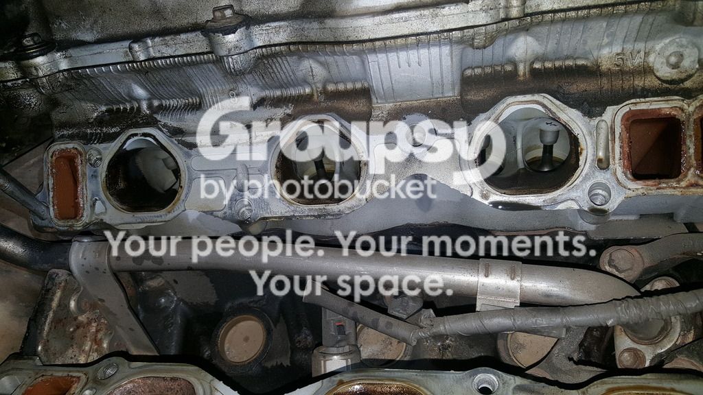

Passenger side of engine is to the left

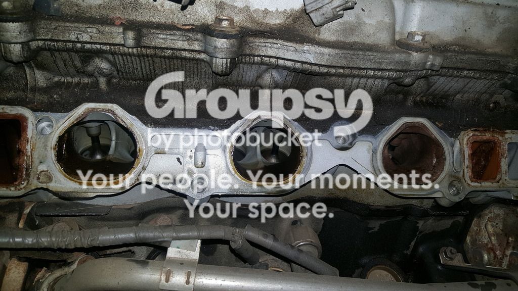

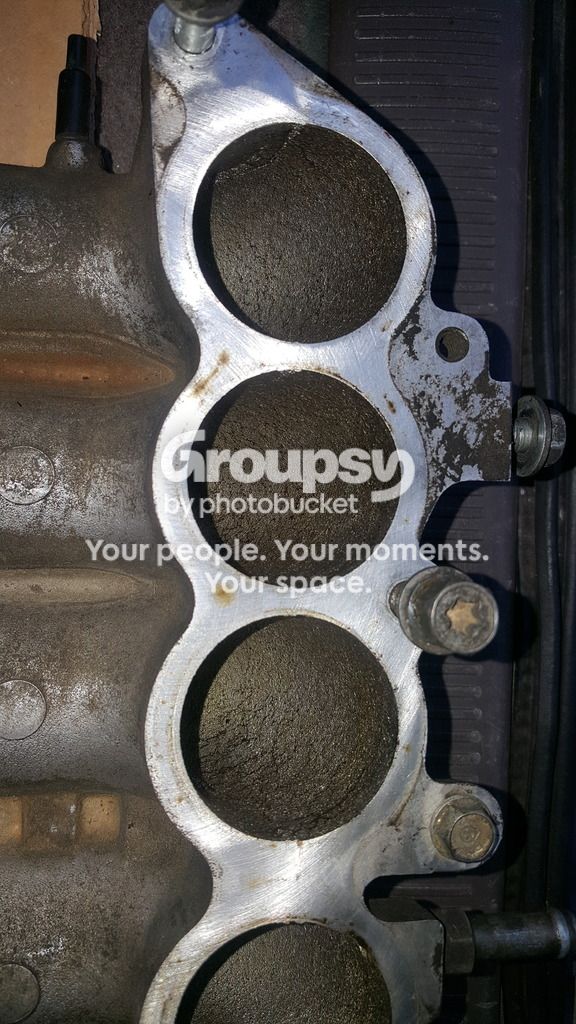

Close-up picture of Passenger side of the engine. What would make this cylinder look like this? and could it be a contributing factor to why there is moisture/oil in the top portion in every other valve passage.

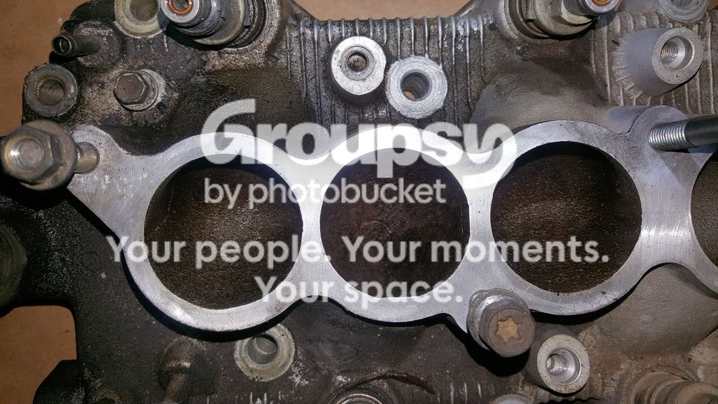

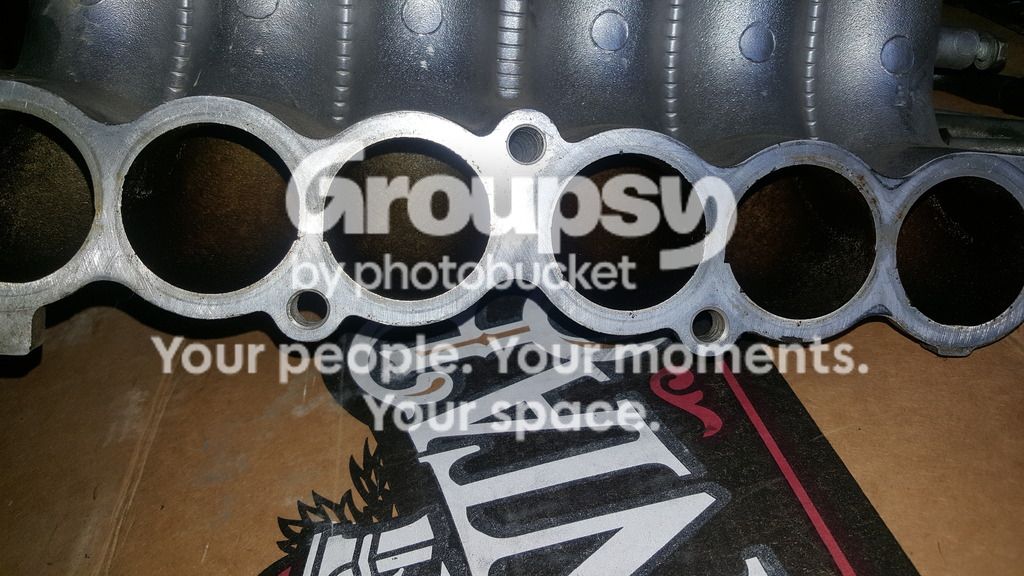

Manifold
Bottom portion of intake plenum

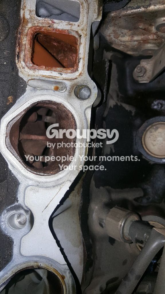

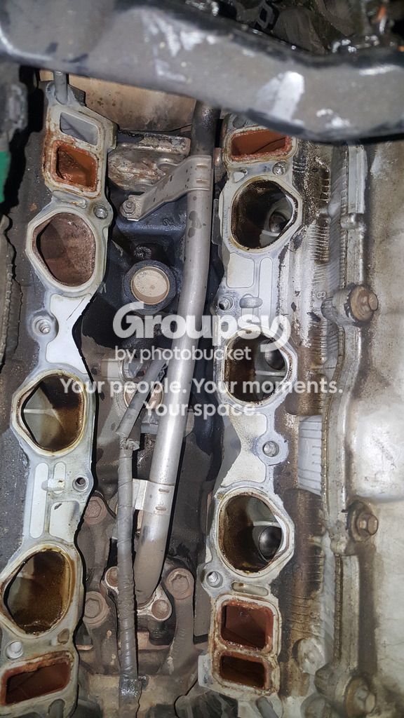

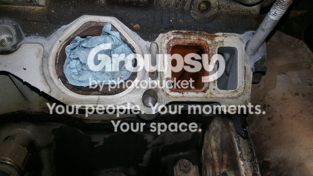

Is the right portion of this picture not connected to the cooling system as a cooling passage?

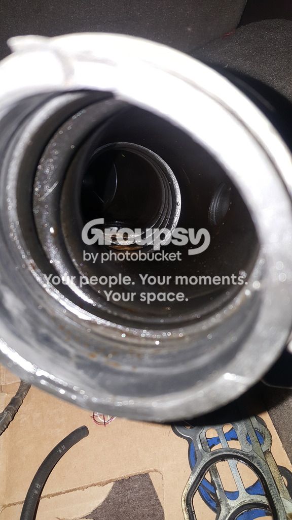

Intake has buildup that looks like a mixture of water and oil?

Looks like you may be in for an engine rebuild at this point. The water and oil in your intake can be due to a blown head gasket along with blow by of the piston rings. If that's the case, yank the engine and have the whole engine rebuilt. That engine has been through a lot, you're now over 200K miles, I wouldn't be surprised if that was the case.
Ah and the brown crap is only in the water passages, old nasty antifreeze most likely. Very possible there was not enough antifreeze and to much water, causes rust inside the engine.
JDM motor or low milage used or rebuild if it's done right you'd be money ahead.
Part of what you said indicates blown head gasket, pull plugs look in cylinders see if coolant is on piston/s or pull heads.
