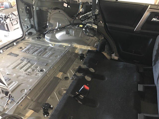

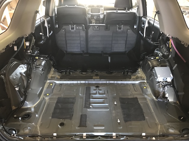

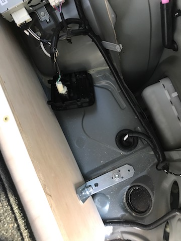

I determined that I could gain several inches of width for my drawer if I removed the plastic side panels, so that is where it begins, with a complete teardown of everything behind the second row seats. Lots of pics!
Look at all that wasted space in the walls! Kills me!

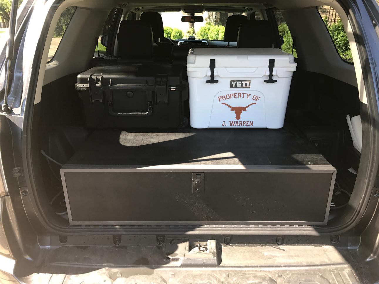

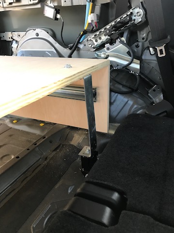

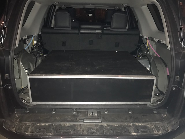

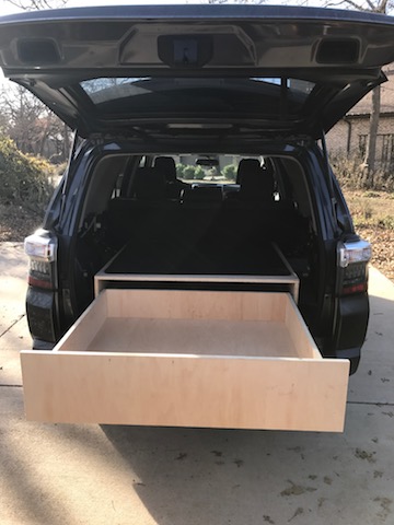

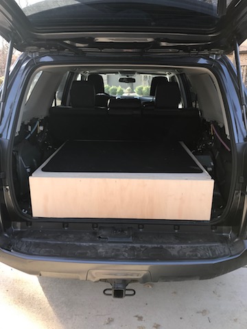

Next comes the Drawer Build. It is made out of 3/4 inch plywood. Overall Dimensions 43 W x 36 D x 10 H.
As you can see, it is as wide and deep as would possibly fit. It is secured using existing mounting points (No modifications to the car itself!) as seen below.

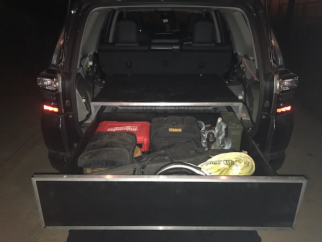

Paint! Gray primer, with spray-on black bedliner topcoat for a durable and grippy surface.

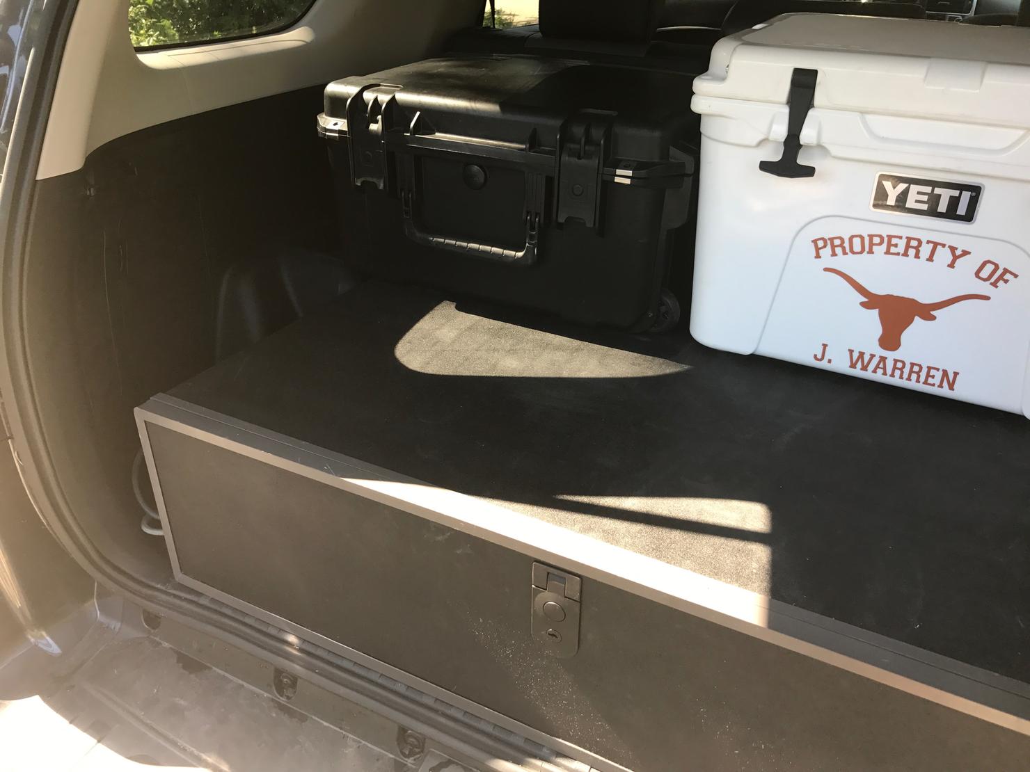

I then installed aluminum trim around the edges, to protect the corners and give a nice finish. I’m still not completely pleased with the fit of the trim, so I am toying with ways to finish it better. Last piece of the drawer is a Southco C5 locking latch that I’m waiting on. Last pics were taken at night, and the drawer is dirty, apologies.

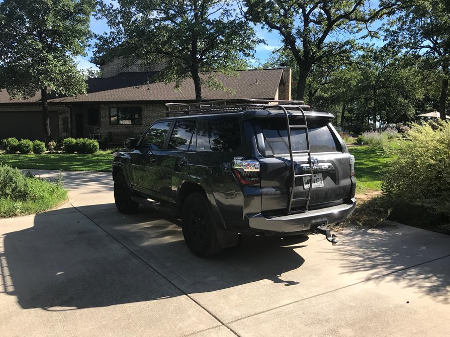

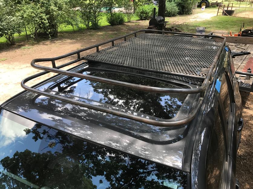

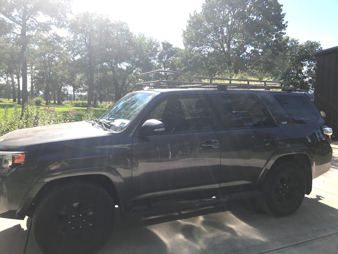

I finally got that Gobi rack! Sort of...
It's safe to say I have wanted a Gobi stealth rack since I got my 4runner, but haven't been ready to shell out that kind of $$$. A few weeks ago, I drew up a rack very similar to the gobi stealth, and priced materials.
Then I decided to just go for it.
Last night I finished fabrication, and I have to say I'm pretty pleased with my first try.
This was a huge learning experience, and a refresher on my poor welding skills, but I'm very happy with what came out of it.
I want to show it off so that others know with some basic tools and skills, you can add some truly custom stuff to your runner at a fraction of the cost of prebuilt pieces.
I'm happy to post more pics of the build process if people are interested.

Did you ever end up supporting the front of that rack?
I have mounting points in place for front feet if I want them. I may build some in the future, adjustable and adhesive/pressure only, no drilling (like Gobi). For now though, the rack is plenty stiff, and since I wont be putting much, if any weight on the front section of the rack, I'm not too worried for now. I kind of like how it looks without them anyway.
I'm also working on a wind deflector.
