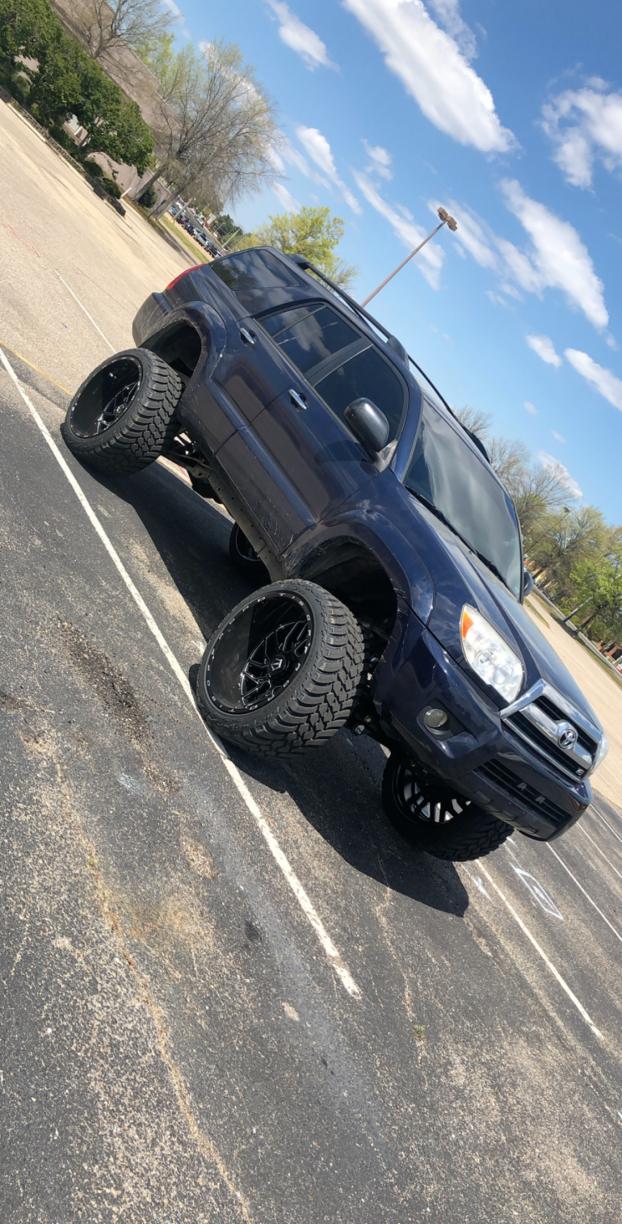

I have a 2006 T4R SR5 V8 2wd, it’s nautical blue and have just over 10 inches of lift front and rear. I was able to fit 35x14r24s with minimal cutting.
Front end:
Rough country drop brackets for a 07-09 FJ Cruiser
Bilstein 0-2.5” adjustable shocks
1.5” body lift from 4Crawler Off-road
Rear end:

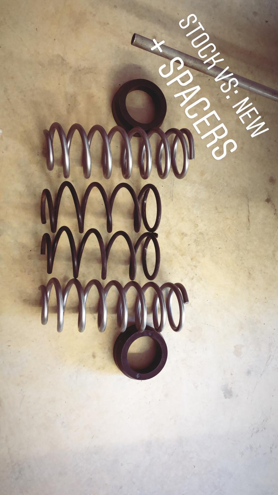

4.5” lift coil spring for a 07-09 FJ Cruiser
1.5” Coil Spring Spacer
I’m also re-gearing my rear diff from a 373 to the Yukon Perfomance 456
I’ll post more pictures as I can take them.

This is definitely not for everyone but it looks mean in my opinion. Lots of guys do this in Hawaii.
I like the color :thumb3:
Not a fan of the donk look on trucks.
Too much wheel and not enough rubber. Bet it rides awful.
That said, glad it's not squatting a bunch and that you used good parts and didn't half ass throw something together. So I can respect the build even if I don't like some of the results.
Next time, take normal pictures so I don't have to cock my head to the side. lol
I'm always worried when tires extend far pass the frame of the vehicle on the highways.
Interesting build though, normally see that kinda wheel look on an escalade
