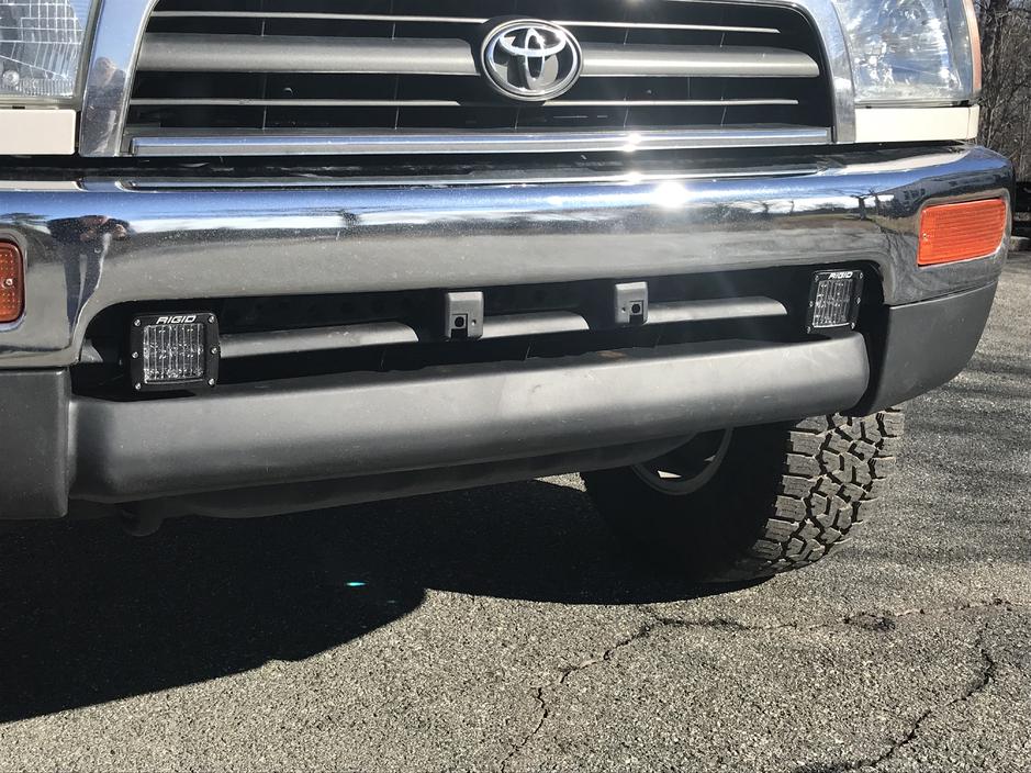

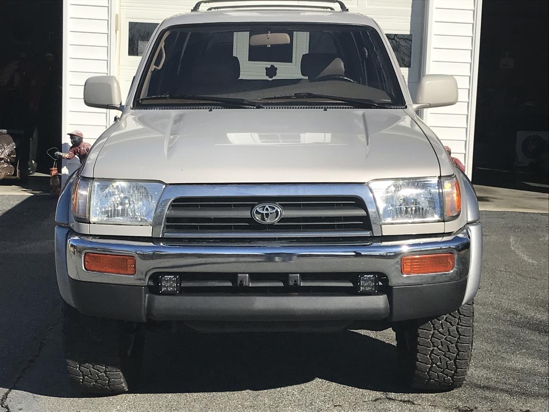

Just installed some Rigid SAE fogs! Very bright!
staypuft
I had the dealer installed Hella fogs in my 97 and they were pretty much useless for light output so I broke down and bought the Rigids and a new lower valance to make the install look a little cleaner. They are very bright and I could get by without even using my headlights if I needed to. The first night out I thing I didn’t have them aimed quite low enough and got bright lighted a few times so today I aimed them down a tad more and will try again tonight. All and all they are badass and I have about $275 wrapped up in the whole job including a better looking (more factory) switch off of Amazon.

The above are the same pattern as my rigids. Low bright and wide. They don’t blind oncoming traffic now that they are aimed right. The first night I had them a little too high and bacically could use them as headlights. Now just waiting on some rain and a trip to work on I485 where I can never see the damn lanes in the rain to really test them out!

[MENTION=78153]staypuft[/MENTION], nice work man. Those look SO good how you installed them, and the pattern is 100% perfect for fog lights!
Really REALLY like how those look on the front of your rig. I can't tell you enough [emoji23] I love em.

Thanks everybody. I like the way they turned out and was going for a factory look. I’m still sore from wrestling around with everything getting it like I wanted. The only issue I have is that it hard to get to the adjustment screws for aiming. I have to take the light all the way out, make small adjustment, put it back in and start again if it’s off. The good thing about it is it’ll make it harder for someone else to get too.
