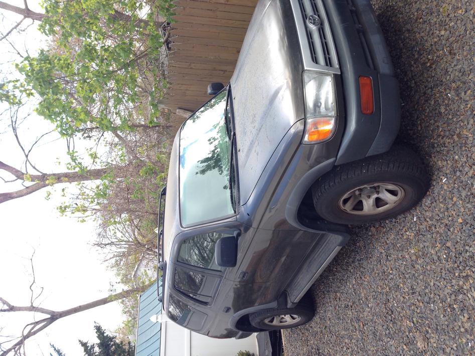

It's an automatic, here is a pic truck is covered with dust previous owner had it sitting in a shed for past year.

If I were you I would put the money to get the maintenance up to date and enjoy it cause the 3rz motors can last a really long time.
