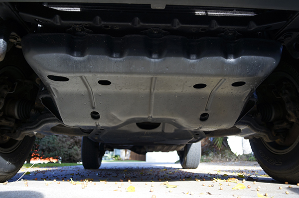

Skid plate scrubbed and repainted:

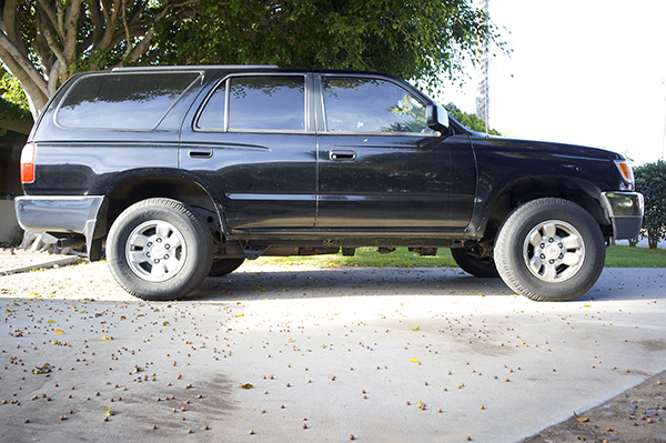

Any how here is the truck as it is now:

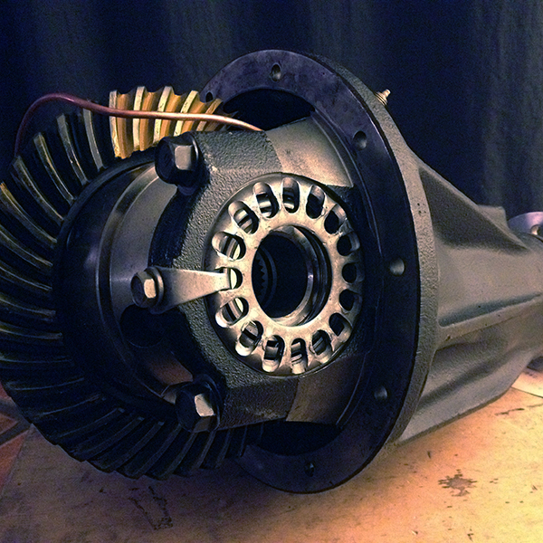

So this came today~
This one goes in tomorrow,
Actually its the second one, the first one I received was for a T100! Woops, a little miscomunication between myself and the salesman.
Fortunatly, East Coast Gear Supply fixed the situation as soon as I called. They are GREAT! Please, if you ever consider regearing or swaping diffs, do so with them. They have been wonderful to do business with.
So, this is the second time I have had the original factory diff removed, ready for the new regeared ARB rear locker diff to go in. At least this time it only took about 2 hours to remove that sucker! (Would have been shorter but I was quite liberal with the RTV the previous time.) All the bolts were already loosened with PB blaster from before, and I knew how to do it. Thanks to all who did write-ups on their process, they were a light in the darkness for me.
Now only the break in time to deal with. Actually looking forward to breaking in the front diff, get to go off road for a couple days and camp! Much more fun than driving around town.
The new gears are 4.56, quite the upgrade from the 3.9 I had in there before. I plan on running 31s and keeping the look pretty close to stock. I have this sinking suspicion that I will end up on 33s tough. We'll see!:pimp:
