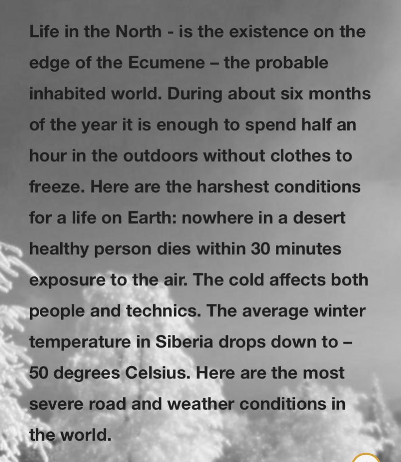

I made the mistake of going down the rabbit hole and reading up on the Siberian bushings website.

The irony is that urethane's achilles heal is extreme cold temperature performance. It becomes brittle and cracks. This is relative to conventional rubber. And the company making them is "Siberian."
