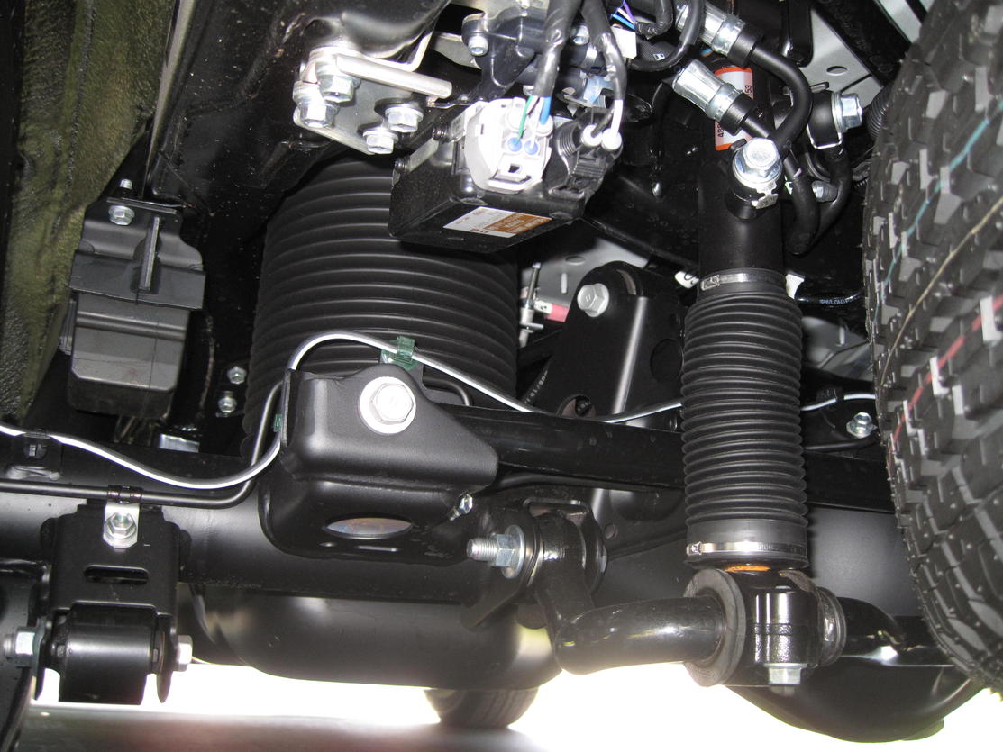

Does it lower the clearance underneath? I have only seen it on my friend's GX470...and it does have parts hanging a little lower than the frame.

here is a pic of the KDSS on my GX
It does NOT really protrude below vehicle more than other components.]
The larger 'bladder' is the air suspension. The KDSS is the thinner bladder attached to the thick sway bar...This is a view of the back, spare tire underneath
Cool...thanks. Not bad at all...how about the front suspension...i remembered seeing that this was lower?????
