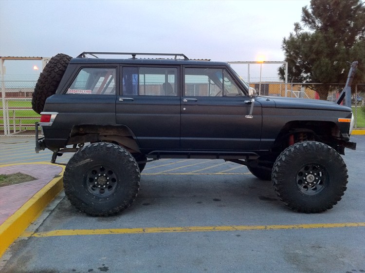

A "bobbed" 3rd gen or 70's to early 80's Jeep Wagoneer.
