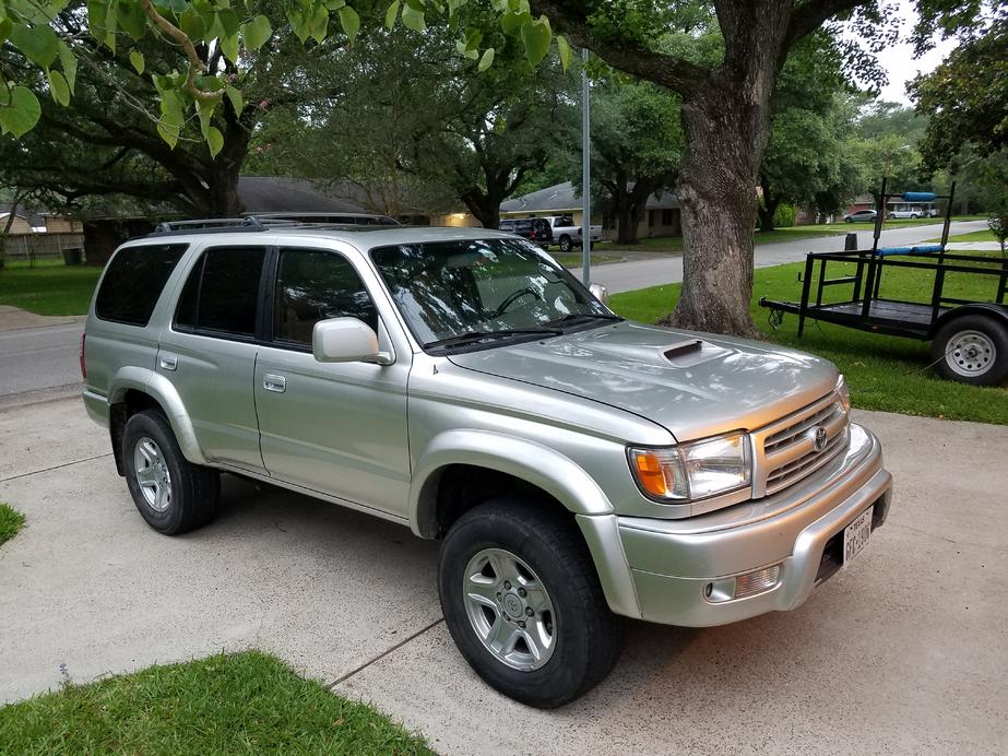

Well I guess I'll post this up as my official build thread for future. I was hellbent on finding an IJM truck (been hardcore looking for over 4 months) but when I came across a 2000 Millennium Silver Highlander edition 4x4 with rear locker and dealer installed 1st gen TRD Supercharger I knew it was a sign. They were asking 5k, which as most of you know is a steal. I figured there would be some issues and there are, but nothing I can't easily handle. It has an oil leak that looks like could be tranny, I just cleaned everything underneath and will see if I can pinpoint exactly where it is. Is is also throwing a code for lean condition, which from what I have read can be fairly common with the SC if there is no additional fuel or tuning done. I'll first try cleaning the MAF and TB too see if that helps. Other than a cracked windshield, a damage hood scoop insert and a few body scratches it's in good shape. Very little to no rust anywhere, frame is superb. Texas car with one owner, I picked it up for $4700. Silver was my 2nd color choice, but I'm sure it will grow on me as it really is a pretty truck. Once I tackle the oil leak and change out all the fluids, LBJ's are next on the list. It has service records that came with it and the radiator was replaced just last year, so I'm good there. I look forward to digging in and making her my own!
is that a colour matched millennium silver front grille??
Yes it is, the previous owner had body work done on the front including front bumper cover and the grille (I have the collision repair paperwork in the service records) so I'm guessing they did it then.
Sent from my SM-G930V using Tapatalk

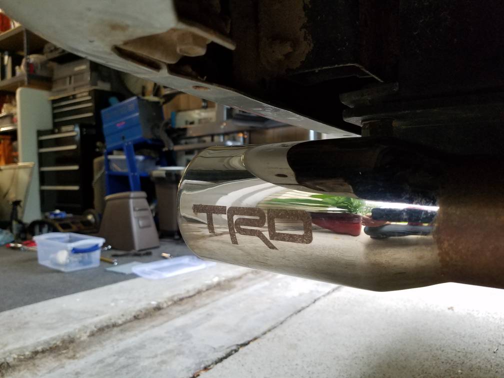

Also I was super happy to see this when cleaning things up:
