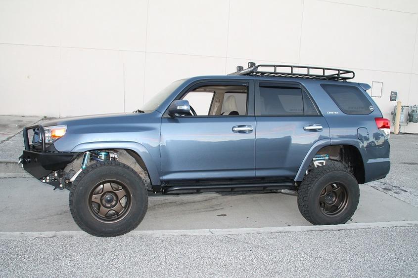

So in my real world experience with my 5980lb behemoth (CAT scale), this set up I have is amazing. I can stick my truck hard into a corner on pavement with confidence and also tackle some whoops on a power line road at 50 mph. I also agree with [MENTION=104049]marshal[/MENTION] about supporting a family business and I'm partial to the name Brett as well. Of course the color matches my Shoreline Blue Pearl so I can still go to the mall. :naughty:
