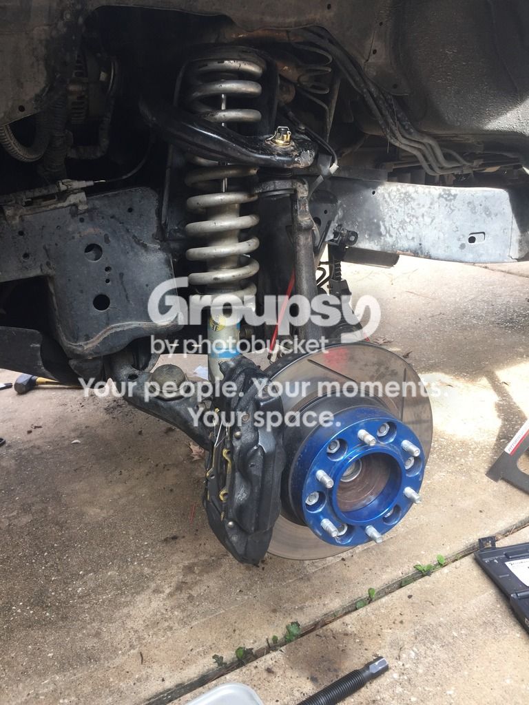

Truck had been pulling to the left severely under hard braking. I had multiple alignments done and the tires rotated/balanced several times to try and narrow it down. I checked the front brakes thinking that a caliper is seized. Bled all the brakes to figure it out, nothing worked. Gave up and took it to Just Brakes so they could throw it on the lift for their free diagnostic. Turns out both lower ball joints were bad as well as the driver upper. Also the passenger rear brake shoes were very worn down. Uneven with the driverside.
So I took it upon myself to install new OEM lower ball joints, Orielly's upper ball joints, and new rear drum brakes/hardware. Got the truck aligned after i was done and she feels completely new. Better than shes ever felt.
