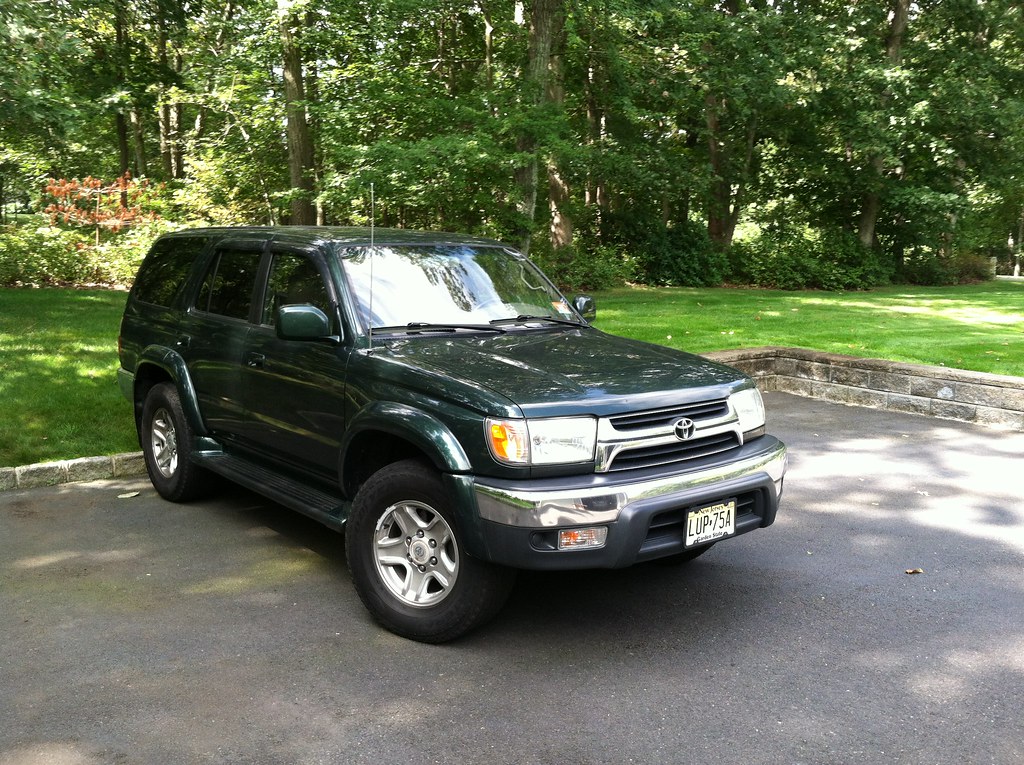

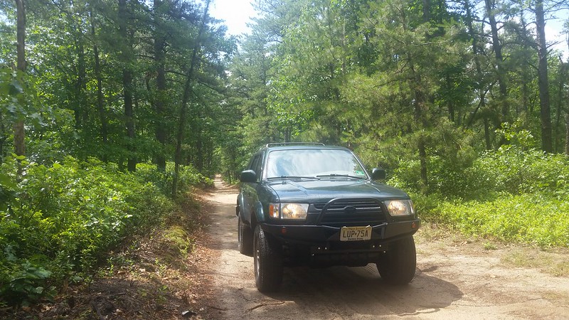

After periodically viewing this site and realizing how reliable and simple these 4Runners are, I decided to buy a 3rd gen 4Runner. Luckily for me I bought my moms, who bought it brand new back in 2001. I've been riding in this 4Runner since I was 8 years old, now it's mine. The purpose of this 4Runner is currently a daily driver and occasional offroader, but one day to become a second vehicle that will take me on adventures.
Current picture 9/2/2018

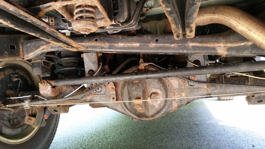

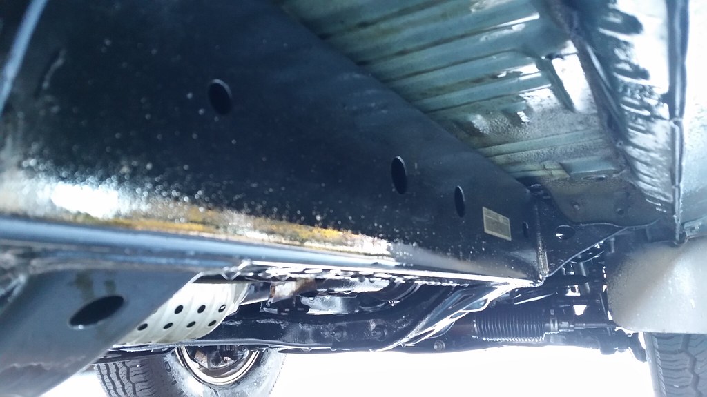

Undercarriage Clean Up

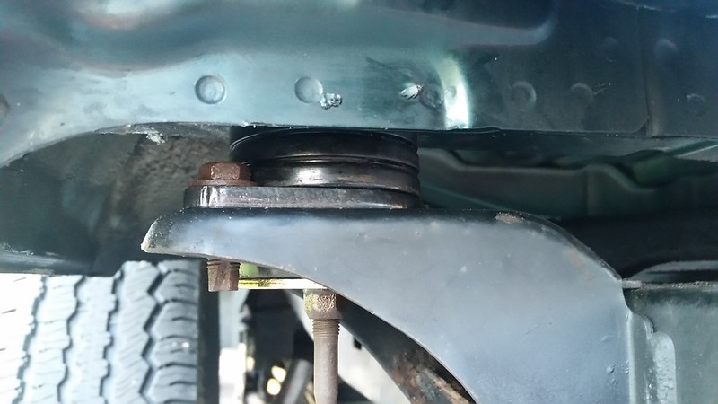

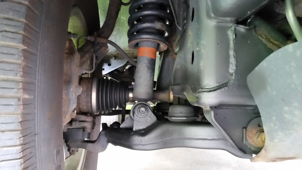

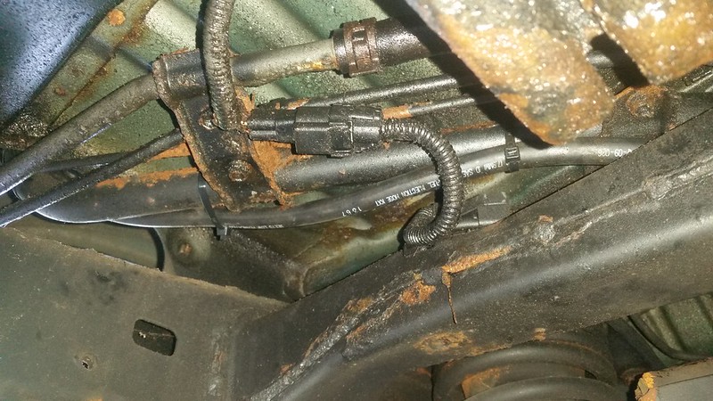

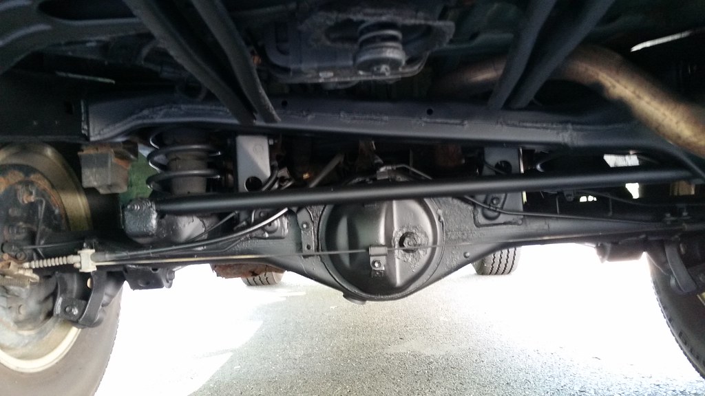

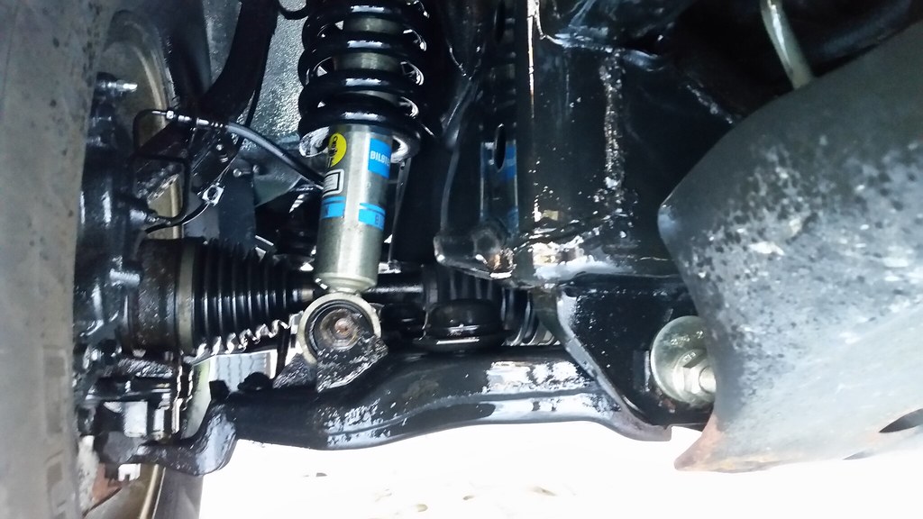

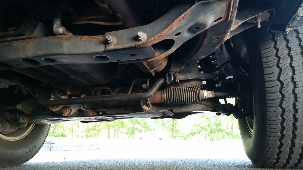

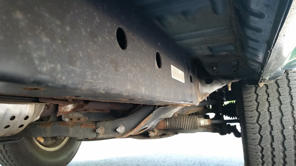

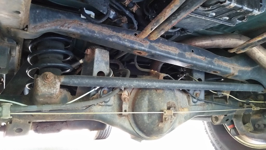

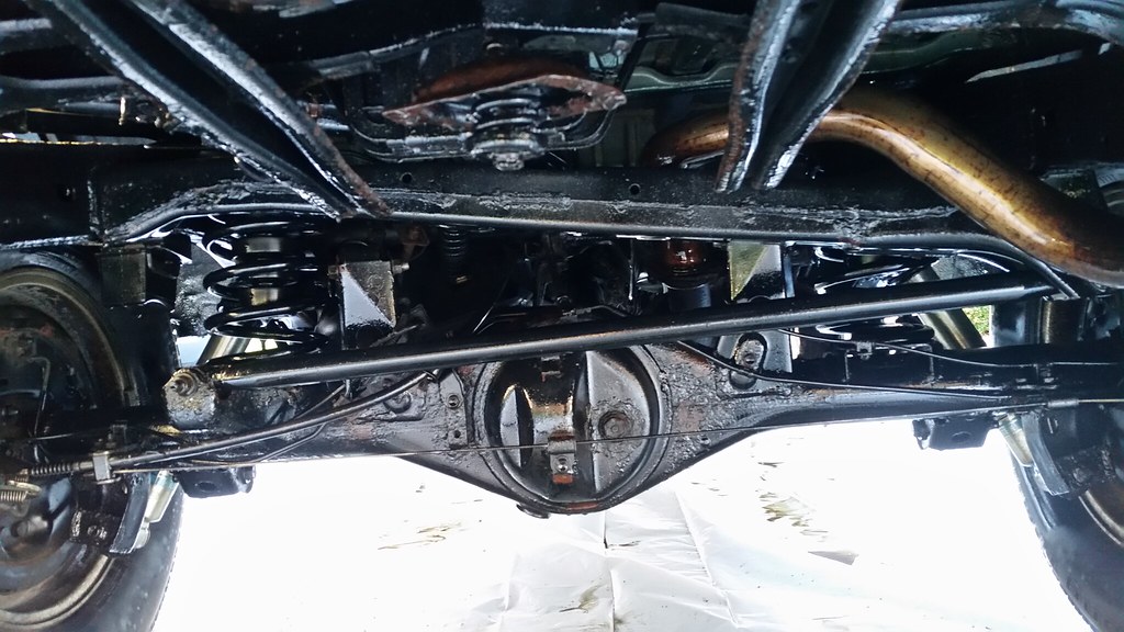

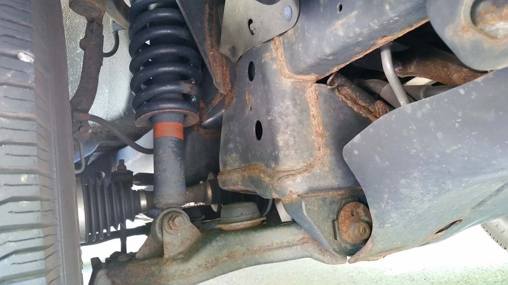

To sum things up, I really hate rust. The 4Runner was garaged kept its entire life up until 2013, then got kicked outside to park to allow new cars in the garage. Thankfully it had car washes in the winter and wasn't too neglected so the rust on this NJ 4Runner isn't too bad. The pictures were all taken about 2 years ago (2015) and now I only have to touch up spots here and there. I oil spray the whole undercarriage before every winter and it has been holding up great.
What I started with.
20150524_174622 by Kyle Murtha, on Flickr
20150523_150450 by Kyle Murtha, on Flickr
20150523_150300 by Kyle Murtha, on Flickr
20150523_150245 by Kyle Murtha, on Flickr
Wire wheeling.
20150525_085607 by Kyle Murtha, on Flickr
My helper.
20150524_165449 by Kyle Murtha, on Flickr
After a couple coats of primer and Rustoleum paint.
20150526_152508 by Kyle Murtha, on Flickr
20150601_150021 by Kyle Murtha, on Flickr
And finally, some oil.
20161112_152009 by Kyle Murtha, on Flickr
20161112_152213 by Kyle Murtha, on Flickr
20161112_152145 by Kyle Murtha, on Flickr

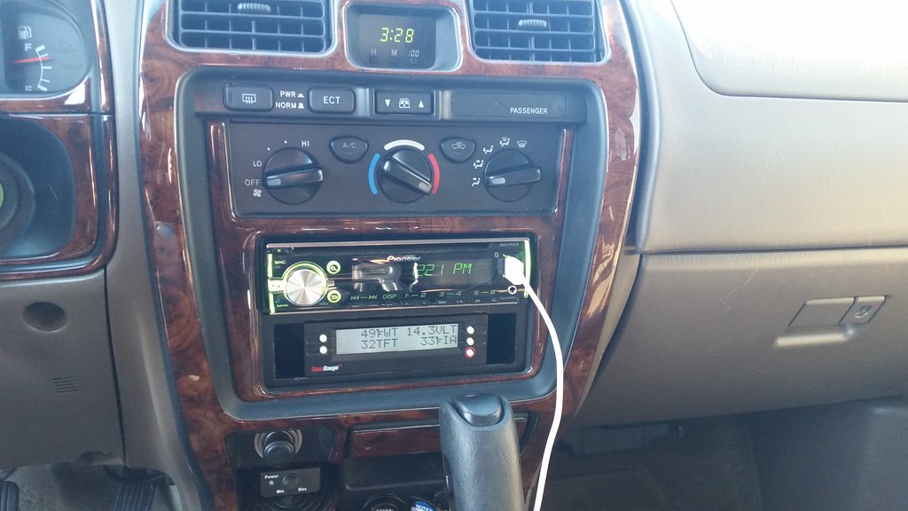

Stereo Upgrade and Scangauge Install

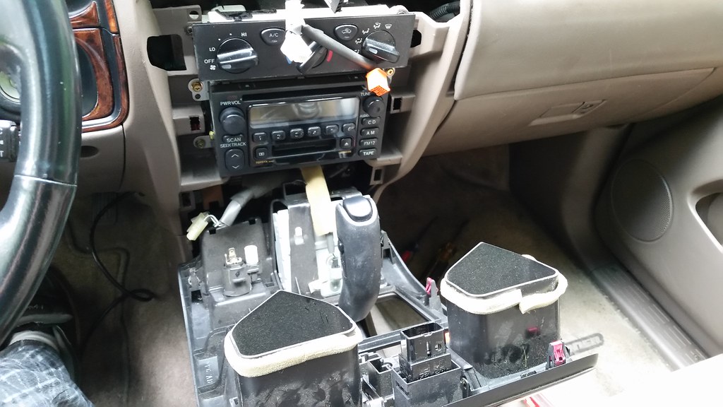

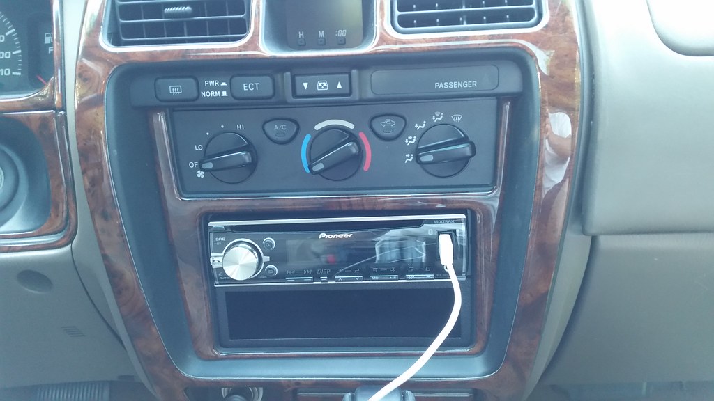

Listening to the stock radio everyday wasn't going to cut it for me. Decided to change the front door speakers, headunit, and add a 12 inch sub. These items are a must for me because I enjoy listening to my music. I had two Ford diesel pickup trucks (7.3's)prior to owning the 4Runner. The Scangauge is one of the best diagnostic tools I've used and they were a must when owning a diesel because monitoring temps are important. Works well in the 4Runner too and is a peace of mid to have.
-Pioneer head unit
-Infinity Primus 6502is front door speakers
-Sound Ordnance M-1500 Amp
-Sound Ordnance 12 inch sub
Out with the old.

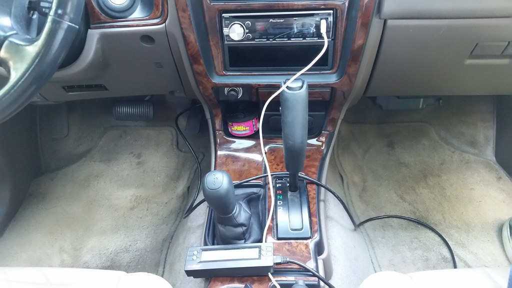

I should have just installed my Scangauge at the same time, but was in a rush. So here is how that setup looked for about a year. Annoying, messy wire.
20150607_184414 by Kyle Murtha, on Flickr
All cleaned up. Minor trimming of the plastic was done to install.
20160213_143848 by Kyle Murtha, on Flickr

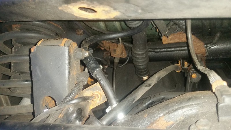

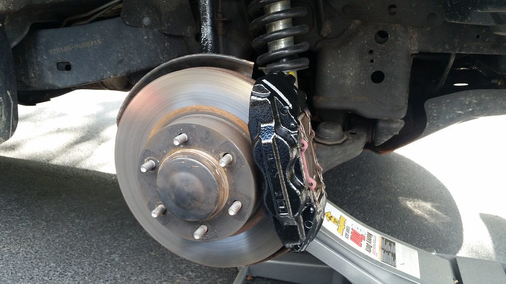

I knew I was going to put on front and rear aftermarket bumpers, so this was a great upgrade to stop all the extra weight. My rear brakes were on their way out and I figured I might as well upgrade my front brakes to the Tundra's and do it all at once. I didn't feel too much of a difference when the Tundra's were on, but once I upgraded the original rubber brake lines to stainless steel, it was a great improvement. I bought the calipers on Rock Auto and everything else is Toyota OEM.
No pics of install, but here they are on. I painted them black.

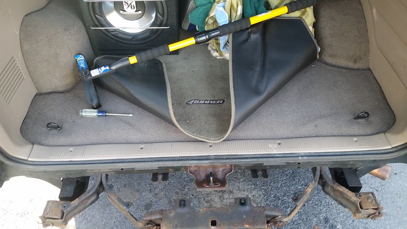

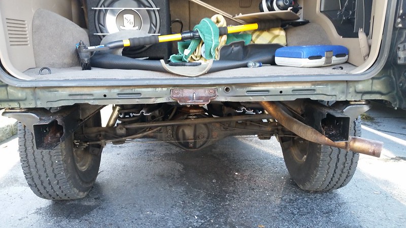

4xInnovations Rear Bumper and Sonoran Steel Body Mounts

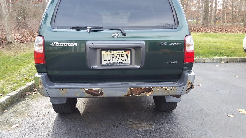

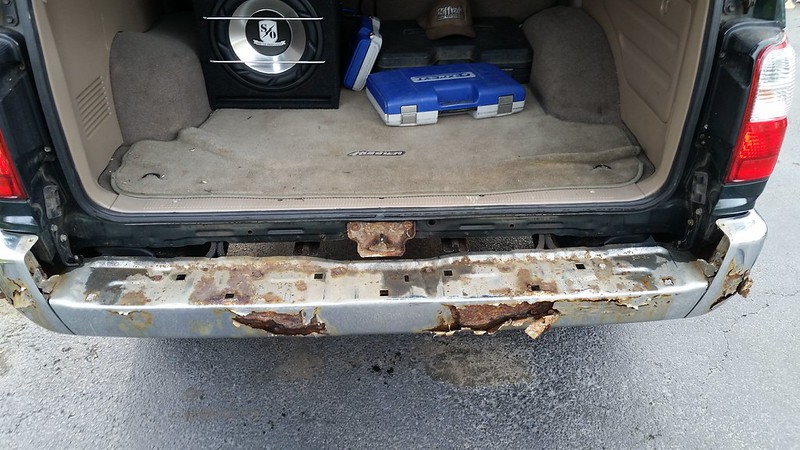

Needless to say, the rear bumper needed to be replaced. Surprisingly only two bolts had to be cut out and the rest came out with the helping of PB Blaster. Install was straight forward but definitely need someone to help lift the bumper. I spray canned with some black spray paint from Tractor Supply (can't remember the brand). Would get it powder coated next time though.
Old. Rusty.
20161221_130823
20161221_131025
20161223_121022
20161225_132138
Sonoran Steel body mounts installed.
20170101_084242
Just need the tire carrier...
20170114_090811
20170114_090958

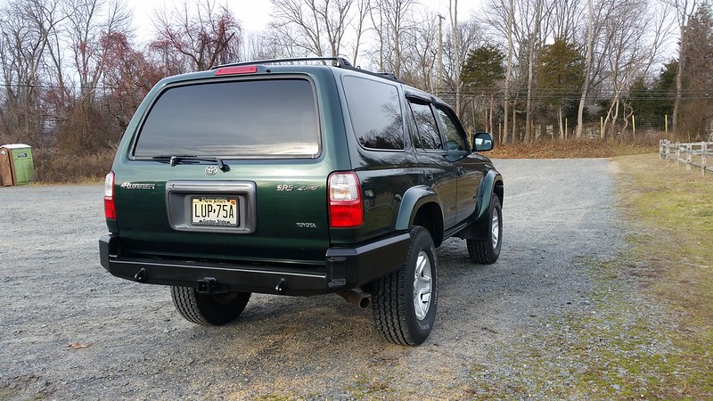

Finished.
20170220_163034

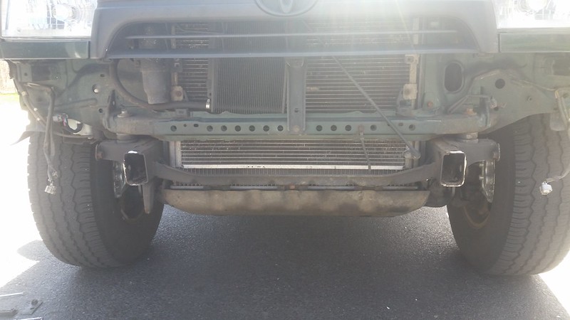

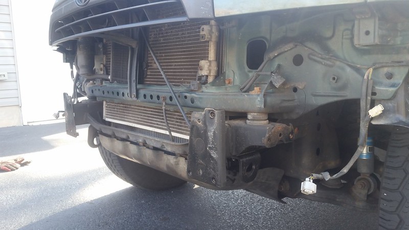

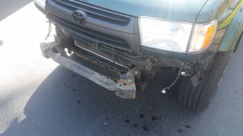

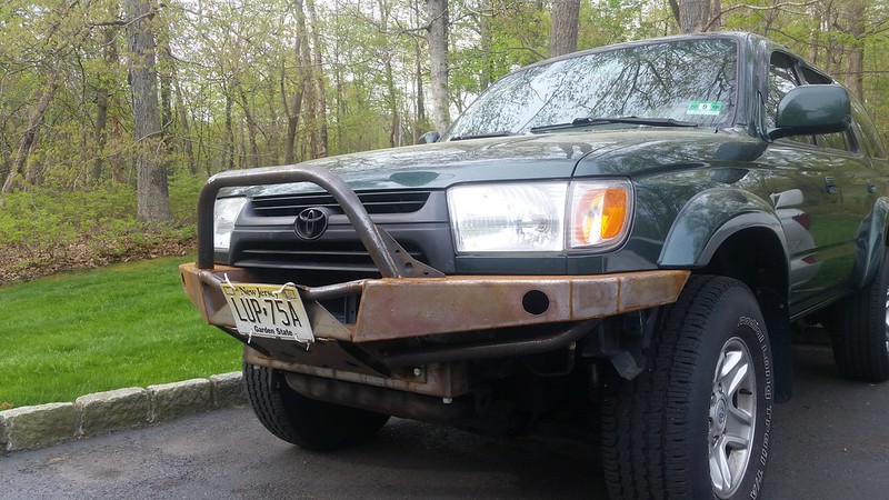

Like the rear, the front bumper had began showing signs of rust. I must have looked at every bumper option for the 3rd Gen's before deciding on Addicted Offroad's front plate bumper. I'll admit I was a little nervous installing it because it required the front end caps to be grinded off, but the finished product was well worth it.
In the process of removing old bumper.
20180422_091248
Grinding time.
20180422_093221
Glad that is over.
20180422_113254
Pre-paint and cutting of fender plastic.
20180507_081307

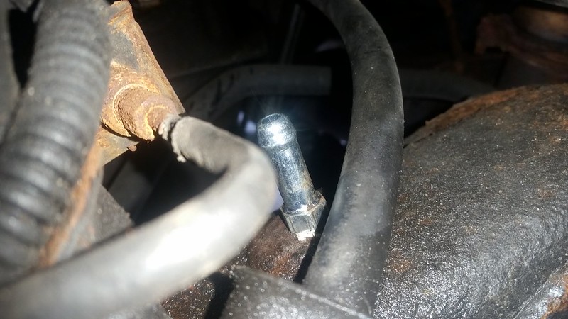

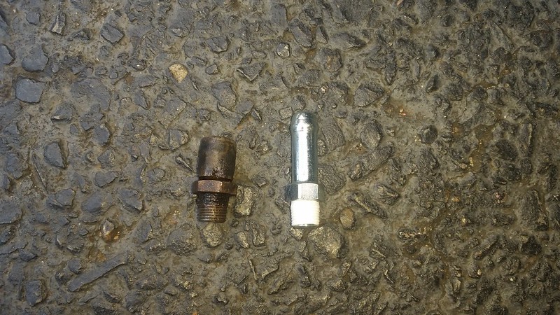

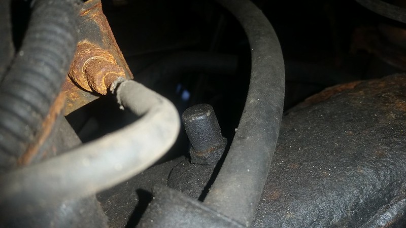

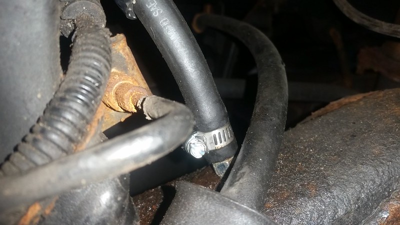

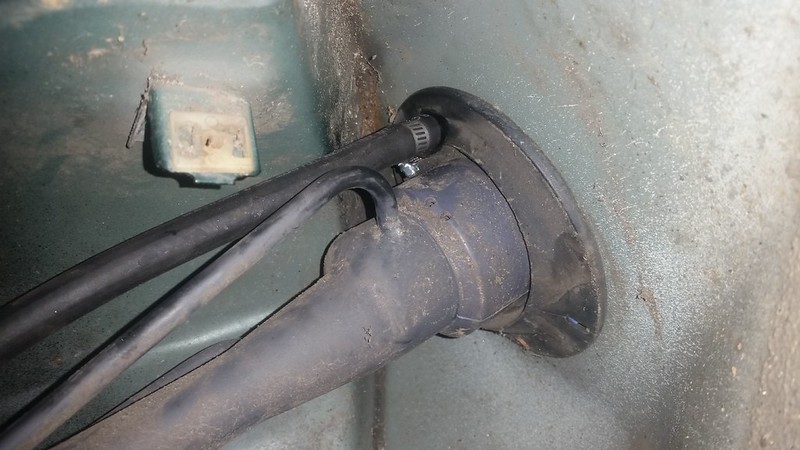

Rear Diff Breather Extended Breather Mod
First off, I need to give credit to [MENTION=120071]mtbtim[/MENTION] youtube channel for helping me with this. It took me a total of 2 hours to do it and will be a peace of mind down the road. Link to video: https://www.youtube.com/watch?v=tCGMa4vng_g&t=909s
Old, but still worked after years of road salt and grime.
20180902_090156
Old next to new.
20180902_092434

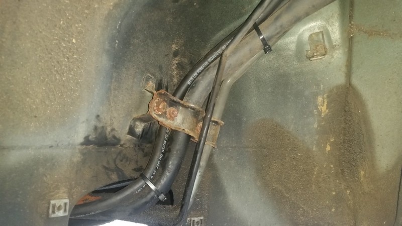

Started from the top, worked my way down.
20180902_094038
20180902_101155
20180902_101206
20180902_111142
20180902_110939
20180902_110925
20180902_110341
