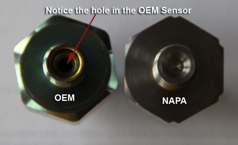

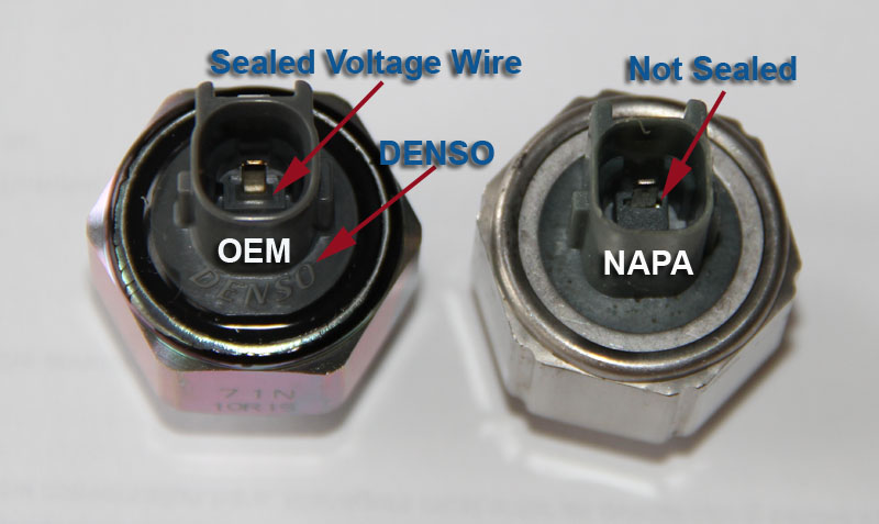

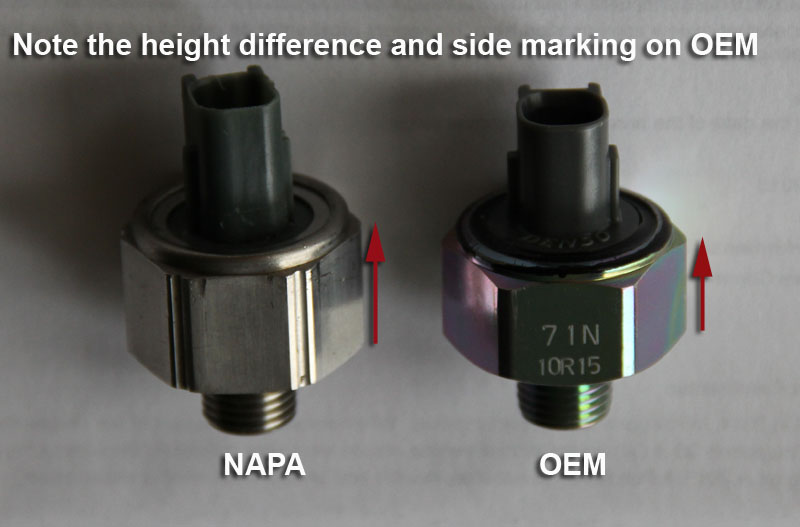

I also threw in a couple pics of an OEM v. a NAPA brand so you can at least see the OEM style. You say you have OEM, but I'm not sure if you remember what they looked like.
