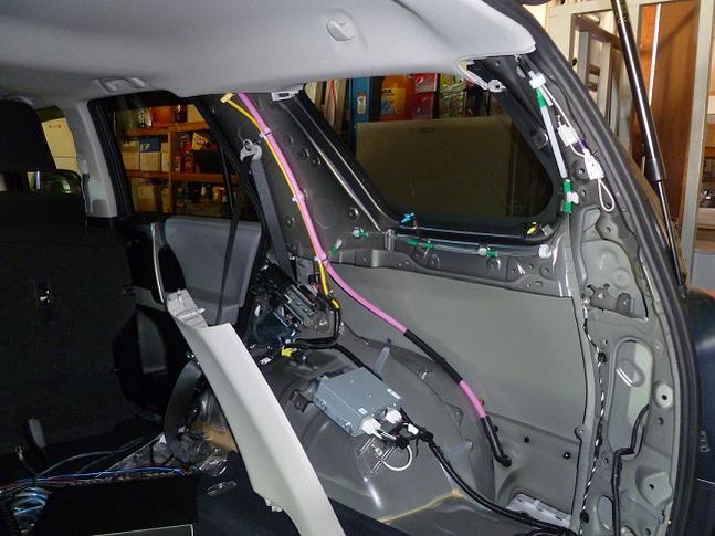

After removing the cargo area side panels and C pillar trim panels I found a tube (~1/2" OD) running from under the head liner on each side, down the C pillars to the back of the wheel wells. There aren't any wires in the tube and I haven't pulled the head liner but these show every indication of being drain tubes.

Yes, it has a sunroof. That might be what it's for but being on both sides makes me think it's for the rack. I'll have to pull the head liner and find the point of origin and see what its connected to.

Here's a pic of the pink tube I'm talking about. The one on the left side has the same routing but is baby blue.

every toyota i've had back to my 90 celica has had drains and they've all had moonroofs so i don't know if they are on the cars without moonroofs
Pour some water in the tracks of your sunroof and see what happens. Doubt if the roof rack is leaking...
Yep, sliding moonroof drains . There are actually 4 of them with two going to the front and 2 to the rear.
