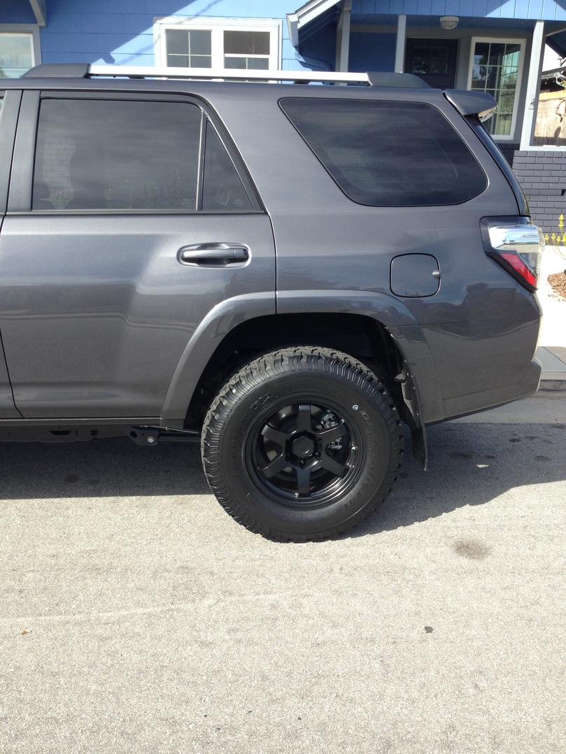

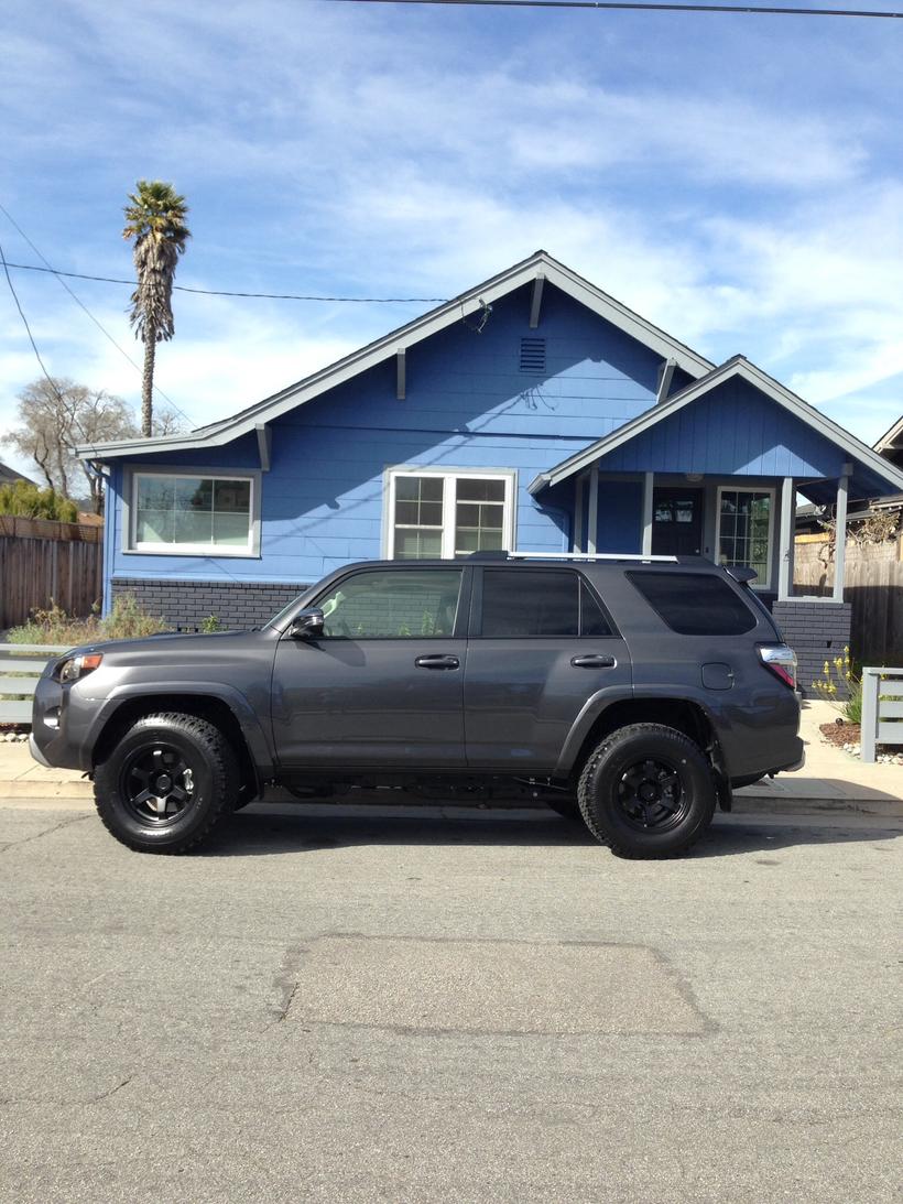

Just got the rims and tires on the 4Runner. Went with 17 inch Konig Six Shooters with BFG AT 275/70/17. Going to put some Bilstiens on in a week or so to level it out.

Looks good, any rubbing because it looks tight in the front. Def needs a leveling in front, if you don't rub now you might after caster set during alignment.
I'm interested in the rub or not with this combination as I have a set of six shooters on order and am trying decide between 265/70/17 and 275/70/17.
There is slight rubbing on the front mud flap. Should go away once its leveled. Could trim or heat gun it but it's so slight it can wait until I put the lift on.

The front doesn't rub at all. The rubbing is on the front mud flap on the inside. Should go away once it's leveled.

So what level are you going run the bilsteins at?
what are you planning on doing for the rear?
I'm up in the air at the moment... Ordered Bilstein 5100 all around, Camburg 1 inch rear spring and Camburg UCA. First thought, 2.5 in the front using the adjustable collar on the Bilsteins and pop in the Camburg spring to raise the rear 1 inch. Or shelve the rear spring and just raise the front 1 inch. Just waiting on the parts to arrive.

The mud flaps on the 2014 have a lot of play in them, push them back towards the body mount and you will see. I just drilled a little hold and zipped tied it back to the body mount. You should be able to screw it tight to the body too. Will give you an extra 1/2 inch of clearance.
