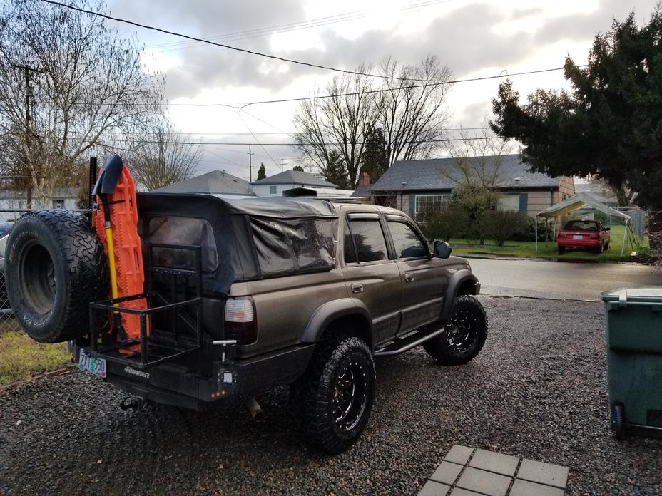

So my new to me 2000 4Runner, Limited 3.4L w/ Auto. Everything but the front of the vehicle has been custom done. My dad(one of the 5 friends I have) has helped me out beyond words since my unfortunate downfall. Ultimate goal is to get me out and see the sights since I am unable to walk more than about 1000 steps...
So here it is with the tires swapped from the 5th Gen..
As it sits now April 3rd 2018
I've crawled around it and already started some swapping of internal components from the 5th to the 3rd, but after lots of medicine and less than 30 minutes my body locks up and won't let me do much more. It's got a few little problems that I will be addressing (paying someone)to fix or father to do it, but it will be a work in progress and I do have the Title!!!
I've been house locked for the last 3 months and haven't gone anywhere, so my first trip out will be this Sunday...nervous but I'm tired of being pent up in the house..

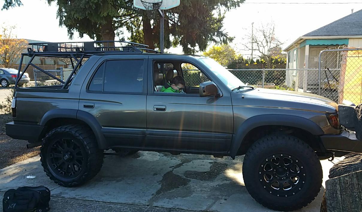

Well I need to re-due the lift due to the stiffness of a spacer lift(had one before the toytec lift in the 5thgen, its stiff) and the fact it just needs to be replaced. I've had an OME, Toytec Ultimate, Toytec Spacer, Revtek Spacer, Toytec Ultimate (tacoma one). Between all of the lifts i've had, the Truck lift was probably the smoothest that I can recall.
I need to find the best lift for comfort now as I unfortunately can't seem to bounce around at all (no more rock crawling or even 'rough rocks' anymore for me). So It looks like for me to get the best ride I have to go with an Icon Stage 3 at least. I would value some of the opinions after reading pages of builds on rides. As you can see from my pictures what you see on it is all its going to get. My trips will be day trips and Hotel Sleeping due to my back/nerves. Can anyone with a very smooth ride chime in on what they have noticed?
My research says to buy Icon, but 3600.00 is a lot. But as I tell my Mechanic(Dad) I have to be able to drive, any hard bumps has long consequences. I know some people may say, well don't go fast or off road, lol. I've done that for a year where I didn't, it doesn't work and i've been house 'locked' for 3 months and was supposed to go out over Thanksgiving but instead my leg didn't work and I ended up stumbling down some stairs and ripping some ligaments in my left leg (thankfully its an auto =D). I realize I'm rambling (its my medicine), Thank you again and I love reading people's stories/adventures. Lets go Places!!!
$3600 is pricey! IMO buying a la carte is better then the stage advice unless you have alot of $$$. For me getting 2.5 shocks were the biggest priority. My setup cost ~2k for the shocks and rear springs. Only reason I would buy front res icon shocks would be for the clicker ajustment system. Btw I would not rate icons as 'soft'. In fact they can be harsh at times. It is a digressive shock so it get softer only when at speed in the dirt. Something like king might be better for you as they are 'softer' at slower speeds but firm up at speed? Correct me if im wrong here.. Hope this helps. My lift parts are in my signature so you can see what I did.
[MENTION=71420]masphx[/MENTION] is correct. I think a King setup would be best for your uses, but maybe a bit overkill. I'd call Down South Motor Sports and let them know your situation; see what they have to say/recommend. I'd also give Toytec a call for the same reason.
Not sure which wheel/tire setup is going to stick, but I think you'd benefit from a 16" wheel and a C rated tire, or D rated at most.
Nice looking truck, I can partially relate.
Sorry to hear of your circumstances. I got wadded up and lost a truck as well. It happens, hope you make the best of it.
Makes good sense, bigger tire with more sidewall, then keep the tire pressure lower while on dirt. That and a good soft setup and hopefully you can enjoy driving once again.
Yeah I have the duratracs which are a very soft tire and when I go out I always drop the pressure down. Even at 20 they are very soft. I'll give toytec a call along with the other recommendation and look into the KING shocks. I plan to keep the tires exactly the same and the work will be done by my Father(savior and a saint and the touchgest guy I know. He was in the room with me when I woke up from Surgery and found out I couldn't lift or even move from below my arm pits down to my toes, tried to move and couldn't move. I cried but he didn't (I think he's immune) but love him all the same). So continuing on he's got a built to the hilt rig and we would like to do 'gentle' exploration trails but gotta be , better than the spacer/plastic lift...

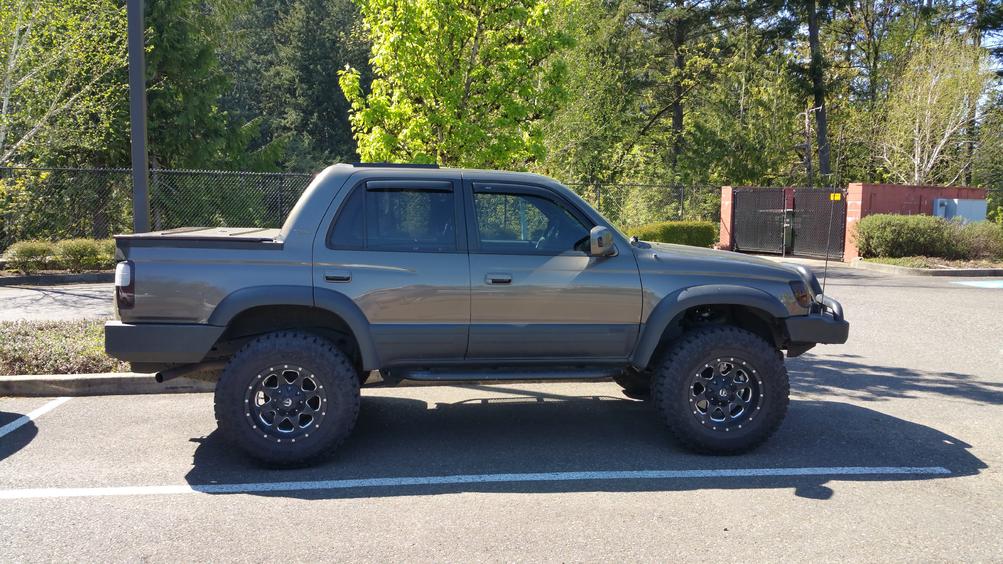

Before I got served my ..spacer lift in my 4Runner was being to hard on my body and I scored a Toytec Ultimate superflex lift for 1440 installed(includes everything but new Upper a-arms). Get's installed on Friday and hopefully I can go over a speed bump at 10 mph versus having to slow down to 5 or less...
I know I will struggle a little more getting in, but I will take it (from my 5th Gen when I did spacer and than to the Toytec Ultimate (such a difference) why I spent my last change from my sock draw...
I'll post pictures after I get it done.
Oh for my Birthday my father made a sweet cover for my bed to keep things dry! (pictures to come)
So lots of research I took my little bit of money I had and got my 4Runner properly lifted/shocks versus hard spacers. Noticed a huge difference and its way softer and I can actually go more than 30 minutes straight without locking up to badly. Here is the final product (also got a cool taneau cover my dad created for my birthday) does wonders and more secure for the few items I put back there.
