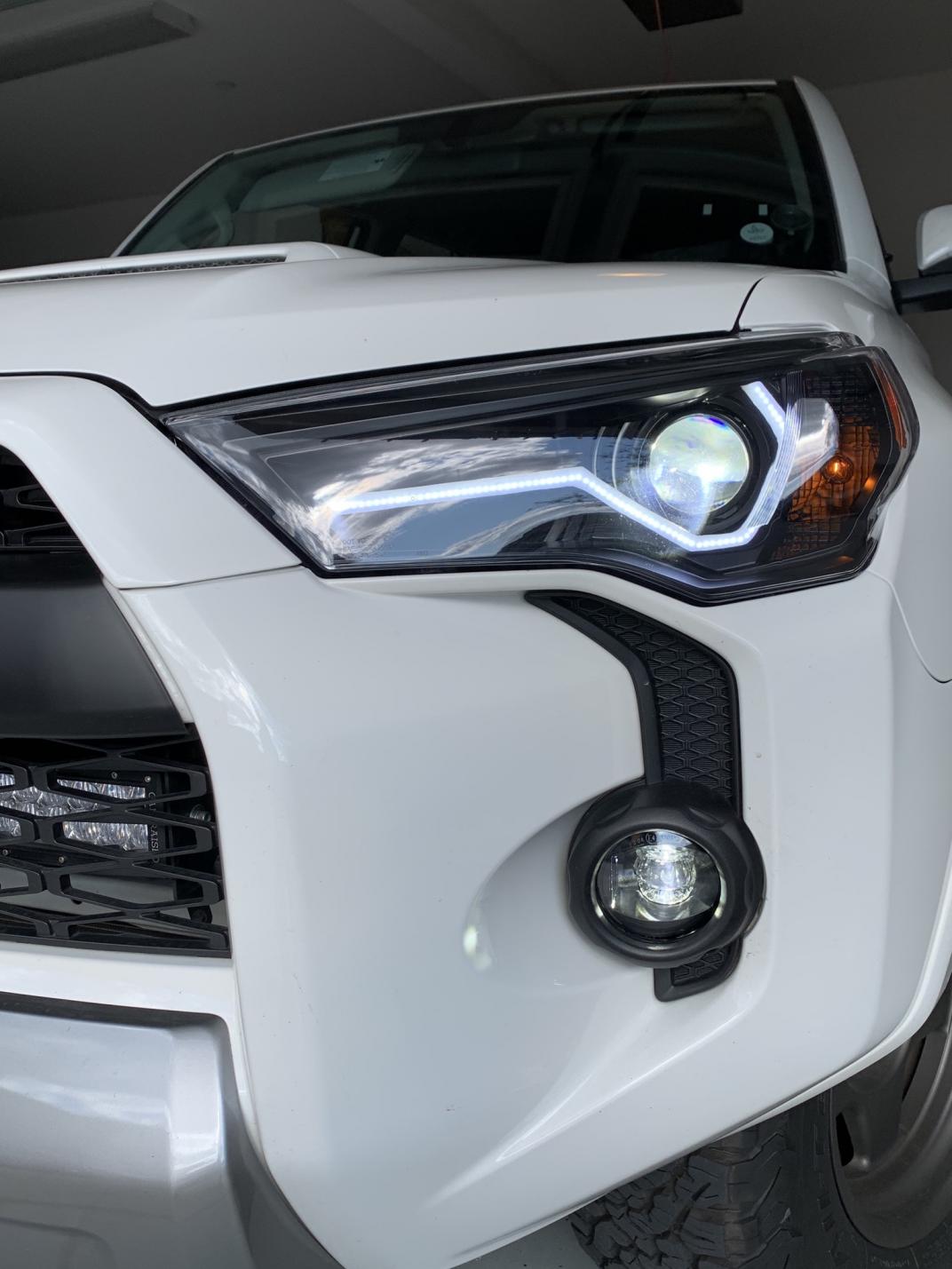

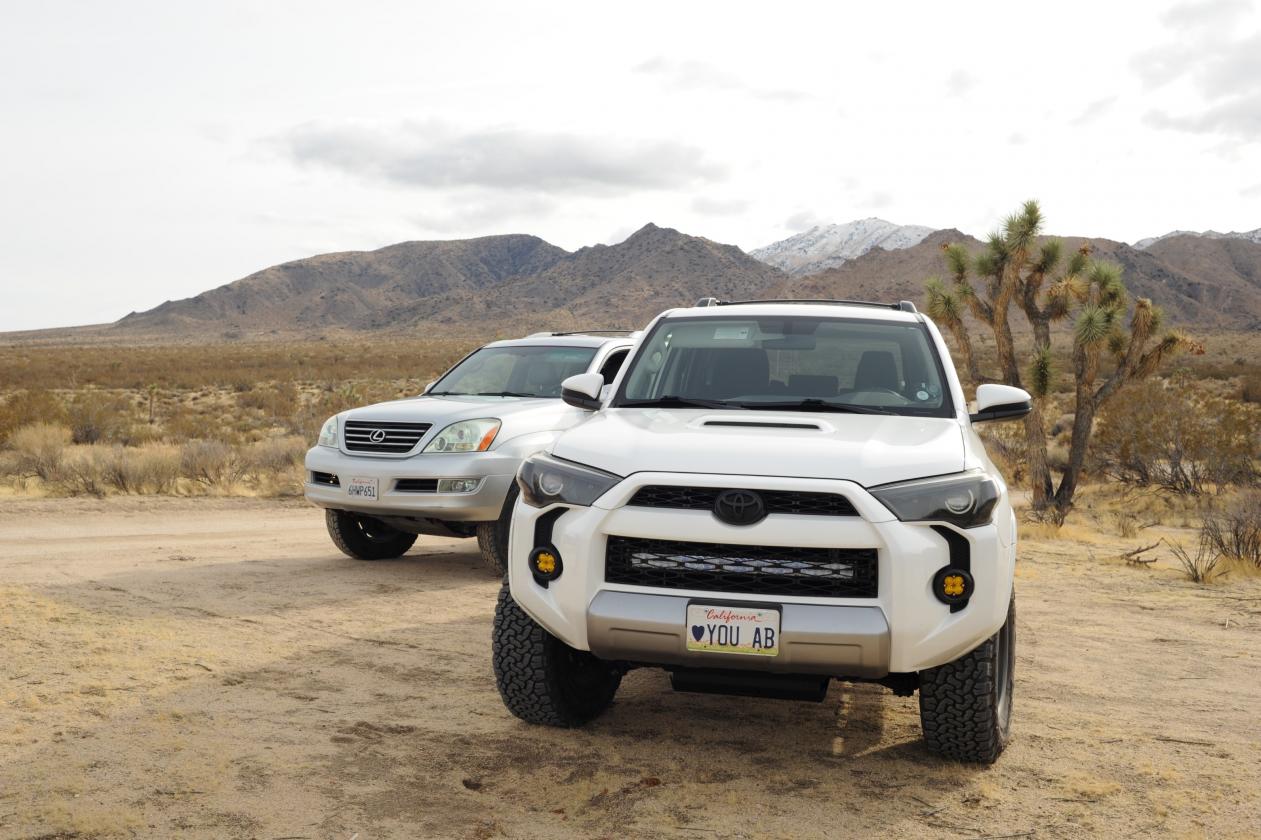

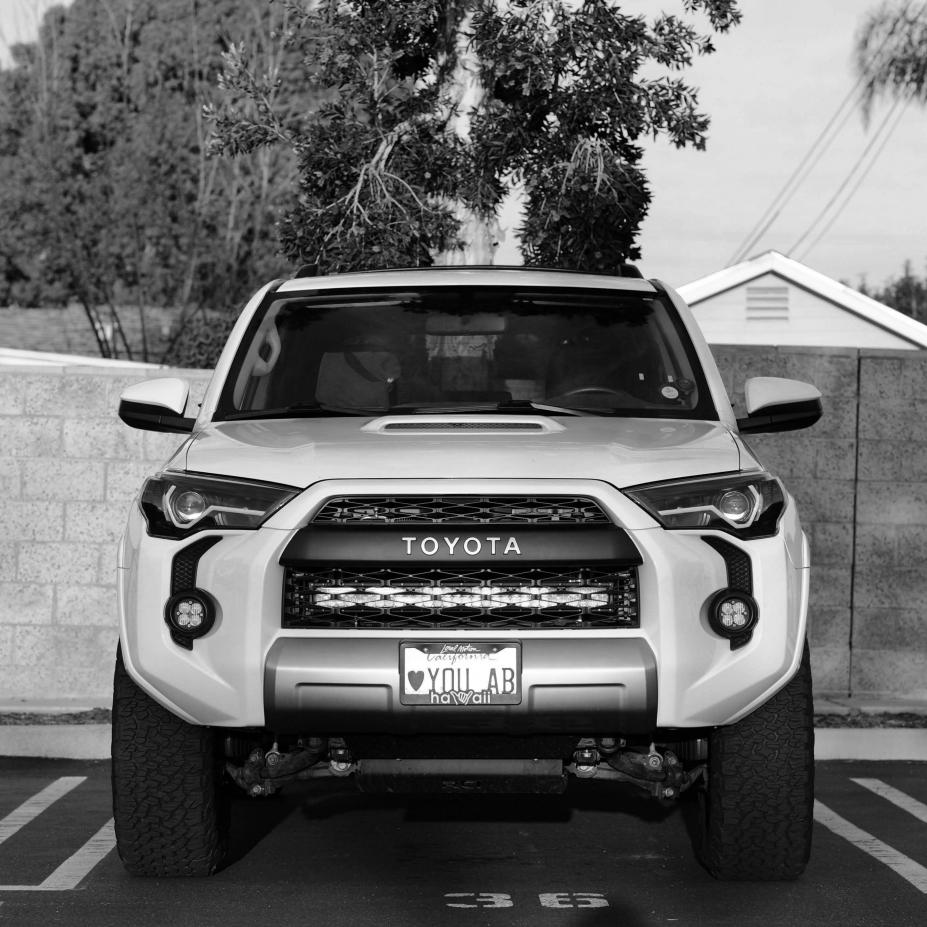

I’m on my second set of Kustom 54 lights. I went from their original Bi-LED retrofits (See first photo) to their AB6’s (second and third photos). I installed the AB’s last weekend and ran into a snag with my high beams not working. I direct messaged Kustom 54 via Instagram and he was able to troubleshoot it for me really fast (Connector polarity wasn’t correct). I was impressed. Oh, and Kustom 54 wiring keeps improving! The original set took more time and patience to wire. The newest versions are such a piece of cake.
I am not a fan of the XB’s or the Alpharex’s either. I think the Kustom 54’s just look way better, and the performance is great with the Morimoto Bi-LEDs. I wouldn’t hesitate to buy from them again.
One thing I don’t really like with the Bi-LED projectors are the two letter M’s they project when the low beams are on. You don’t see them when you’re driving. I just feel they’re a little cheesy, but I’m guessing that’s how Morimoto distinguishes their LEDs.
