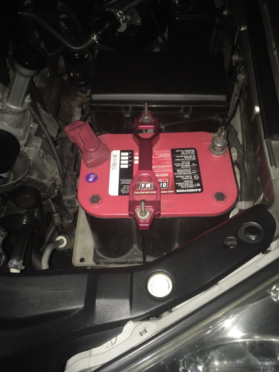

My redtop is a 35 after all, says Red35 on the sticker and if you look near the positive post says 35 there also. No issues with it. Don't remember quite how long I've had it, but it's been at least three years I'd say.

Also Optima 35 with HKB fuse/diode, but only 1 year and 10K miles. Time will tell

i saw an install video or writeup where they say the redtops fit but the battery connections are tight. the ground is tight and the positive is stretched i remember them saying. did you notice that? they said you have to position the battery as far back and towards the edge for them to reach
if i dont just get a traditional 24 or 27 (i know toyota says 27f as option, but there are accunt of those sitting off the lip of the tray i believe) ill grab a redtop or x2 24 agm
It's been a while, but I don't remember the install being anything but straight forward.
It will fit w/out stretching or changing anything. Yes you have to put it far back and towards edge as seen in pics.
