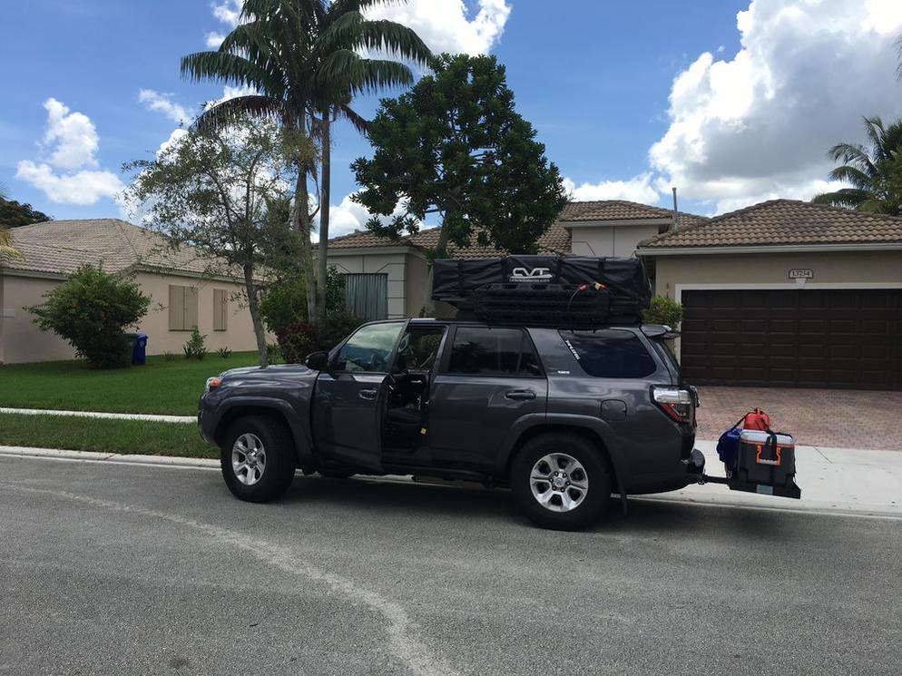

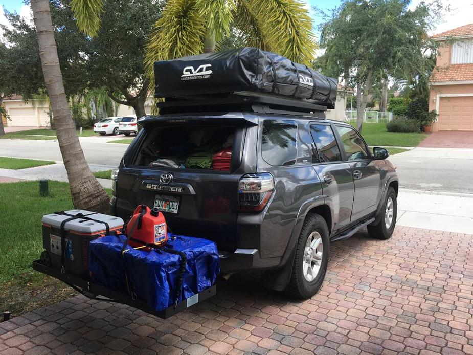

I ran out and bought one on the cheap last minute at Walmart to get some extra cargo space when running away from Hurricane Irma. Honestly not a fan unless necessary. It really loads down the back and kills the departure angles (I was scraping even coming out of steep driveways). The higher end ones may be better but I much prefer the rooftop cargo boxes.
gotcha. scrap that idea of a trailer hitch cargo box.

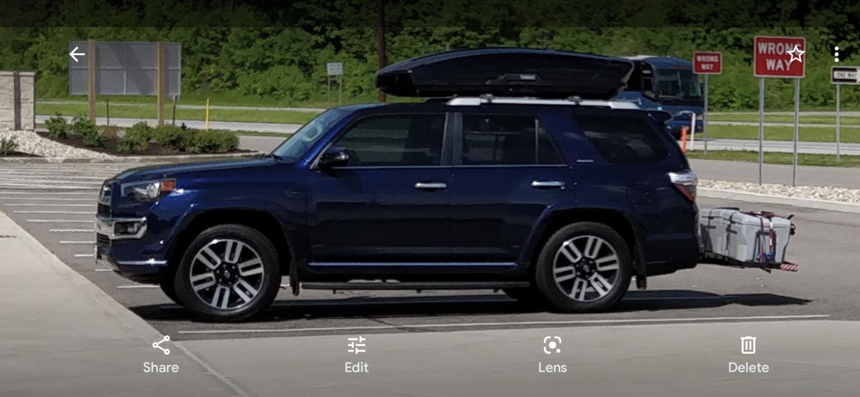

Thule Alpine, extra long box for downhill skies and snowboards. Not the tallest box, but its much more streamlined for the long trips to the hills.

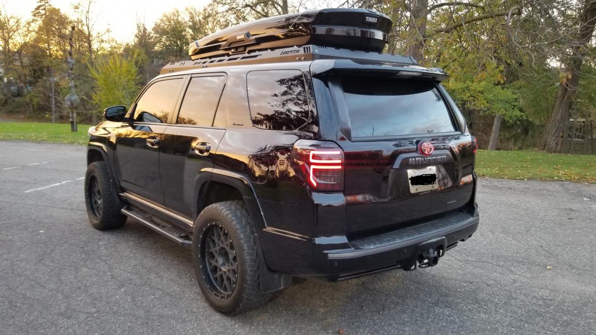

1. With the box installed, are you able to open your tailgate without that spoiler hitting the box? Yes, the box is mounted as far forward as it can be and there are no issues hitting.
2. What crossbars are you using? Stock Toyota? Aftermarket? Do they flex much? Thule 7503B AeroBlade Edge. They are taller and more stiff than the oem bars. They don't move at all. Wind noise is a little noticable but nothing too bad.
3. With that large of a box, I assume you have it mounted pretty far forward. Do you get any flutter at highway speeds? The box moves very slightly up and down but is stable. It partially blocks the moonroof. I have a few thousand miles with it on there and it hasn't fallen off hey.
4. Have your crossbars or the box mounts ever loosened up on you? Nothing has loosened. I leave the bars permanently mounted and take the box on and off when needed.
5. Are you still liking the Motion XT? How’s it held up? Would you buy it again? Holding up fine with no issues. One time I forgot to mount it all the way forward and the spoiler hit the back of it when I opened the truck. No damage to anything. The box works great for extra luggage and camping gear. I'll see if I can attach a picture.

Here's a photo
Hey, Srt4runner, thank you so much for the fast reply, and all the information you provided, as well as the photo, because that’s the first actual profile photo I’ve seen of a 4Runner with the Motion XT XL size mounted.
So, what made you go with the aftermarket crossbars? We’re you afraid that the OEM crossbars wouldn’t be stiff enough, and allow too much movement?
I have read posts on forums where some people have used the factory Toyota crossbars with the Motion XT XL and not reported any issues.
But others have said that the stock Toyota crossbars are too low and not stiff enough, which caused issues such as flutter at highway speeds (since the box has to be mounted so far forward to clear the hatch spoiler when opened), the clamps contacting the roof (because the factory Toyota crossbars are so low), and the aft part of the box making contact with the sharkfin antenna (again, because the factory Toyota crossbars are so low).
It sounds like using aftermarket crossbars may be a way to dodge these problems completely, since they’re stiffer and stronger than the factory Toyota crossbars, and also sit higher.
It’s just that they’re so expensive.
The set you have - the Thule 7503 Aeroblade Edge - isn’t that set around $500 by itself?
I answered more questions in red
