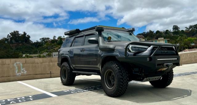

So jus did my first major mod. Which involved taking out the tools. Installed 3" LED Pod Ditch Lights from Lasfit. Have a few steps shown down below. Overall the installation was easy which is great. Hardware and Light housing look of great quality. The styling is awesome in my opinion. I joined the Lasfit SYLE program and was selected to test the ditch lights. I’m posting this thread to share my real experience with the most honest opinion. They also have Awesome customer service. I’m glad I was approached and decided to go with lasfit.

Yup, i'm happy with my lasfit pods, super bright, good construction, and reasonably priced.

Have you had any others in the past that you can compare them too? Curious what the output compares to with the Diode Dynamics product line. Sport or Pro. I have Amber DD Sport fogs and they are great for daily driving, but would want more for a supplemental light. I've also had Rigid Dually pods in the past too and felt they were excellent for the size.
These are $150 right now with brackets which seems insanely cheap, so concerned a bit about quality and output. I've bought some cheaper LEDs in the past as well and they are pretty poor and filled up with moisture.
ErnieArt...I ended up making a bracket for my relays (I added 4). But yeah, those holes in relay bracket a quite small.
I like those Amber lights. Do they give enough light to see compared to white lights? Never used amber for spot/flood lights like that.
i have DD sc2 and DD sc3's on my truck currently, along with the lasfit HD 3inch pods. The only reason I'm running DD products is for the backlight, and thats gimmicky at best.
I think you can't go wrong with either company.
