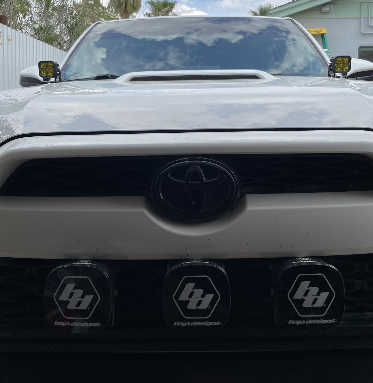

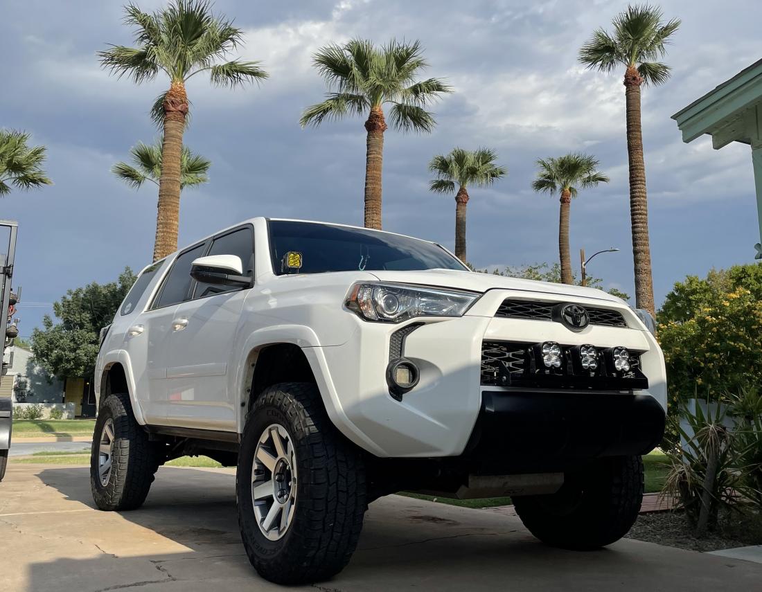

TL;DR: Amber driving optic 36watt ditch lights, pics. Last 2 are how the front end currently sits minus the small S2's behind the grille (THEY ARE NOT RAPTOR LIGHTS lolol), those are now rear facing on the roof rack.

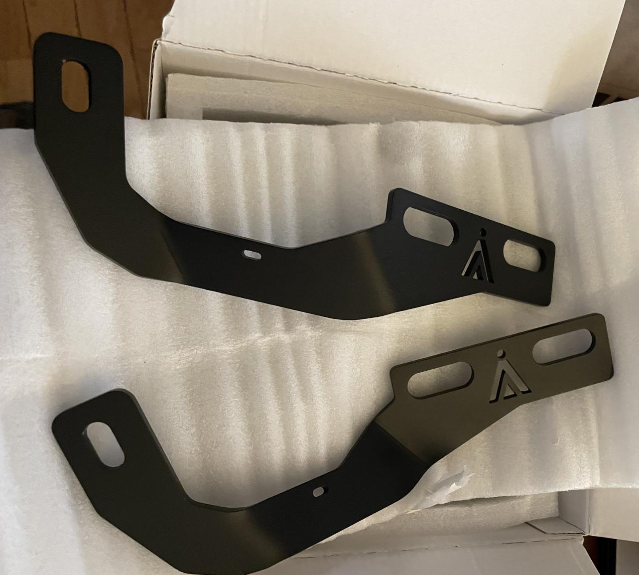

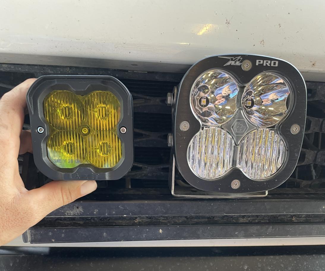

LASFIT gave me the opportunity to test a set of their lights with the A pillar brackets to run as ditch lights on our 4runner. I selected amber lens with the driving optics. I figure I can point them down to the sides if i want, or when doing more go fast stuff I'll point them out a little less and not down. Driving optic should work either way with minimal hot spots like spot pattern would do. And in my experience a "flood" beam is useless.
These are 36 watt lights. I'd love to test them and see how much they actually pull, and measure lumens, but I don't have the equipment, maybe I'll see if crashburn on tacoma world has already done these. (I know he did review one set a while ago, not sure which ones they were from Lasfit)
Shipping was crazy fast, packaging is fantastic, brackets and hardware all seem to be pretty standard for the industry.

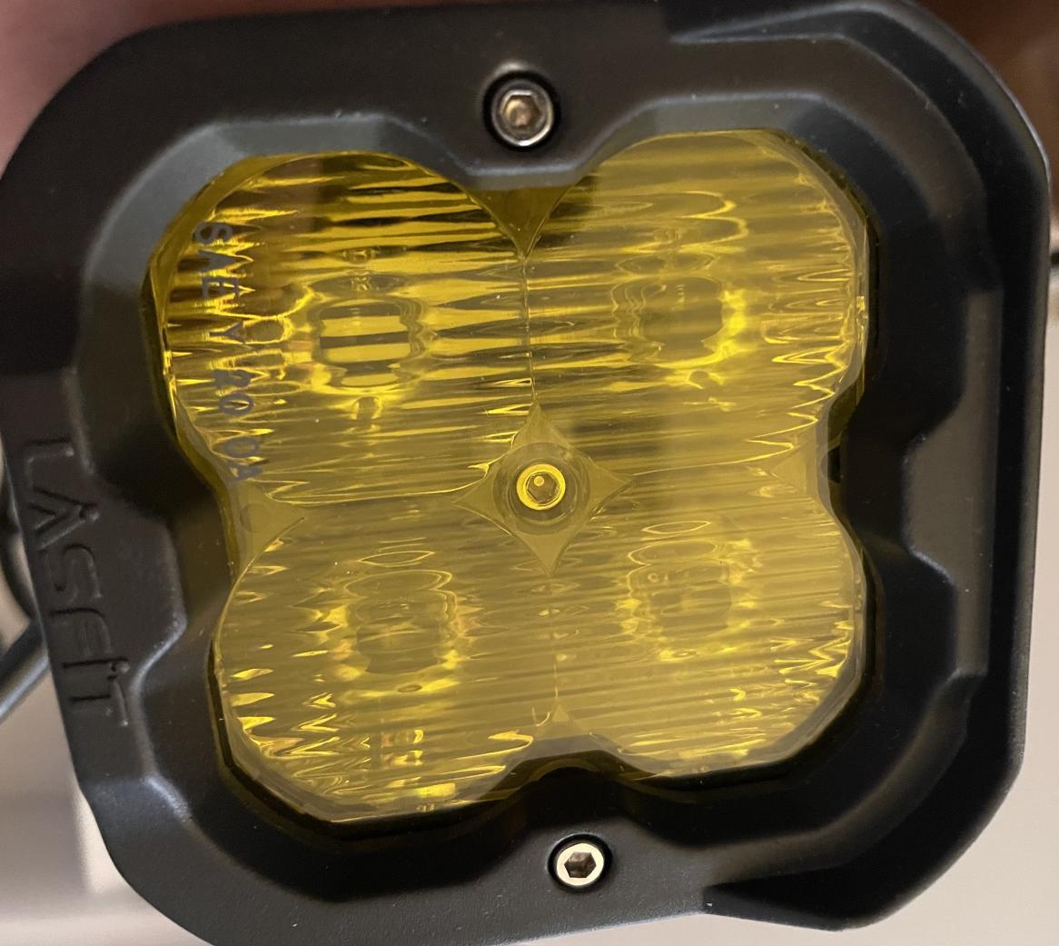

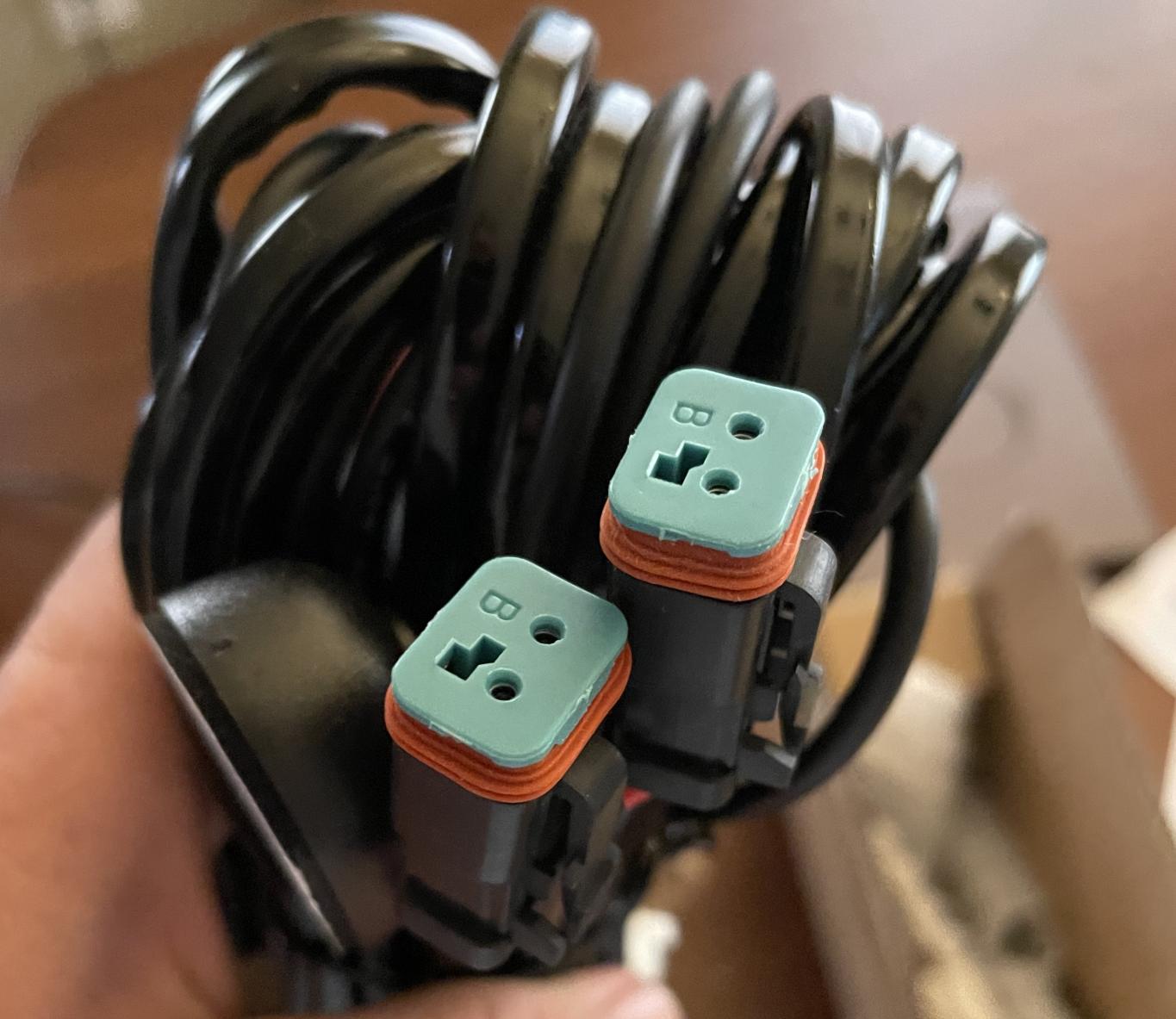

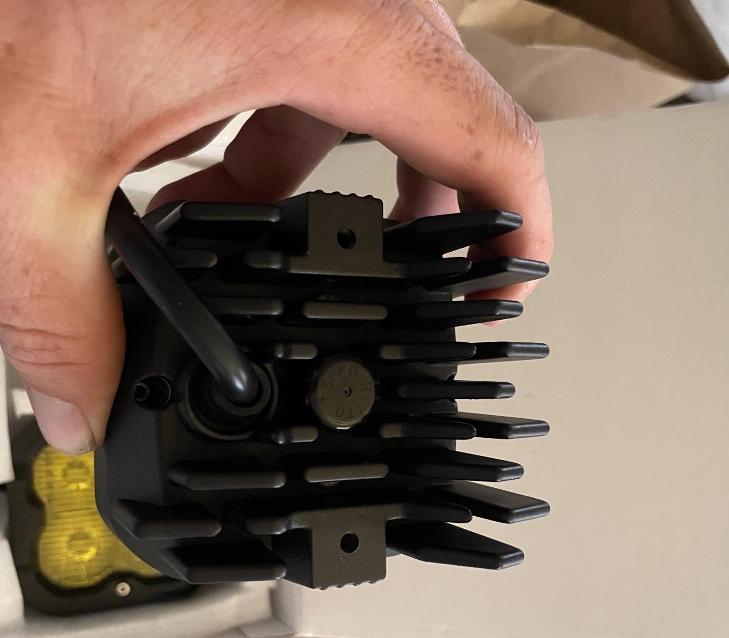

Lights feel solid, they only use 2 screws on the bezel, I'd prefer 4, but if they don't like then that's pointless. So time will tell on that one. I love the Deutsch connectors. standard 2 pin connectors SUCK (TALKING TO YOU BAJA DESIGNS). Heat sink seems pretty deep, but these aren't the fancy machined/billet aluminum like Baja designs. However, there is literally nothing wrong with the housings, and the top "visor" looks pretty cool. (Afterall, that's what this is really about right?) Lasfit website says they are using TIR optics. These have been proven by Diode Dynamics to provide a superior beam pattern. So less spillage, better cutoffs, etc. This should translate to better lighting for onroad use. Offroad use, if you light up the entire desert, thats fantastic, which is what I love about Baja Designs stuff. They just use a ton of power and it's like I have the sun on the front of the 4runner. That being said, I'm pretty curious to see how a lower rated light with modern optics compares to a XL PRO from Baja Designs. (I run 3 of them on the runner bumper)
Unboxing pics....I plan to install tonight so I will update after that. [MENTION=675931]lasfit[/MENTION]

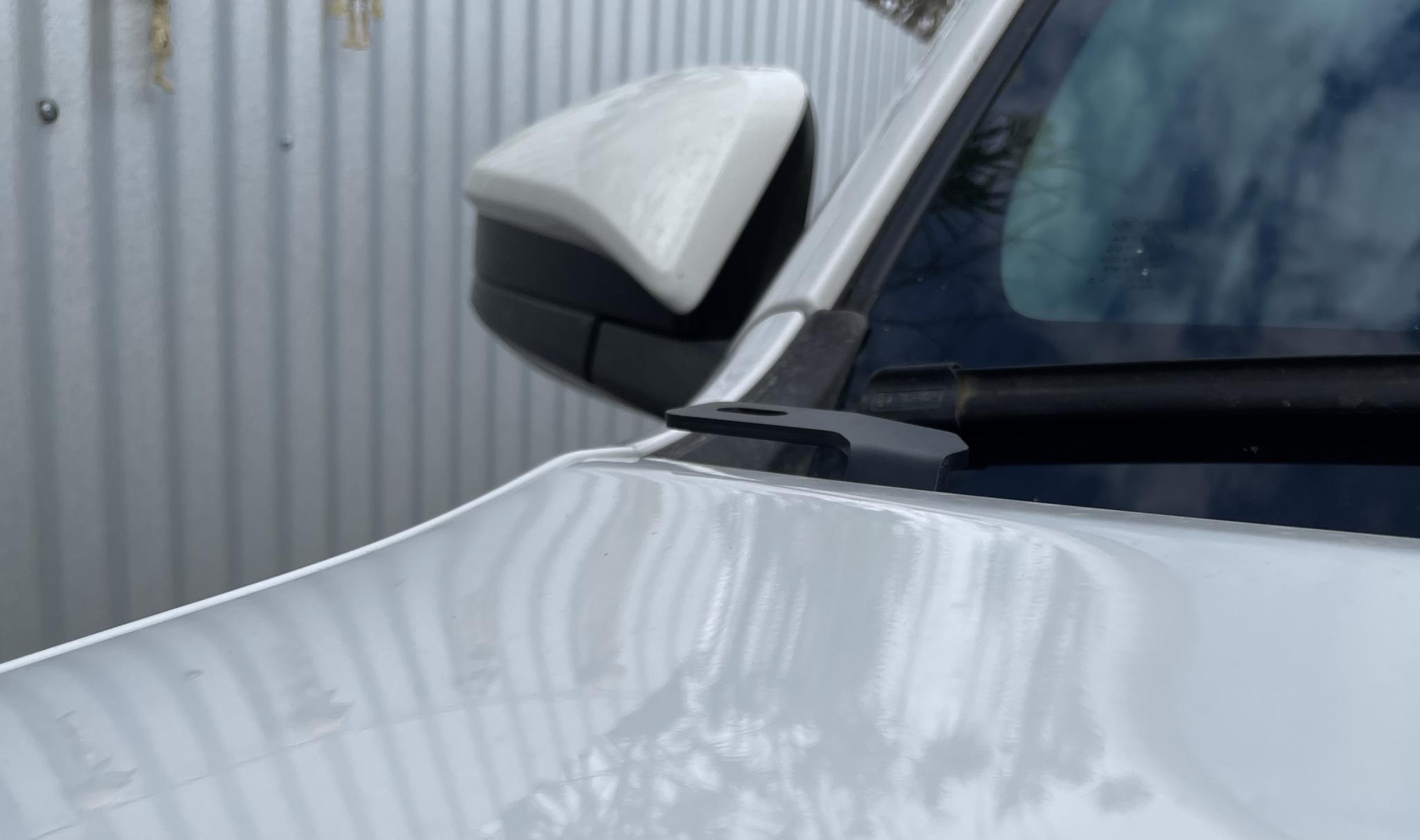

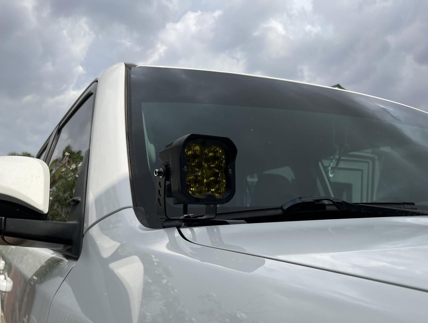

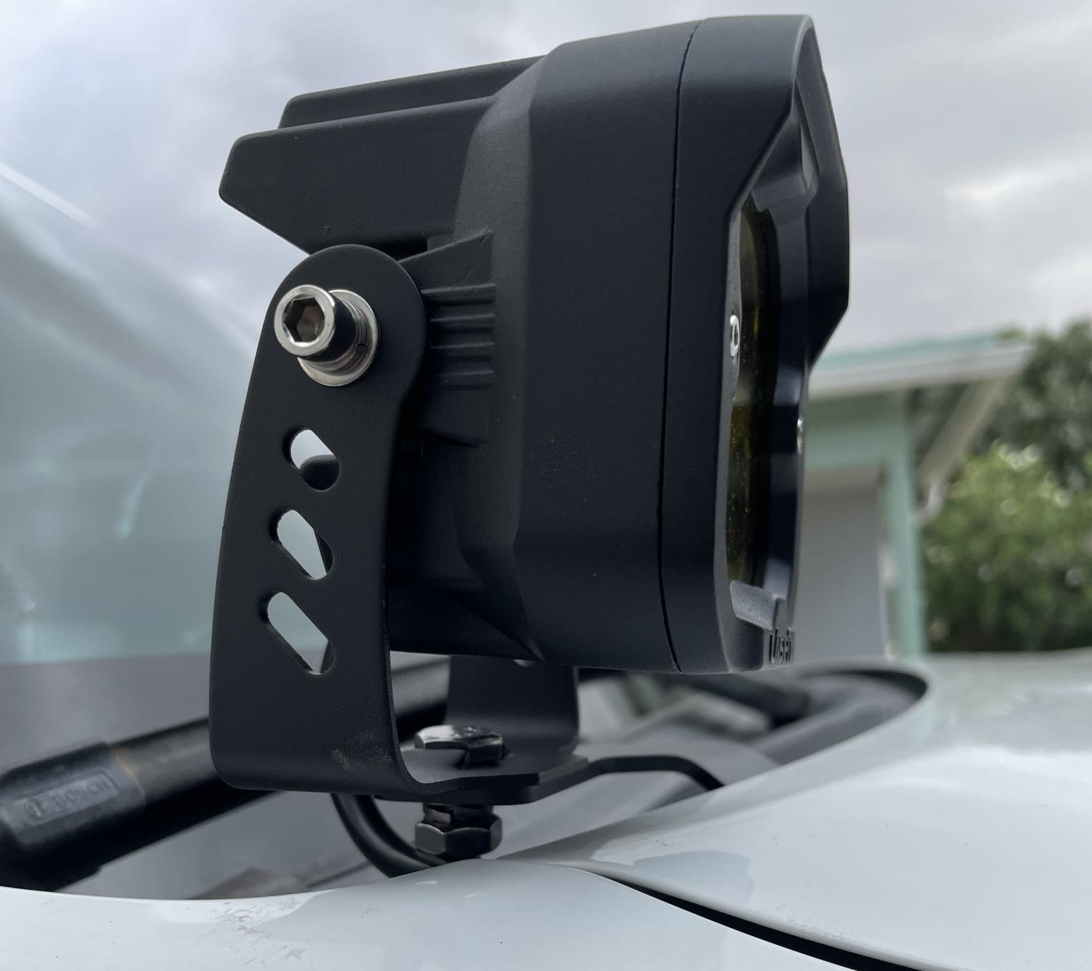

alright update on the hardware: IMO ditch the allen head bolts. Theyre always soft, and always end up stripping when you tighten them down with an allen key. A stainless hex head will look much better as its lower profile.
There are 4 bolts holding the bezel to the body, it's just 2 of them come in from the back side.

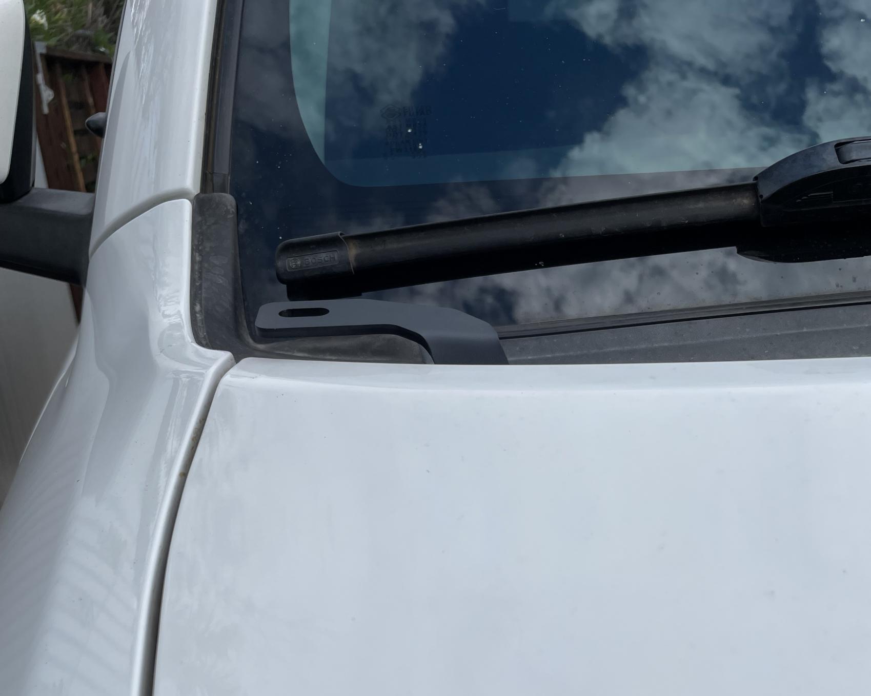

I Kinda wish the a pillar mount went a another 1" or 2" towards the outside of the car, it'd minimize the view of the lights from inside the car. I get why they sit where they are though, theyre tucked in to the body when looking at them from the outside.
The light mount itself could be a bit shorter so the light would side lower, and the one main bolt holding it down doesnt need to be that long.

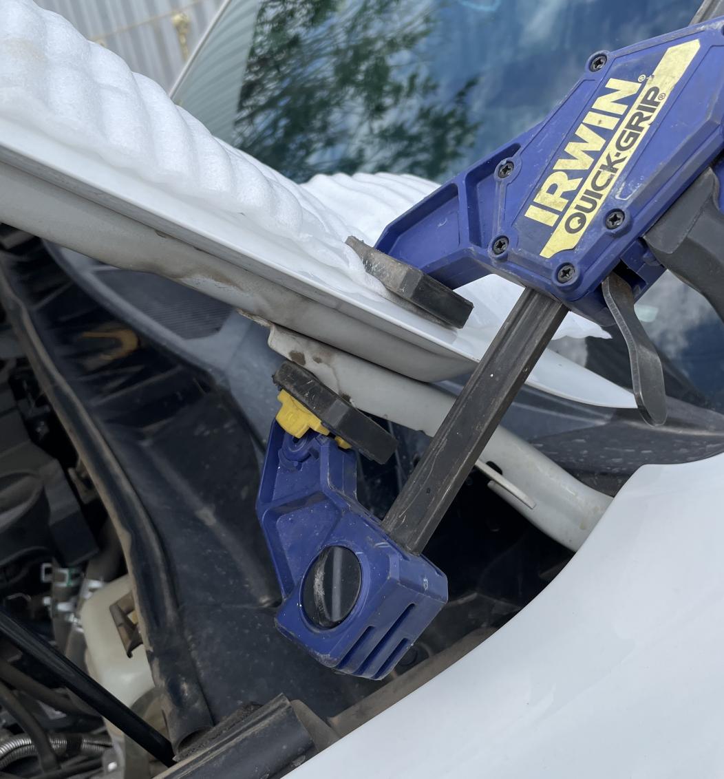

Install was super easy. I understand why so many people run these kits from other companies. I used a clamp to hold the hood and did one side at a time. Wiring is universal, so there is A TON of extra slack. one of these days i'll trim it back

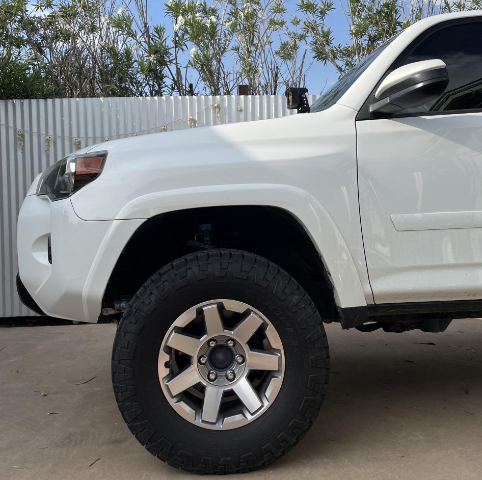

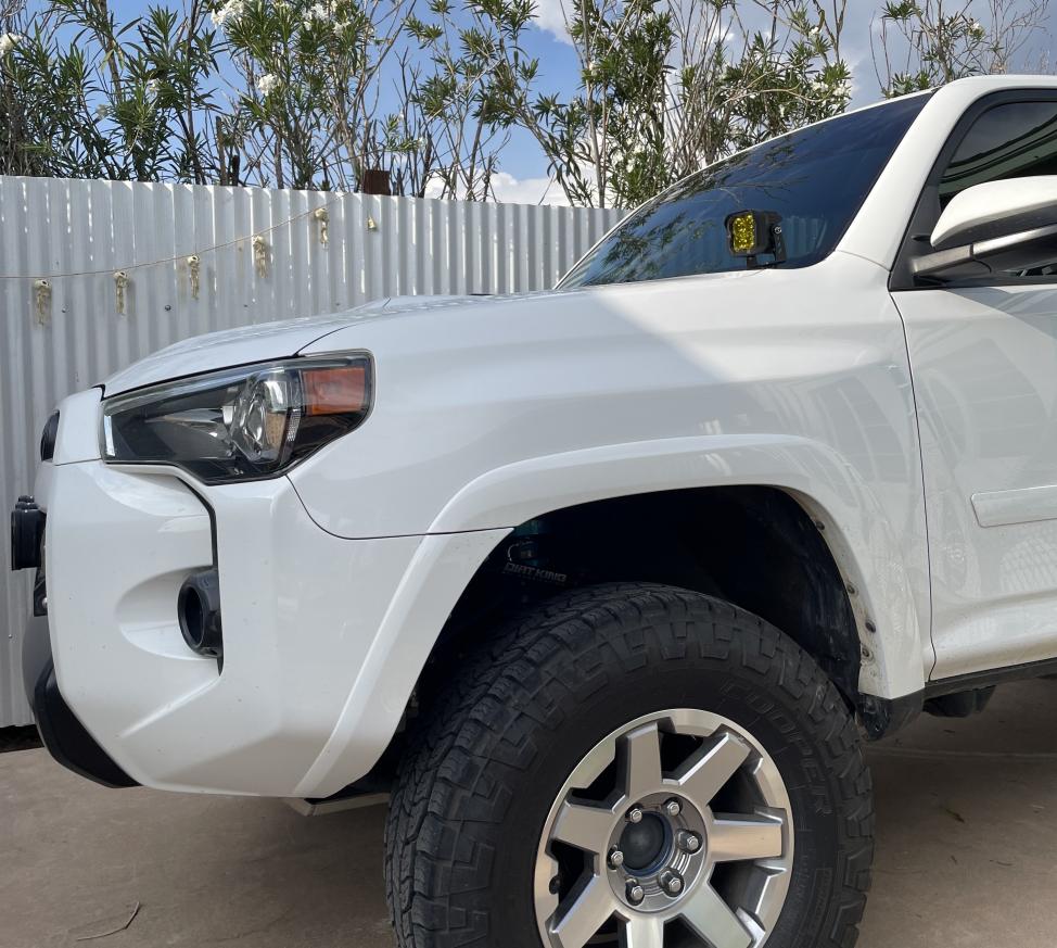

Few more pics. I'll get some night shots tonight. 4runner is in "summer" mode so no roof rack.

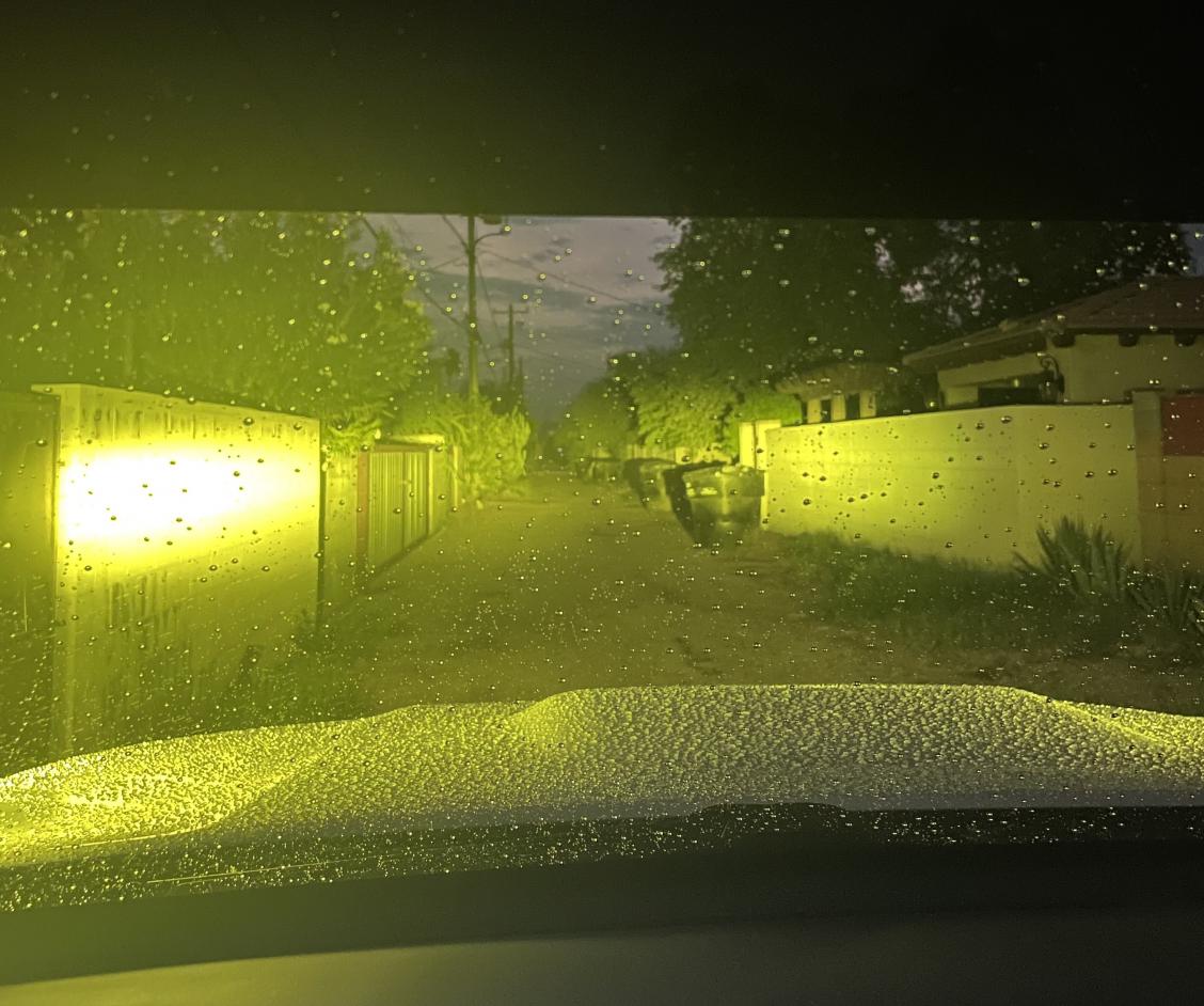

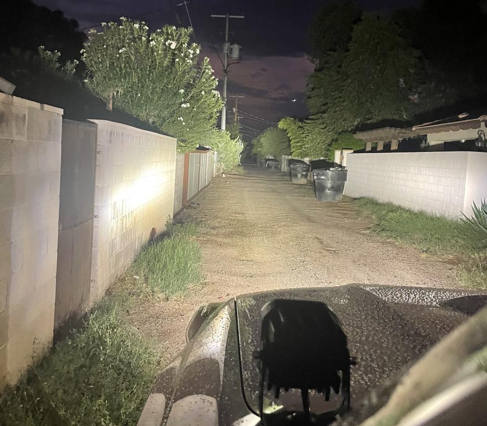

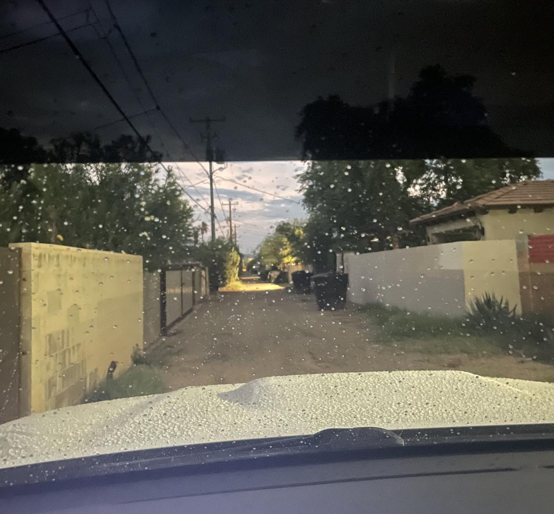

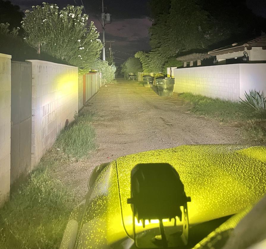

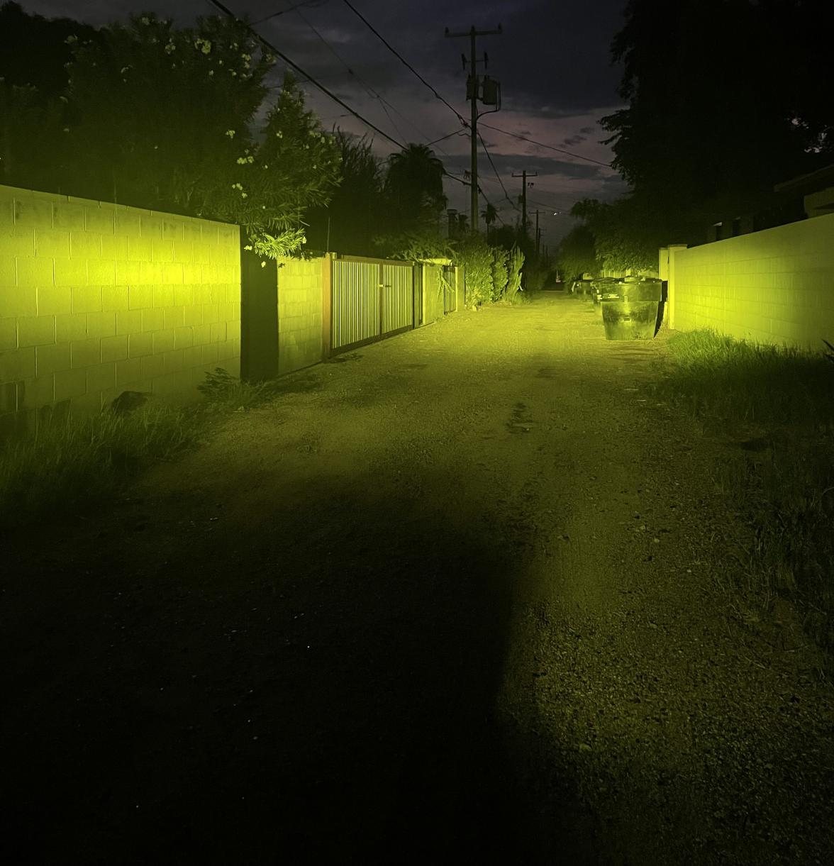

some night shots in the alley. theyre mostly pointed forward, itd be a waste to aim them to the side in the alley lol.
everything off is first, followed by just the Lasfit 3" lights, followed by just the Baja designs, and then both sets on.....
driving lights have pretty great optics. I'll need to get a better shot of them another time in an open area. As expected, the BD lights do wash them out, but the price point difference makes it an apples to steaks comparison really.

this one shows the wide coverage and minimal spill up and down when you look only at the light on the left. Before i angled it straight ahead. Not too bad Lasfit. (driving light optics)
(hood beading courtesy of ShineSupply products btw. 2016, parked outside every day in Phx)

alright update on the harness. Lasfit confirmed, eliminating the backlight on the switch isnt doable with their harness. No big deal, i'll buy a Baja Designs harness. Lasfit sent extra Deutsch pigtails in their box, so i can still use the Deutsch connectors on the lights. Just connect those to the BD harness, run my OEM switch on the BD harness and itll be just like my other switches. Backlight on only when the switch is turned on. Not an issue, just a personal preference.
