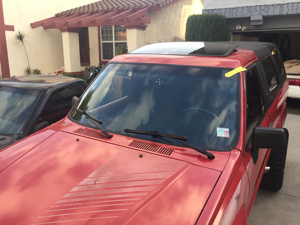

Yeah, I had mine replaced with the universal rubber window trim by a local guy here. He did a decent job its 100x better than the molding and he talked to me about optiins i had. You can go one of two ways basically go for the extra wide stuff and it will look like poop in the top right corners making that almost 90 degree turn or go with the regular width which is what I did. The downside to that is the bottom near the cowling will be about a 1/8 inch exposed. Other than the fact my guy was a bit sloppy with the glue which he admitted it turned out pretty good. Ill see if I can snap some photos tomorrow.
Heres a far pic ill post some closeups tomorrow.
I have no pic of how it looks, yet. However, I favor function and rust-proofing over looks. I load dripping kayaks on the roof so I want the gap to be exposed so it is easy to rinse off / clean, and I do not want hidden gap and a thin interface between body and rubber trim where saltwater would get trapped and cause rust. Therefore, I asked Safelite AutoGlass tech to:
1) Install rubber trim (same size as ^^) - This is NOT to seal (sealing is done by very good urethane adhesive used. .Trim is merely to protect edge of glass from accidental stresses.
2) Before installing Cut-off flap of the trim so it will not cover the gap AND so it will not push against the body (surrounding glass) and push glass away from body while adhesive cures.
My Final Solution as built here.
