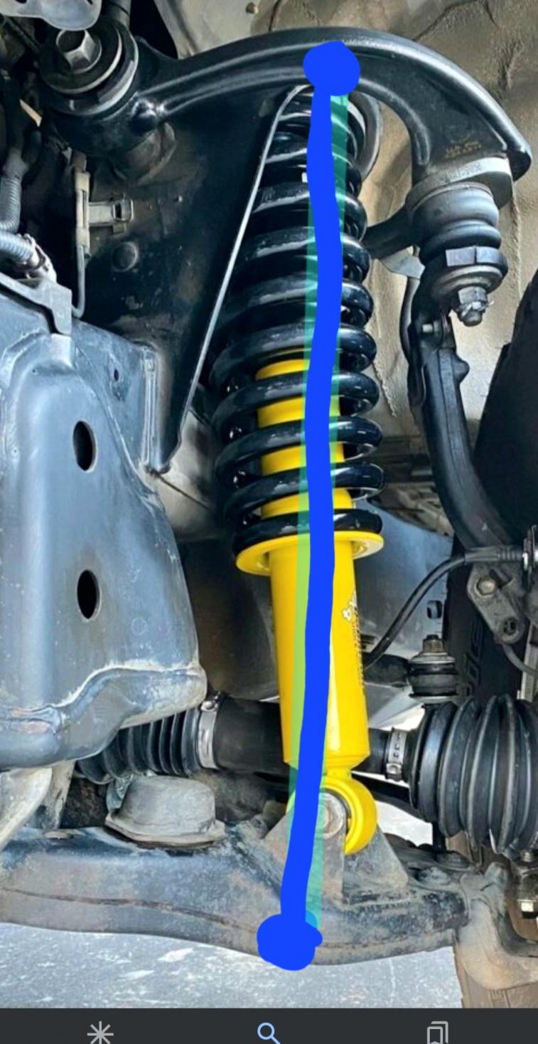

Basic idea, this is approximately how I was wanting to do this. The blue line would be a cable on the leading edge of the control arms.
Goofy or not the ball joints should not be able to separate completely. Of course you could try to find a limit strap in the correct length and you would get the same result, I just have the cable already so no cost.
I don't mind replacing a lbj, but I do mind replacing my family should it fail at speed

That won't do anything to keep the LBJ from separating from the LCA. You're just creating redundancy for the spindle. To secure the LBJ you'd need to weld from it to the LCA.

The problem with what you are suggesting is it has to have enough slack to let the suspension articulate. The upper and lower control arms are different lengths so the distance between the same points upper and lower arms change as the suspension articulates. The lower ball joint only needs about 1/2-3/4 of an inch to come out of the socket and then there is nothing keeping the steering knuckle from going sideways away from the lower control arm.
I have yet to see any lower ball joint failures at speeds above 20 mph. Most of the failures occur at a very sharp turn or after returning to center after turning that far.
There is an inspection procedure in the FSM. All you need is a jack stand, pry bar, and dial indicator to check for play in the lower ball joint. But in all reality, changing your lower ball joints and bolts with oem every 100k is the easiest way to ensure you don’t have a lower ball joint failure. If you do a lot of off-roading or rock crawling then do 50k miles or less.
If you really really don’t want to do that then you can replace the lower ball joints with uniball versions: Toyota Tacoma Lower Uniball LBJ Conversion - Anonymous Fabrication but those will still require replacement/inspection at regular intervals.
Edit: the guaranteed way to eliminate this failure is to buy a vehicle with a different front suspension design that forces the lower ball joint into the cup rather than pull it apart.
